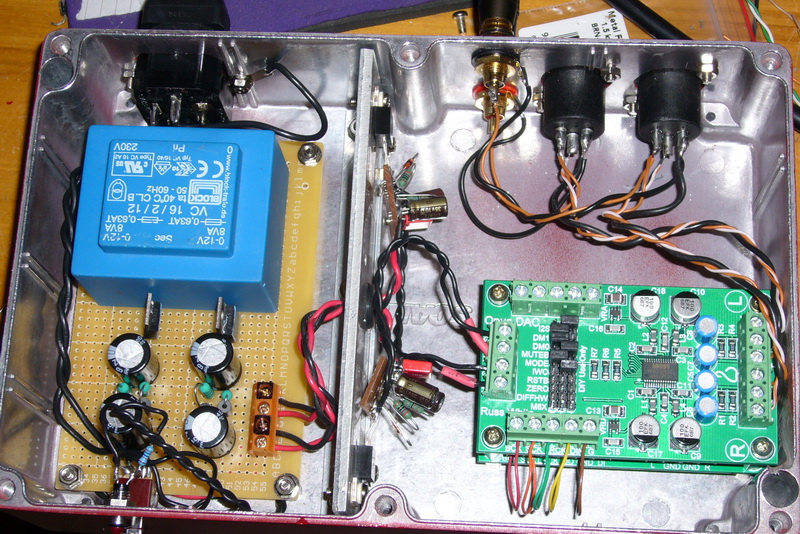

Mr White's "Opus", designing a simple balanced DAC
best to have a mechanical switch between dsd and pcm and then make selection in software. If you are using s/w, have it control the mechanical switch
I'm not exactly sure what you mean by this. There are DSD and PCM headers on the board, so wire both those up, then bring out the existing DSD switch that's on the PCB to say the front panel, or bring out a new switch all together and use that to toggle software? How can software "control" a mechanical switch?
The PCM and DSD lines connect to the same pins in the DAC, so you need some switch such as the OTTO to switch between pcm and dsd. (it is probably OK to have them both pcm and dsd connected all the time provided you make sure you only have one on at any given time. Keep in mind that a source will still be ON even when not playing music)
If you are using the h/w interface, then you will use one switch to toggle the OTTO and another switch to toggle dsd/pcm. If you use s/w then you can program a single switch to do both. A mechanical switch such as a relay (OTTO) can be controlled with s/w and a controller such as Arduino by pulling the control pin in the relay high or low.
really? pin1 is LRCLK for PCM and pin1 is DSDL for DSD. pin22 is unused for PCM and DSDR for DSD. I do see that there is overlap for 2 pins though. Ok, let me think about this some more.
Russ, so the metronome doesn't really play a role with DSD?
with regard to just leaving them connected, either DSD or PCM is selected by the player, so I cannot see how they would both be on at the same time. But, I'm assuming that Russ has tried sending PCM from DSD chip in the Denon, so perhaps a switch is needed?
Otherwise, if I were to use the OTTO I could just hardwire pin22 (DSDR) and then toggle pin1, pin3, *and* the DSD switch with a single OTTO, as there are enough poles on the relay to do this. I'm not sure if I 'd have to remove the DIP switches all together though, or just solder wires underneath... I'm assuming this comes pre-soldered?
I see you plan to use the Denon player. It could be the case that the Denon would turn one off while enabling the other, but not guaranteed. With a switch you will have a more flexible implementation
pin 22 is the OSR pin (for hardware mode) for PCM (OSR controls the DAC's internal oversampling)
