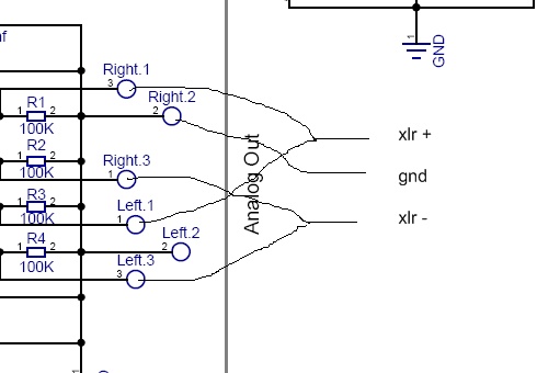

Hi Russ/Brian
I'm still a bit puzzled how to connect the outputs when using it in dual mono configuration. Looking at the data sheet section dual differential setup, should it be like this?
Mono Left, Mode0: connect both Left1 and Right1 to XLR+; Left3 and Right3 to XLR -
Mono Right, Mode1: connect both Left1 and Right3 to XLR+; Left3 and Right1 to XLR -

Hi Culture,
The easiest way to remember the mono wiring is this:
If the DAC is setup for the right channel mono then the right side output terminal will have the voltage output as marked. The left side will have the same signal, just inverse. So the LEFT side terminals are opposite as marked.
When the DAC is setup as a left channel mono then the left is normal, and the right reversed.

culture said:Hi Russ,
Thanks for the quick reply,
What i actually meant is, do I parallel the outputs (see attachment) on each board according to the used mode?
cheers,
c.
Yes. 🙂

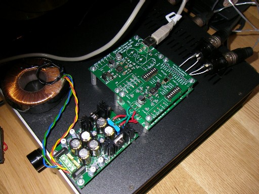

Opus kit received
Just received my Opus kit, with Metronome and USB receiver. Quick delivery. Great quality! Setting it up was easy, and it worked perfectly right away. A great kit for beginners.
The sound was really nasty the first couple of hours, but after a little burn in period it sounds really great. There's no way you can get a better dac at this price.
Picture is from the test bench.
