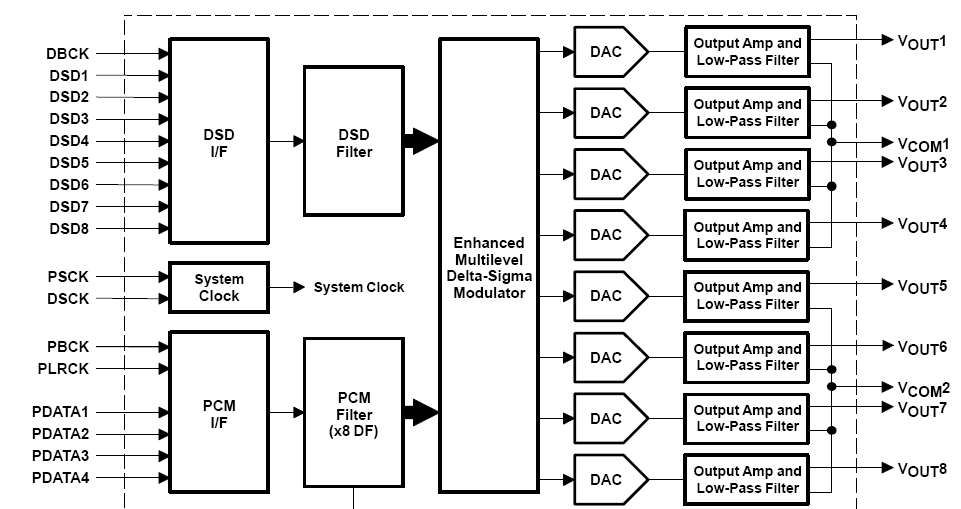

It's much easyer to tap the inside DAC connections after the decoding.
I have a Toshiba SD6980 SACD/DVD-A player. The DAC is a 8 channel Burr Brown (DSD1608) and there I have accesible 4 chanels of stereo PCM data and another 8 of DSD data (from the SACD chip). If I would be interested in sending those signals digitally on my receiver I would need to tap the inputs of that DAC somehow. And the receiver to have 4 (or 8) spdif inputs assignable to individual channels since I don't "know" how to mix those streams in HDMI without a HDMI transmitter (something like the AD9388 from above) or in a I2S mux stream.
PS: My SACD decoder is SAA7893HL from Phillips.
