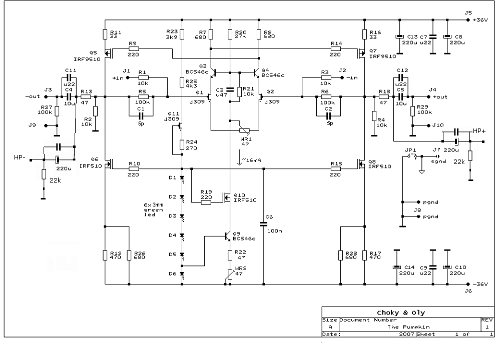

Currently am waiting for the next batch of modules to be available - just a few questions:
1) How can we tell if the next stage (e.g. preamp) can accept common mode DC?
e.g I am going to build the Pumpkin Preamp as discussed in the Passlab section - can you tell from the schematic if it can accept the DC?

A quick look at the pumpkin preamp and I see it has output capacitors, so they should block any common mode DC on the outputs.
It looks to me as if you should be fine to DC couple it to the DAC. In fact I would not be affraid to do so at all.
To be 100% sure though you might want to ask the designer.
