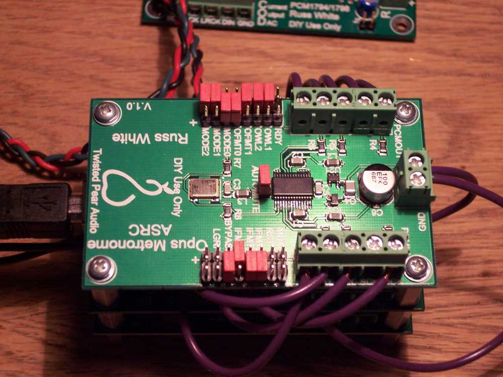

Notice that unless you disable the on-board clock, SCK(the master clock) is ALWAYS an output on the Metronome for both PCM IN and PCM OUT. It is there to allow for use of both master and slave modes on input and output. You can disable the XO on board to allow the master clock to be driven externally (pull pin one of the XO to GND), but this is not a standard configuration.
You will almost never want to connect the SCK from your PCM source to SCK on the PCM input side!!! You will want to use it on the output side of course.
Here is an image of a correctly configured metronome configured for 24bit I2S 192khz.
Please Please Please notice that some of the pin headers are not jumped intentionally. Just jump the one I have jumped. The other pin headers are there to allow people who wish to use micro-controllers to configure and monitor the device. Only use them if you have read the data sheet and know what you are doing.
Cheers!
Russ

Fiddled a bit more with the settings today...
(spent some time reading those darn datasheets too)
So First the receiver...
AIF_MS : 1 : MCLK, LRCLK and BCLK have to be generated from the S/PDIF input
TXSRC : 1 : sets the source of the S/PDIF transmitter to the reconstructed S/PDIF input data
(not important now, but I want to do some measurements later)
AIFCONF1, AIFCONF0 : 0,0 : 16 bit (same as source, CD-player)
The other possible setting : 0,1 : is pretty useless if I interpreted the note in the datasheet correctly:
Datasheet WM8804 page 51 note 2:
"In 24 bit I²S mode, any data width of 24 bits or less is supported provided that LRCLK is high for a minimum of 24 BCLK cycles
and low for a minimum of 24 BCLK cycles (48 BCLK cycles).
If exactly 32 BCLK cycles occur in one LRCLK (16 high, 16 low) the chip will auto detect and operate in 16 bit data word length mode.
So, 16/44.1 I²S will be the input for the metronome...
Metronome jumpers:
(have a look at the picture please, I might have overlooked something)
Output port should be master, and I'd like it to be 256fs:
Mode2 : 0
Mode1 : 1
Mode0 : 1
Input port data format is 16-bit I²S (this seems to be okay for the 24-bit I²S input setting

So, did I miss any other options I'd want to try???
This setting sounds great imho, I think it (24-bit/256fs) sounds a tad more subtle than the 16-bit/128fs I liked yesterday.
Will listen to it for a while, then give the 24-bit/128fs-setting another go.
Leave RESET,RDY,MUTE open on the metronome, also make absolutely sure you do not use the SCK out from the receiver into the metronome.
Setting those will screw up the power on reset and automute functions of the metronome.
Look at the pic I posted here:
http://www.diyaudio.com/forums/showthread.php?postid=1363864#post1363864
The most flexible way to setup the DAC/REC/Metronome is 24bit I2S, if you have a 16bit source the low bits are simply tossed out, or the device falls back to 16bit.
Cheers!
Russ
Dougie085 said:Sorry if this is a stupid question as I'm just a bit confused but what exactly does the Metronome do? Or what is it for?
It is an asynchronous re-clocker that is meant to provide a clean low jitter clock to DAC module as well as strongly attenuate any jitter from the source PCM. It also allows the DAC to operate at a higher sample rate where they typically perform better.
Cheers!
Russ
Dougie085 said:Ohhhhh....so it is something I may want
Do you think it would help USB use a lot as far as jitter and what not?
Yes, it does clean up the USB input very very nicely.
While the PCM output of the USB module on its its own is certainly not bad, it is better with the metronome. The cool thing is that the metronome can be operated off the VBUS. No additional power supply required.
Cheers!
Russ
