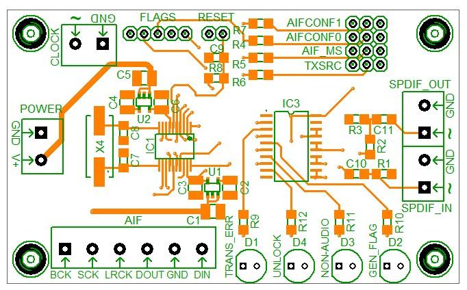

Sneak Preview
Here is the layout for the WM8804, just to give you an idea.
The four bicolor LEDs show the status of the SPDIF signal. The GEN_FLAG would typically be run up to the front to indicate a good lock and valid audio signal.
The PCB can also be used simply to de-jitter SPDIF, in which case you would use both the SPDIF input and output.
You could also take digital audio audio input from some other source as I2S or RJ (any of the supported formats) and output SPDIF.
Of course most often it will simply input SPDIF and output I2S on the AIF terminals. 🙂
