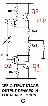

I'm on my phone now can't really see, doesn't Q1 Q2 need resistor from base to collector?

Yes, the base stopper resistors from driver collector to output transistor base are good to prevent oscillation. Use 10 to 22.
Oh, this silly CFP thing in post 19 still doesn't have emitter resistors. Go back to something normal like eliott P3a but drive with an op amp, then resistor R6, then the two diode stack, then the drivers pushing outputs like darlingtons except have 100 ohm resistors from output base to the rails to bleed off the base charge while shutting off.

BTW, the illustration I posted in #19 was just that - an illustration, not a complete schematic, for the purpose of clarity and an answer to the query; "....R14-17 what are they for?".
Really all these op amp driven CFP output schematics are just too weird.
commercial amps with op amp inputs and BJT transistors have emitters coupled to the speaker through emitter resistors.

Bruno, that 4 transistor config allows the output voltage to swing rail to rail.
the 470 ohm feeds back the output to the emitter providing a gain of about 8 on each driver

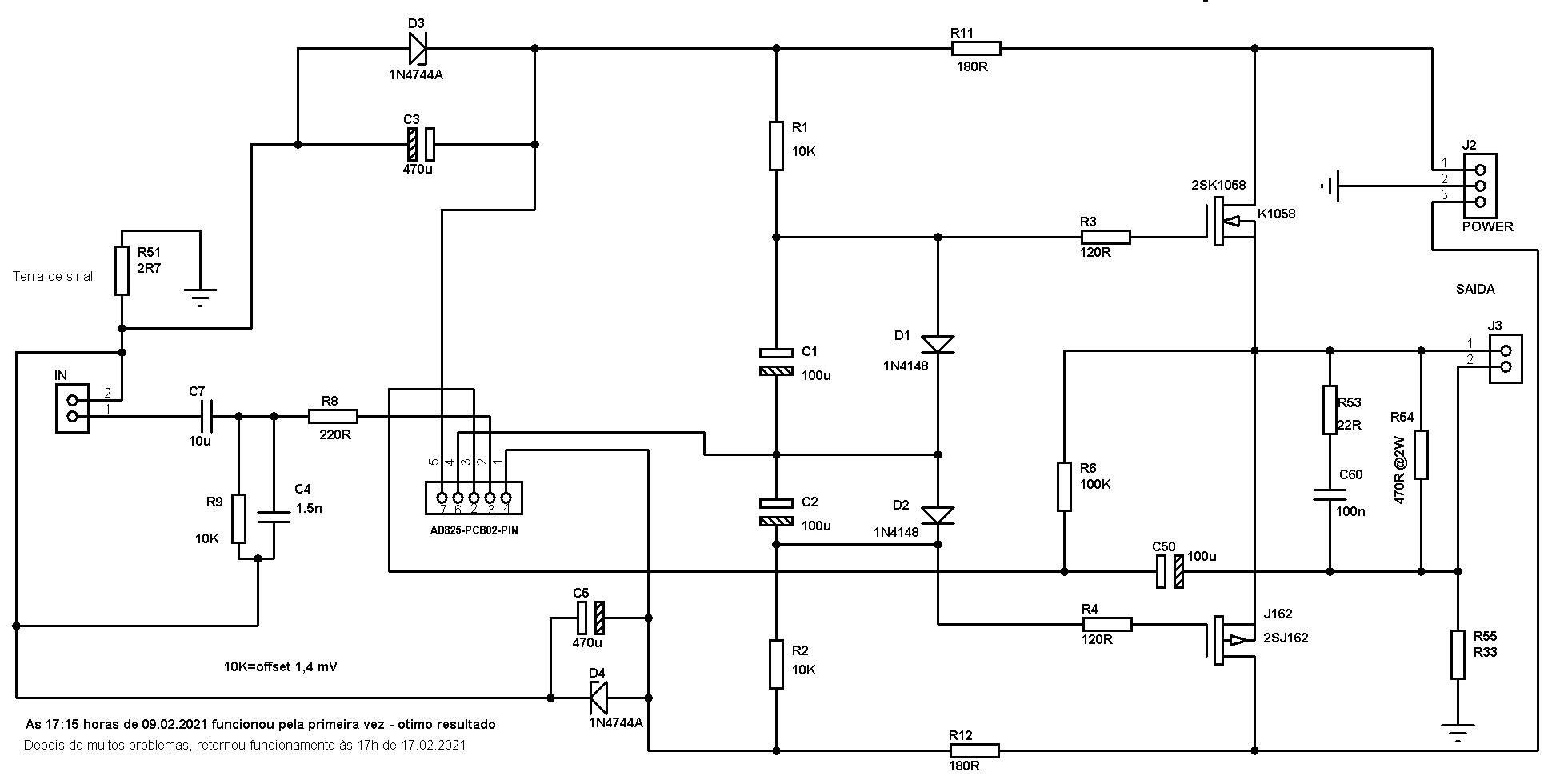

Hey everyone! If you wanted to change offset to close to zero, could you connect a trimpot from anode D1 with cathode in D2, also connecting R3 and R4 same trimpot? I have no knowledge of simulators. Can you help me please?
Something like this is more appropriate as a power amp:
PSU was made out of 200VA transformer (2x15V AC => +/-20V DC, single 10A diode bridge and 10,000uF/25V per rail is OK).
AD823 is supplied through 16V/1W Zener diodes and since it's a rail-to-rail OpAmp it will produce enough voltage swing to fully use the output stage made out of lateral mosfets source follower complementary pair. You can expect about 13W at 8 Ohms per channel or about 20W at 4 Ohms. Output stage has higher voltage power supply due to Vgs losses.
AD823 has JFET input and very low and stable DC offset so you can put volume pot at the input. Nothing to adjust - D1/D2 will reliably bias the output stage to about 150mA and the feedback loop will take care about DC offset.
Thermal stability is ensured through lateral mosfets' characteristics.
My build didn't need any external freq. compensation although it was used with 4-Ohm loudspeakers (medium to high reactive).
Similar results can be achieved with LM1875 chip but this design sounds noticeably better.

Hi augustoriodosul,
there's no need to adjust DC offset - AD823 will keep it on uV level through feedback loop.

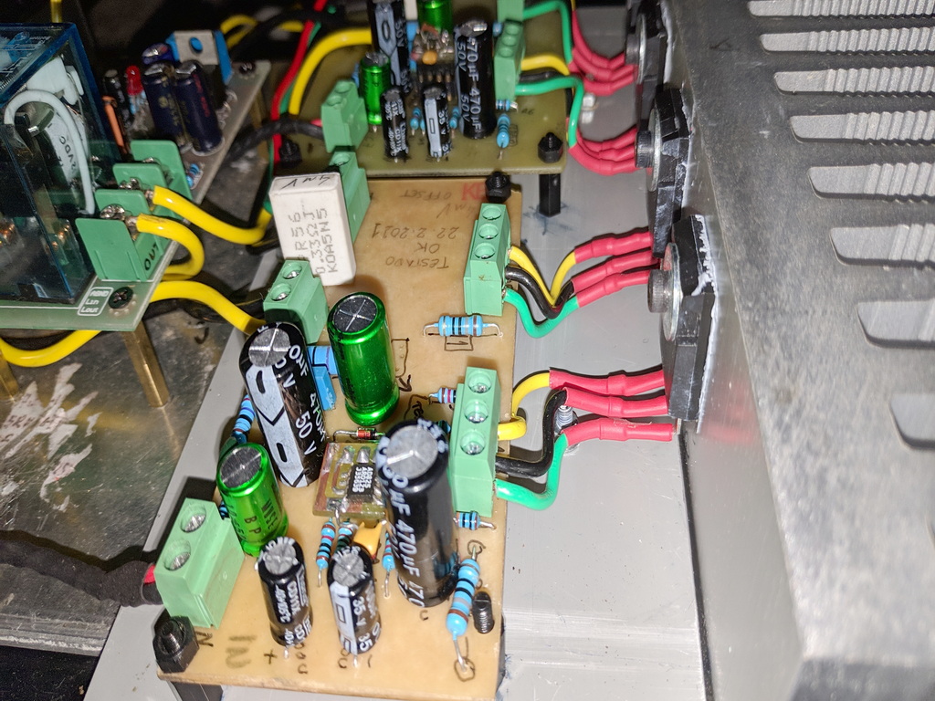

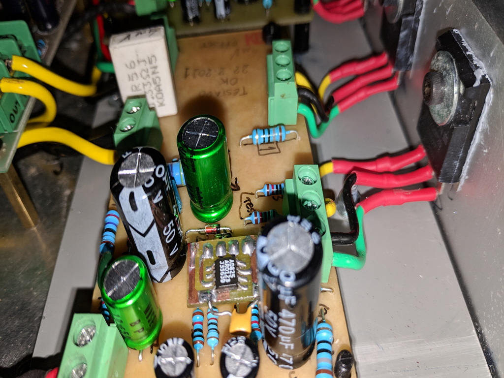

Hello Juma. Yes, you had stated that. But I used an AD825, and changed it to drive current output, with a .33R sense resistor. A 176 mV offset appeared, which decreases to 16 mV, if a 15K to R9 is used. But I think that changed the timbre of the machine, so I thought about adjusting it by trimmer. I appreciate if you can give me any indication. Best thanks.
AD825+Lfet in test
Completed Juma amp #5, adapted for current mode or, as some call it, transconductance. I do not master assessment techniques in the scope but their response is flat from 1Hz to 500 KHz. Up to 5 MHz but with 180 degree phase rotation. Your job sounds very detailed, it must be AD825, fast. Powered by 4744 zener with 180R limiters. Voltage of 19VDC, Lfet Exicon EX10N20 and EX10P20, I am listening in pair with Vifa PL11WH09, free but cut at 90Hz (Linkwitz 48dB). Brazilian band UAKTI sounds very interesting. Thanks for everyone's information.
