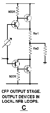

Yes, the base stopper resistors from driver collector to output transistor base are good to prevent oscillation. Use 10 to 22.
Oh, this silly CFP thing in post 19 still doesn't have emitter resistors. Go back to something normal like eliott P3a but drive with an op amp, then resistor R6, then the two diode stack, then the drivers pushing outputs like darlingtons except have 100 ohm resistors from output base to the rails to bleed off the base charge while shutting off.

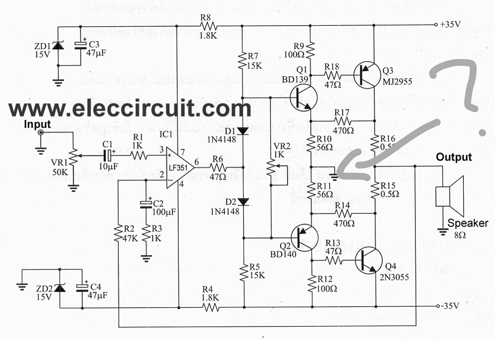

Well, mitsubishi 5220 bond wire limit 50 ma. PS limit +-22.5
Dip package limit 625 mw. thermal coefficient 6.25 mw/deg C
So analyze the maximum current you will can get out of the op amp using that thermal limit. The transistor end of the 47 ohm resistor is at 1.2 v when you're driving to max amount.
Warning, there is no heat sink for this DIP package. You're not going to get much out. Probably as good drive current wise as a DIP package LM4562. The higher R6 (op amp to diode stack) is the less likely you are to melt your precious 5220's. I'd start at 600 ohms then back off slowly.

BTW, the illustration I posted in #19 was just that - an illustration, not a complete schematic, for the purpose of clarity and an answer to the query; "....R14-17 what are they for?".
Really all these op amp driven CFP output schematics are just too weird.
commercial amps with op amp inputs and BJT transistors have emitters coupled to the speaker through emitter resistors.

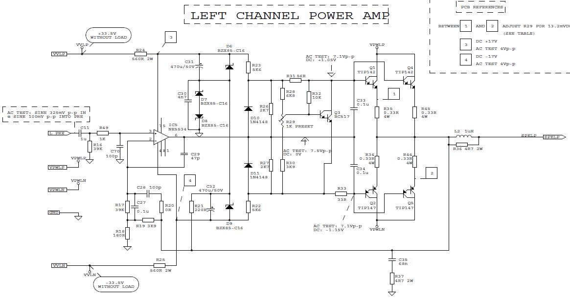

See the commercially successful Peavey PV-4C a 200 W/ch into 4 ohms PA amp. https://www.elektrotanya.com/peavey_pv4c_sch.pdf/download.html
It has a two stage bjt transistor drive after the op amp, and uses a garden variety 4558 as input amp. It has a stack of diodes on the heat sinks as bias spreaders and heat sensors. You don't need to build the jfet-3380 DDT circuit, you don't need to build the VI limiters, the crowbar triac speaker protector is optional but I recommend it.
Your 5520 op amp as an input amp has no advantage over a 4558 because of the higher voltage rating. The output current is limited by the DIP package, since the output is clamped to +-1.2 or 1.8 v by the driver or predriver transistors. Boosting the rail voltage just increases the wattage burned to produce 1.8 v or its opposite, and hence cuts the current available due to the wattage limit of the heat-sinkless package.
So using both predriver and driver transistors like the PV-4C uses the op amp to best advantage.

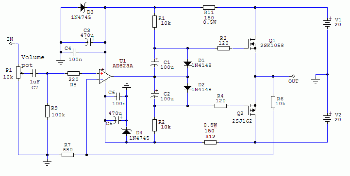

Something like this is more appropriate as a power amp:
PSU was made out of 200VA transformer (2x15V AC => +/-20V DC, single 10A diode bridge and 10,000uF/25V per rail is OK).
AD823 is supplied through 16V/1W Zener diodes and since it's a rail-to-rail OpAmp it will produce enough voltage swing to fully use the output stage made out of lateral mosfets source follower complementary pair. You can expect about 13W at 8 Ohms per channel or about 20W at 4 Ohms. Output stage has higher voltage power supply due to Vgs losses.
AD823 has JFET input and very low and stable DC offset so you can put volume pot at the input. Nothing to adjust - D1/D2 will reliably bias the output stage to about 150mA and the feedback loop will take care about DC offset.
Thermal stability is ensured through lateral mosfets' characteristics.
My build didn't need any external freq. compensation although it was used with 4-Ohm loudspeakers (medium to high reactive).
Similar results can be achieved with LM1875 chip but this design sounds noticeably better.
Hey everyone! If you wanted to change offset to close to zero, could you connect a trimpot from anode D1 with cathode in D2, also connecting R3 and R4 same trimpot? I have no knowledge of simulators. Can you help me please?
Hello Juma. Yes, you had stated that. But I used an AD825, and changed it to drive current output, with a .33R sense resistor. A 176 mV offset appeared, which decreases to 16 mV, if a 15K to R9 is used. But I think that changed the timbre of the machine, so I thought about adjusting it by trimmer. I appreciate if you can give me any indication. Best thanks.
AD825+Lfet in test
Completed Juma amp #5, adapted for current mode or, as some call it, transconductance. I do not master assessment techniques in the scope but their response is flat from 1Hz to 500 KHz. Up to 5 MHz but with 180 degree phase rotation. Your job sounds very detailed, it must be AD825, fast. Powered by 4744 zener with 180R limiters. Voltage of 19VDC, Lfet Exicon EX10N20 and EX10P20, I am listening in pair with Vifa PL11WH09, free but cut at 90Hz (Linkwitz 48dB). Brazilian band UAKTI sounds very interesting. Thanks for everyone's information.
