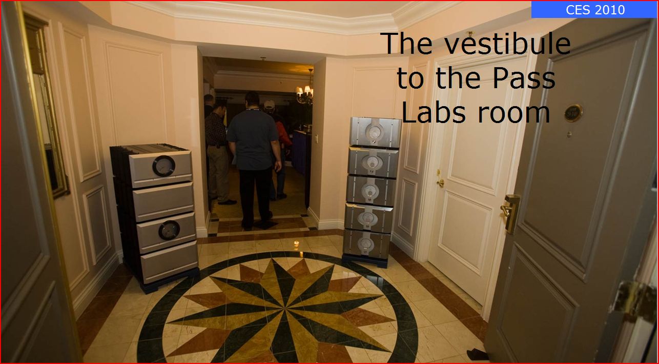

Ou La La , a vestibule and lots of ferns.
How very burlesque.
(what's the Rusky mob doing at piccy 101, i wonder)

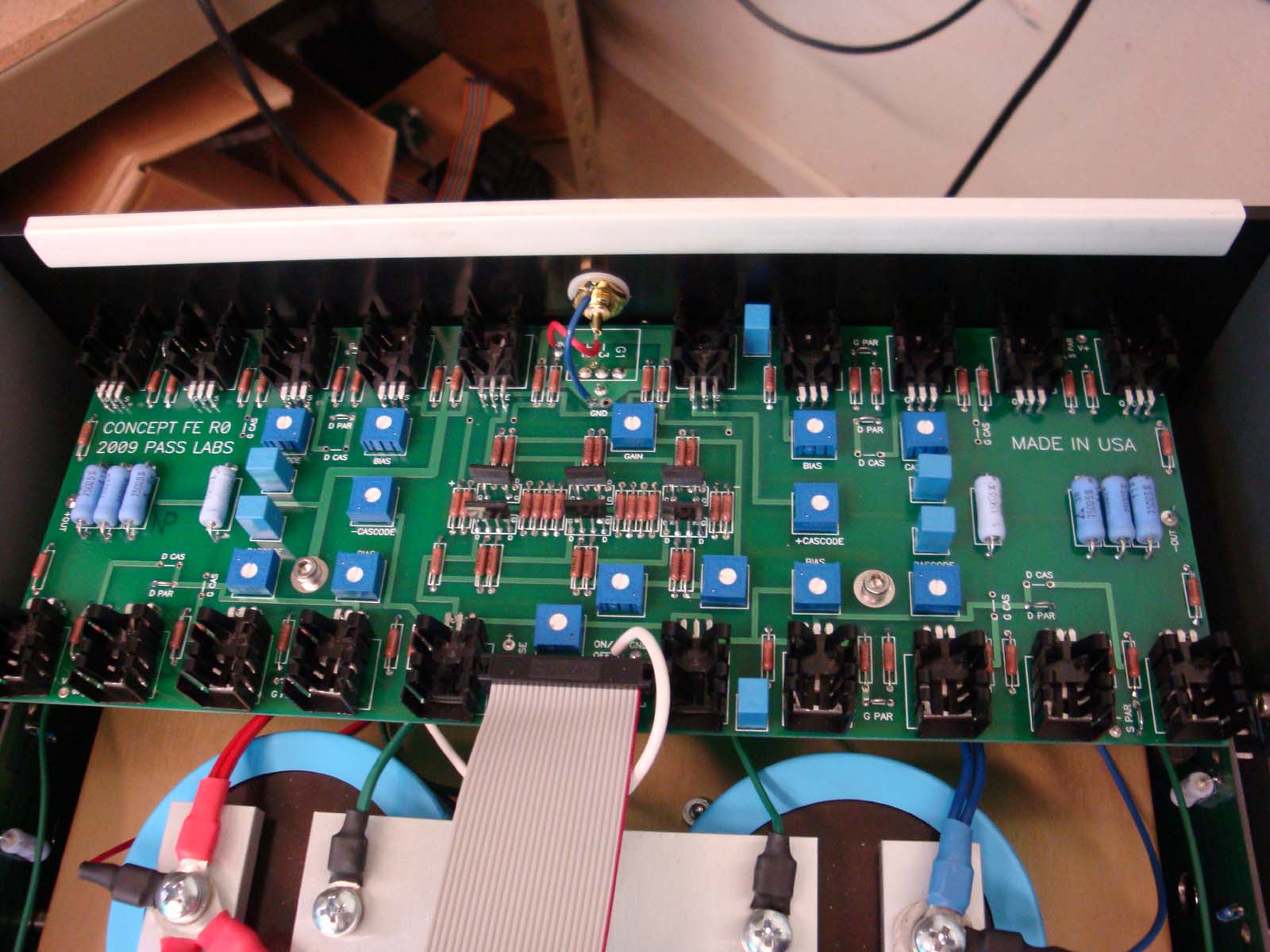

Funny thing is that no one has asked yet about the peculiar main/driver board.
who cares ?
I like welding!
because nobody knows further about the internal topology (see post #21)Funny thing is that no one has asked yet about the peculiar main/driver board.
Fair enough, how many identical heatsinked devices do you see at the input board ? (including the ones you don't actually see)
Are you referring to this?
oh boy - triple 7-legged
that means that serious current is flowing through outer ring of UGS
Papa - where is mine welding cable pic ?
things in triples
Looks like a high power UGS2/3, with ;
- 3 J109/K389 JFETs in parallel for the complementary differential,
- TO220 Toshiba BJT instead of ZTX450/550 cascode devices for the JFET core,
- Cascoded output stages, IRF610/9610 in lieu of ZVN3310/ZVP3310 pairs.
The main chassis appears push/pull, the blind one a SE layout.
Methinks the output stage is also complementary differential (Differential PushPull)...with 10 fets in parallel differential and complementary(UlSy - you'll see)!!! I think you're right the blind one is indeed for more power in Balanced SE Class A...
