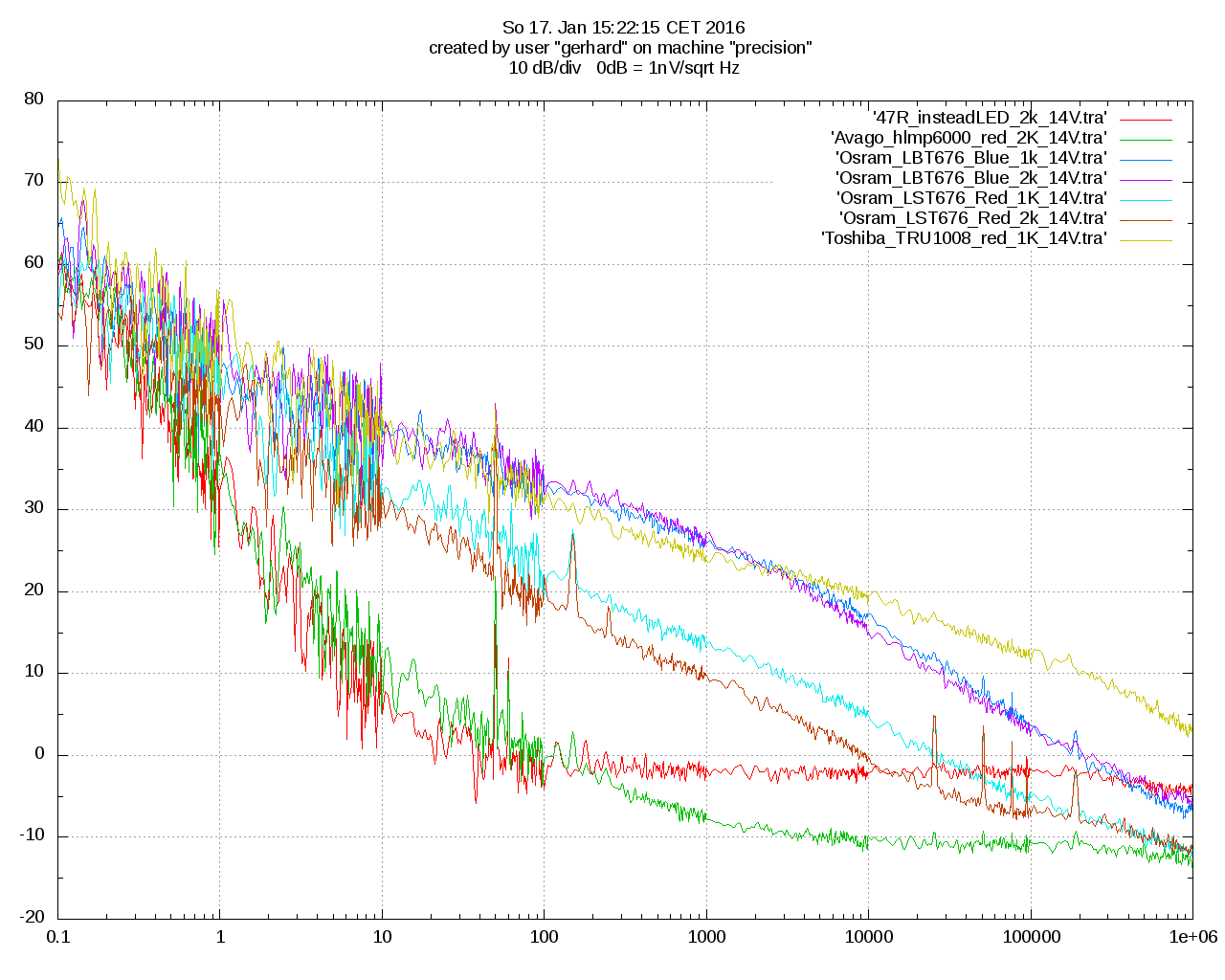

I have made some measurements on LEDs, both noise and temperature behavior.
Bought also Walt's LED type, but not tested yet.
I must first complete my preamp designs, wrt 1/f and some phase noise stuff.
Bias source was a NiMH battery 14V, bias resistor is in the filename of the traces.
The red trace is 47 Ohms instead of a LED. Results in slightly less than 1 nV/rt Hz,
so that seems OK. The battery adds no noise.

Jack, your noise plots are interesting. Do you have an addl reference plot with a 10 ohm R, or a shorted input condition of the preamp?
Thnx.

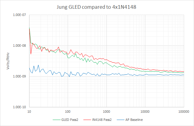

Attached is the chart before the two reference values were "RMS's" with the AP Baseline. The amplifier averages ~1.2nV/RtHz (I am embarrassed to quote such a high figure with Gerhard present 🙂 )

Thnx Jack. Yes, it is very difficult getting significantly lower, and the RSS extractions always left me somewhat queasy. I suspect only a setup like Gerhard's can really hone in on the actual GLED431 noise. My best guess that it is somewhere twixt 1-2nV/Rt-Hz.
An aside here. Has anyone else noticed that ultra-low Z active ckts seem to show lower noise than a bare diode, LED or other types? My gut instinct is that the low Z helps keep spurious noise down.

I think that low Z is a precondition, but probably not the cause itself.
I you look at the brown & light blue traces in the plot above, the trace
with the 1K resistor has more noise than the one with 2K bias. The 1K
has nearly twice the diode current and the diode resistance should
therefore be lower. Maybe there is an optimum at even lower current for
these small LEDs?
For high voltage Zeners in true avalanche mode the slope resistance
is even smaller, but the noise is awful.
I remember that for Schottkies the slope resistance has only half-thermal
noise, like it was at 150 Kelvin or so. I don't remember if that's true
for ordinary diodes or even LEDs in forward direction.
