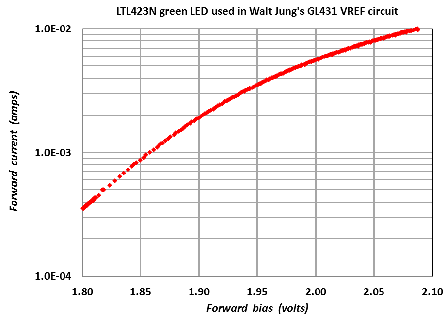

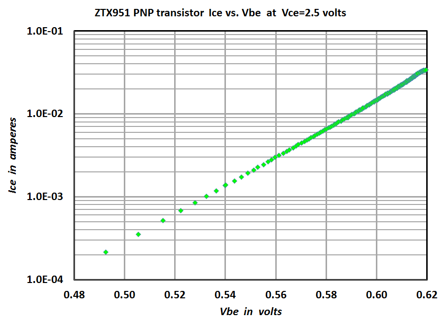

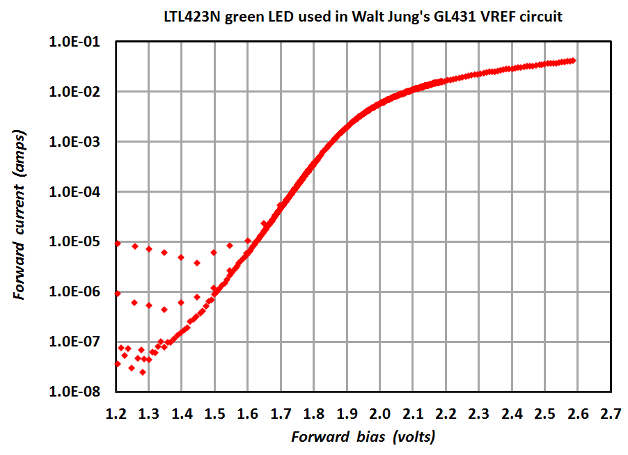

I took some data on the LED and on the PNP bipolar transistor, used in Walt's GLED431 circuit. Maybe it will help someone build a couple of spice models, or accurately represent the circuit in a spreadsheet? In any case, this is the exact LED part number from Lite-On that Walt recommends, and the exact PNP from Zetex/DI that Walt calls for.
The jaggy dots on the left side of the diode plot, are nothing more than my curve tracer doing a lousy job of auto-ranging. Feel free to delete those outliers before you throw the data into a function fitting subroutine!
Raw I-V data is in Excel format, compressed into a .zip archive so the DIYA forum software will accept it.
Thanks for the graph. I choose 5ma for the circuit, but the drift is a problem. LED is extremely sensitive to temperature. Make sure your chassis has good ventilation or this little circuit will drop to 2.4V or 2.3V. This is not good for a regulator as the output voltage varies a lot.

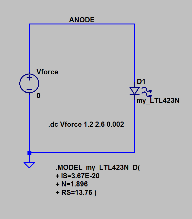

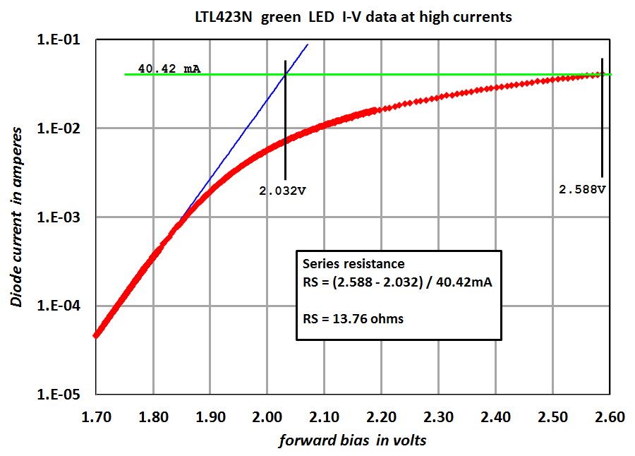

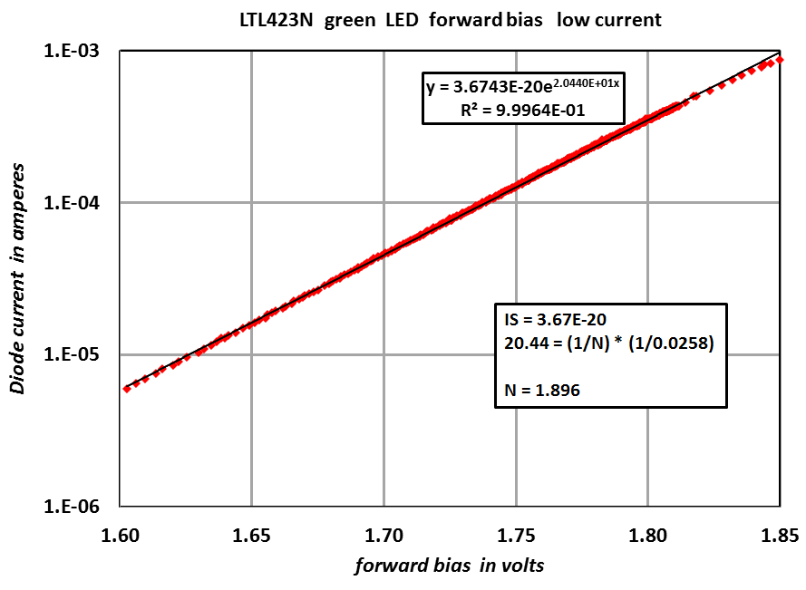

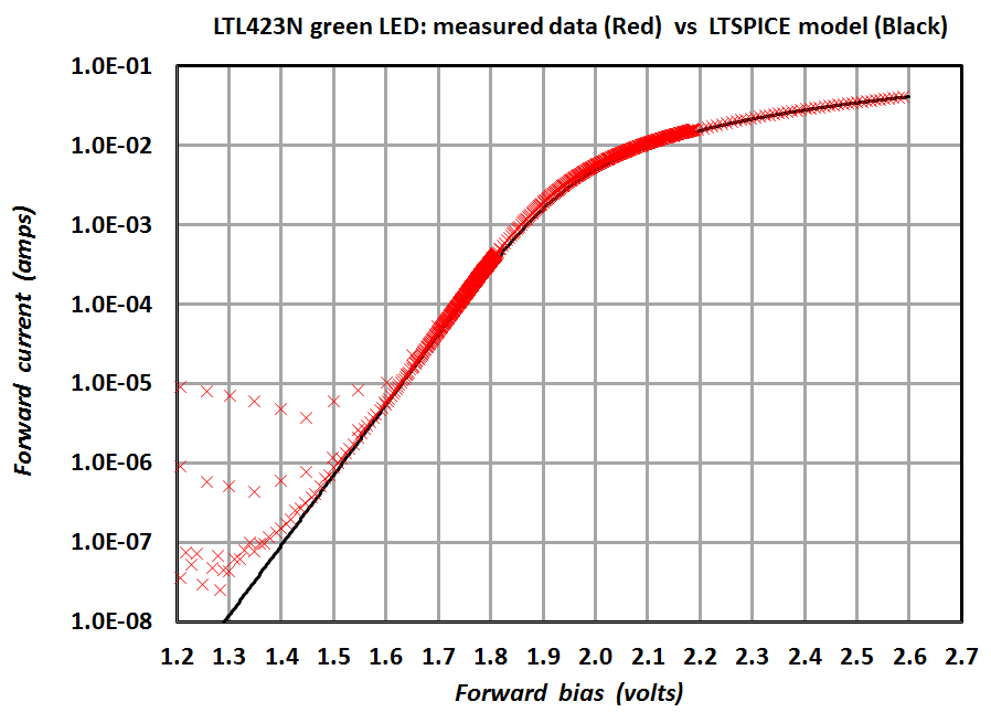

Fitting SPICE model parameters of a diode
I grabbed those Excel tables of data and fit an LTSPICE model to the Current vs Voltage measurements from the green diode. My step-by-step process, and its results, are shown in the images below. In my opinion the fit is pretty good.
_

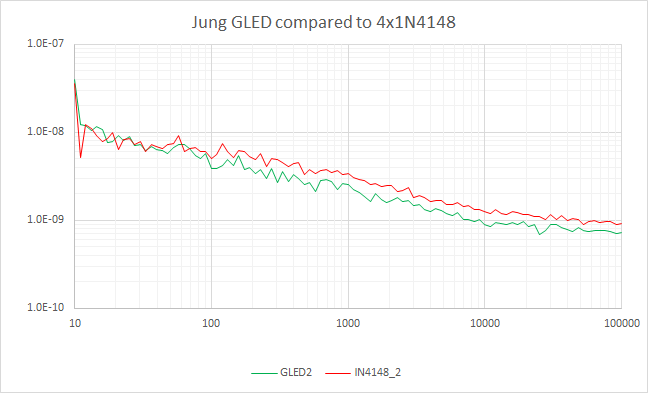

Here's some noise data -- this is cleaned up from that which I published on Sams 60dB Groner's Low noise measurement amp from Linear Audio vol 3 - spare boards?
I tack soldered the LN amplifier inputs to the Voltage References, reduced the leads from the batteries to about 5cm and RMS'd out the noise contribution from the LNA (stacked SSM2019's). I used a green LED HLMP-30 and CCS diode of 4.7mA for each:
Oh my, oh my-oh -- I just looked at the price of those CCS diodes -- 1N5314 -- thankfully I still have 3 left -- price of a good bottle of Cabernet each!
will have to use the DN2540N3 which are TO-92.
