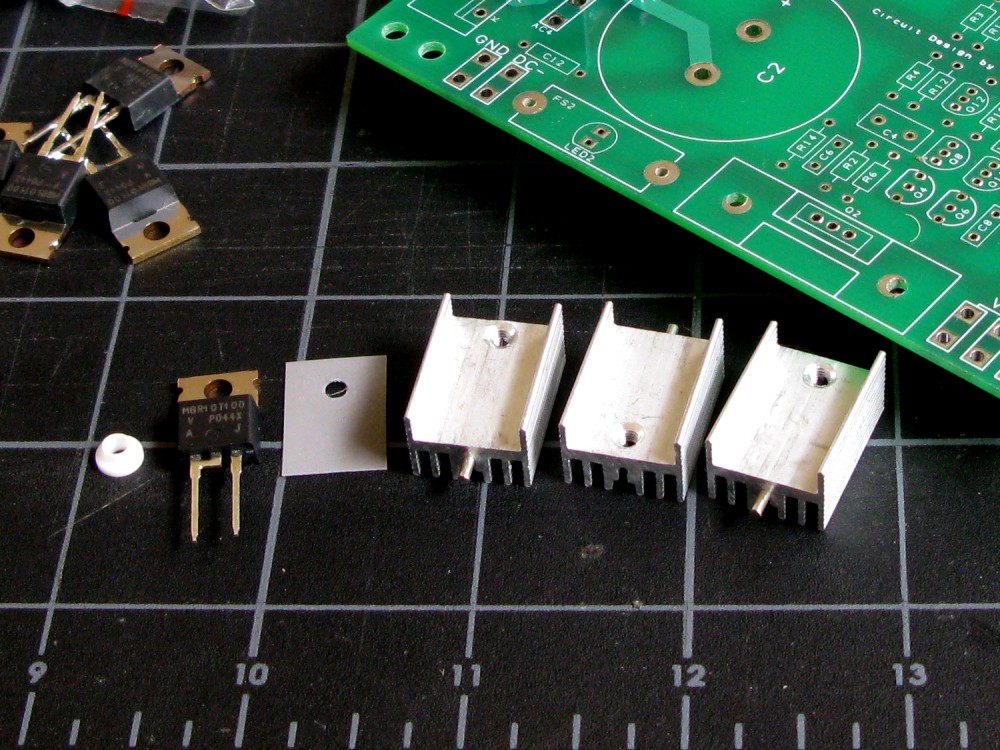

For transformer secondary voltage up to 33V AC, use an MBR10100, or any similar Schottky rectifier diode rated at 100V. The advatages of using Schottky diodes with higher than 100V breakdown voltage diminish rapidly, and they are harder to find.
For transformer voltage over 33VAC (>100V breakdown voltage), use MSR860G or any similar soft-recovery rectifier diode in TO-220AC package.

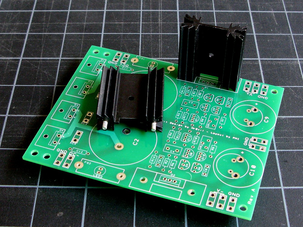

Silicone insulators for the TO-220 components and heatsinks are usually available on Ebay with free shipping, at below normal distributor prices.

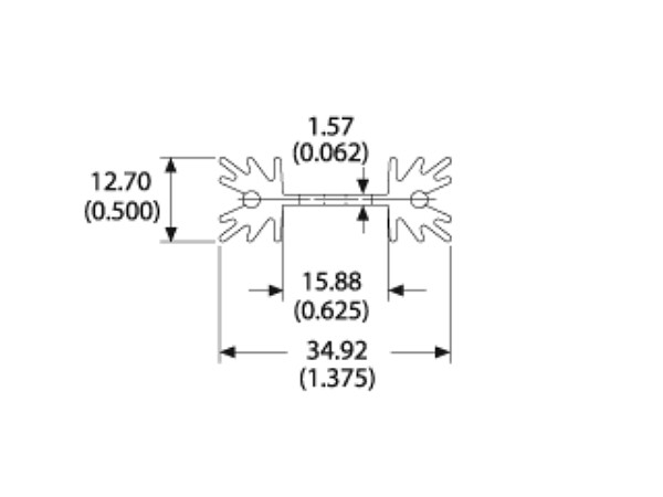

There is nothing unique about the heatsinks, footprints for the two I am using are below, shown for comparison.
