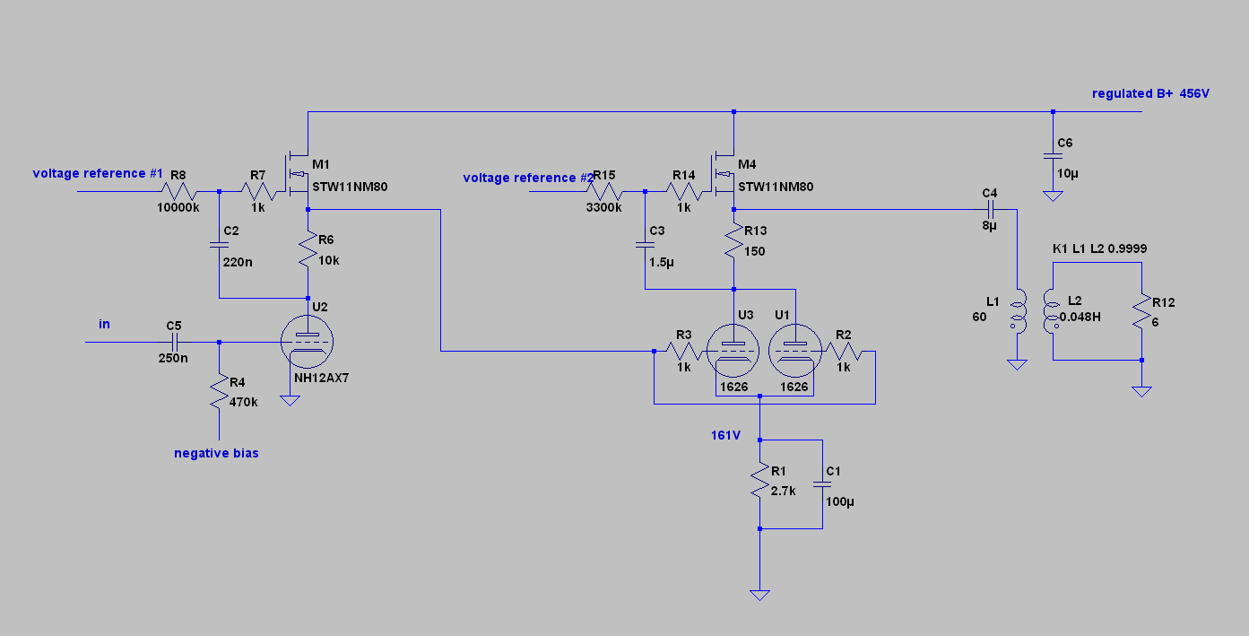

Your basis for comparison seems to be the same toob. Obviously, if you add a ss gyrator on top, providing low dc resistance and high ac impedance drive, distortion comes down, while power consumption roughly doubles.
My basis for comparison is SE output stages running at the same identical idle power consumption. An here the picture is not so clear. The gyrator loaded parafeed topology scores on damping factor, while the usual series feed topology scores on headroom (= power efficiency) and (less) higher harmonics.

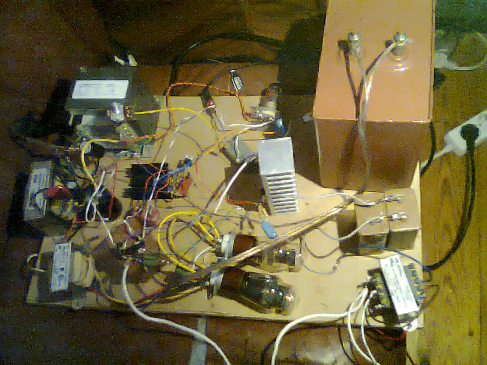

Magz, that thing must really cut out of your house heating bills! I've been designing (dreaming of) an amp that could swing 1200 V differential voltage, for ESL speakers. Scaling up quickly gets very expensive... Incidentally that's why I got a pair of those 100µF / 3kV film caps, one of which is in the pictures in the first post.

I get that you are comparing two different tubes. That's not ok though, to borrow a phrase from you: it's apples and oranges. You can with a couple of sims clearly see for yourself that the gyrator does not produce more odd or higher harmonics within it's power range. It simply doesn't.
The improved bass performance cannot be replicated in series feed (open loop) without great expense, and I would argue, not at any price. Coils inherently perform poorer with falling frequency, cheap or expensive.
Audio design is full of compromises; this topology presents a certain set of drawbacks, and certain set of advantages. If you say that one of the drawbacks is higher/odd harmonics, you must specify that these drawbacks only occur in certain conditions. It is not a universal. This topology has a specified power range, and within it it performs very well.

First, improve response by adding a gyrator on top and going parafeed. Then, improve response by raising the operating point such that idle power matches that of the gyrator loaded stage, while retaining single feed topology, preferrably with a higher primary inductance OPT.
Results will always be very similar. 3rd and higher harmonics (at any given output power) of the series feed topology will be lower though.
Your impression of improved bass response might be due to the higher damping factor of your gyrator stage, but this depends first and foremost on your speakers. Most improve their bass response with higher DF.
As another little contribution to the subject, please have a look at attached diagram.
Once you accept you will use only the voltage amplification characteristics from the tube(s), and allow all other stuff like active plate loads, current drive, ccs and such to be taken care of by SS parts, just be brave and consequent, and wonderful opportunities open up.
~3.3W output, <1% THD with classic SE distortion spectrum, single stage, damping factor ~8. OPT can be some mains toroidal.
Yes, a small bit of positive feedback, to boost input sensitivity a little.
Curiously, it appears to raise H2 just a tiny bit, while lowering H3 and higher harmonics.

...~3.3W output, <1% THD with classic SE distortion spectrum, single stage, damping factor ~8. ...
Does a mu-follower count as a single stage circuit? Doesn't the signal pass through two active devices (voltage gain from tube, current gain from the cathode/source follower), making it a two stage circuit?
Anyway, I have simulated similar circuits (mu-follower straight to OPT via parafeed connection) myself in SPICE and found that the simulations looked good, but I've never built one since I was unsure whether the real-world performance would mirror the simulation. Has anyone tested such circuits? If so, how is the performance?
