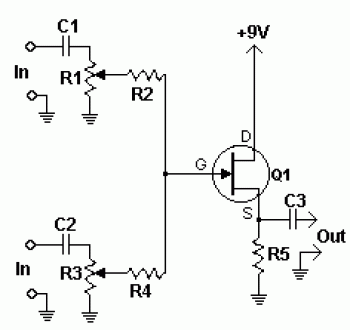

I just wanted to experiment with the locally available MPF102 jfet to experience the jfet sound and simplify the setup

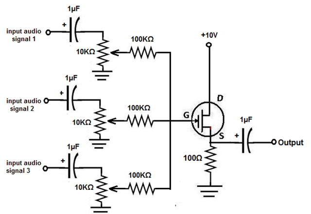

The problem with JFETs is the unpredictability of Idss, which makes a circuit without a source resistor, like the second one you posted, a crap shoot unless you carefully select parts with, in this case Idss= (18V/2)/2.7k ~= 3 to 4 mA. With the Idss = 2 to 20 mA spec, the odds of getting suitable parts are about 5.5%. The source resistor in the first circuit reduces the range of behaviors of the circuit with different parts, but a bit more complicated circuit could make the circuit fairly predictable. You could change R1 to compensate for whatever Idss you get, but at 20mA, your preamp is going to waste a lot of heat/battery and you have to hand select parts; probably have to buy a lot of spares. For a hobby, this is fine, but you can see why JFETs are not a popular strategy for larger manufacturers and therefore why semiconductor manufacturers are abandoning signal JFETs.
Yesterday, I picked up all the parts to make three sets of the second image. I will grab some 1meg, 270ohm and 22n today too so that I can play with either circuit. I would appreciate any recommendations to improve either circuit
Thank you. Where would I find the values for image one? Image two states 10v for power. Would that work with 9v? Can the MPF102 be used in this circuit?
