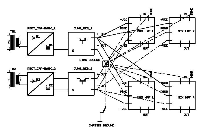

Hello,
after a long time I finally managed to bring my active x-over project closer to conclusion.
It is based on the MOX boards from the first group buy and it uses a pair of ALW boards for the Jung super regulator.
The supply is taken from a dual 15V 100VA toroid, each secondary is rectified with Fairchild Stealth diodes, smoothed with 4700 uF / 40V Siemens Sikorel caps and feeds a super-regulator.
Being the secondaries dual the supplies are floating and need to be referenced to each other.
Looking at ALW's guide I see that the recommended wiring for multiple loads is like this:
