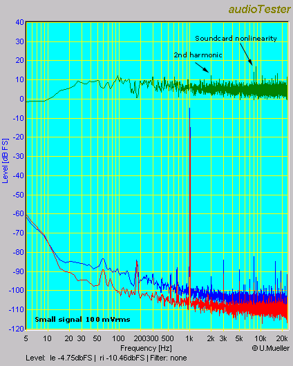

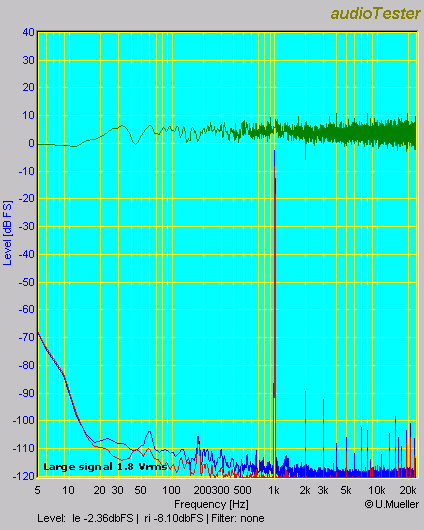

Some distortion plots for the MOX board. This is relevant to the opamp too--since these graphs represents the signal passing all the way through (input buffer, high pass filter, output buffer) the opamp distortion will be even lower.
The problem is that the distortion is really too low for me to measure. I've plotted
Loop back - red trace
MOX - blue trace
MOX - residual - green trace
The only distortion even measurable is in the small signal measurement, and appears to be 2nd harmonic at least -88dB down (0.004%).

Here is the measurement at 1.8 Vrms. Even though no distortion is even visible once the residual is subtracted, we can conclude just from inspection that the 2nd harmonic must be at least -87dB down, the 3rd -90dB, the 4th -106dB, the 5th -104dB (and probably much lower). That means the overall distortion is no higher than 0.0055% at 1.8Vrms, and is very likely considerably lower.
I've posted large versions of both graphs if others would like to take a closer look.
