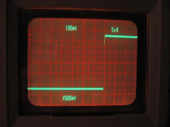

2SK389 'V' group have arrived!
Yes! I could find no evidence online of 2sk389 ever being faked, but I wanted to take no chances. I measured several samples finding
VGS matching: < 1 mV
DC offset at 15V in opamp: < 1 mV*
Square wave response: good**
*Over a voltage range of 5-30V the offset is within 10mV. If you desire different rails and 0V offset, just trim appropriately.
**this is NOT a small signal measurement, the square wave is 4Vpp!
I am also happy to report that the OPA boards have shipped (to me, orders will go out when the MOX arrive). I have no updated estimate on the MOX boards, so don't count on them coming early. 😉
