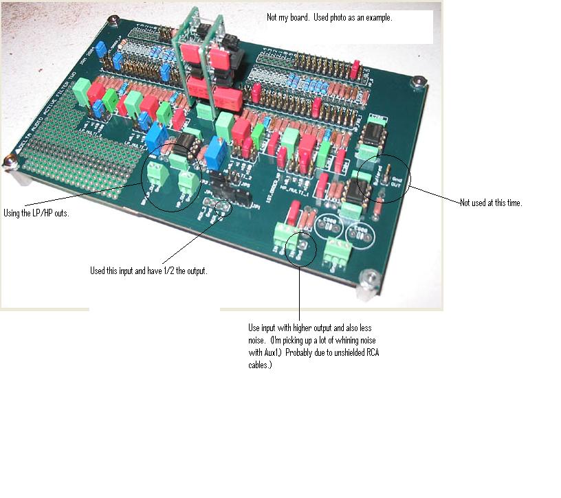

Does anyone know why I am not able to adjust the gain on the MOX II multi-turn pots? Not one makes a change on the levels.
-Tried input thru aux1 and buffered input. No change.
-I'm not using the buffered outs.
-Using 10w single-ended on the tweeter and 65 watt a/b gain clone on woofer.
Maybe I'm not understand what "gain" is in respect to crossovers? Is it a bias adjustment? Is it possible the the output buffers are blown? The MOX does function.
Any suggestion would be helpful.
Thanks,
Vince

Of course, if you don't use the output buffer the attenuator is not in the circuit. You must use IC3 and take your output from BP/LP Out and HP Out. The buffered out near the input and IC1 is fixed.
Gain is what you'd expect, although in this case you only get attenuation at the end of the filter chain.
If you use 10K for R802 and R902 you will only have a maximum of 10 dB attenuation and won't be able to turn the signal off completely. If you leave R802 and R902 open nothing will happen when you adjust the pot. If you want more attenuation, reduce them to as little as 1K

No need to reduce the value of the pots. If you use 10K for R802 and R902 you'll have 10.8 dB attenuation available. As Andrew pointed out, you won't often need more than that unless there are extreme mismatches in the driver sensitivities and/or amplifier gain. The idea of this arrangement is to allow the most precision of adjustment, not full range 0 to max adjustment.
Before changing anything, let's focus on making sure that you are connected properly so that you CAN adjust the gain. From where are you taking your output? The pads near IC3? A 10 db will sound like half volume or so. Are you sure that there is NO change?
Use a tone generator to feed a known signal into the board and measure the output. you can use a signal somewhere around your crossover point. Your DMM may not have flat response that high, so isn't good for accurately setting gains. We're just trying to verify operation. Adjust the associated pot and verify that the output voltage changes.
Which buffered output were you referring to in post 1? The two filtered outputs are buffered, and there is a full range buffered output.
Here is an example photo of where the connections are made on the boards.
I'm using the outs near IC3. I have tried both aux1 in and + Gnd input near power input.
I have other ICs: NE5532, OP37 and OP2314. I can try different configs, if it will help. I think I used the OP2314 on the Hi-pass and NE5532 on the low-pass.
Also, to be more clear, I brought up the hi-pass pot and brought down low-pass. The hi-pass seemed a little brighter, but not much better. Maybe I am expecting more of a noticable change in gain that is just not available?
When you use Aux1 input do you pull JP1?
A photo of YOUR board may help, but first do the measurements.

Yes, definitely do pull out JP1.
With the buffer, got better results with JP1>JP2>JP4>JP3*1. JP5 goes to HP out.

The gain difference between the two inputs is that you probably have the input buffer set up with gain. Equal values for R1 and R2 will result in a voltage gain of 2.
When using Aux1 input try grounding In+ to see if that gets rid of the noise.

Yes, leave the HP running wide open and attenuate the signal to the low end. You'll need to reduce R802 and R902 to 1K to get there. With 25K pots you will have a little attenuation in reserve.
You can reduce the gain of the gainclone. The chip is stable down to gain of 10 (20 db). Changing the feedback network resistors to 10K and 1K will give you 20.8 dB gain, reducing the input attenuation requirement. Of course this might change the character of the amp.

Got Attenuation!
Just verified that there is attenuation. Almost 10db. I just didn't understand that it was a "fine adjustment". Now I get it! 😉
Best of all, now the left and right are balanced when connected to the rest of the system.
