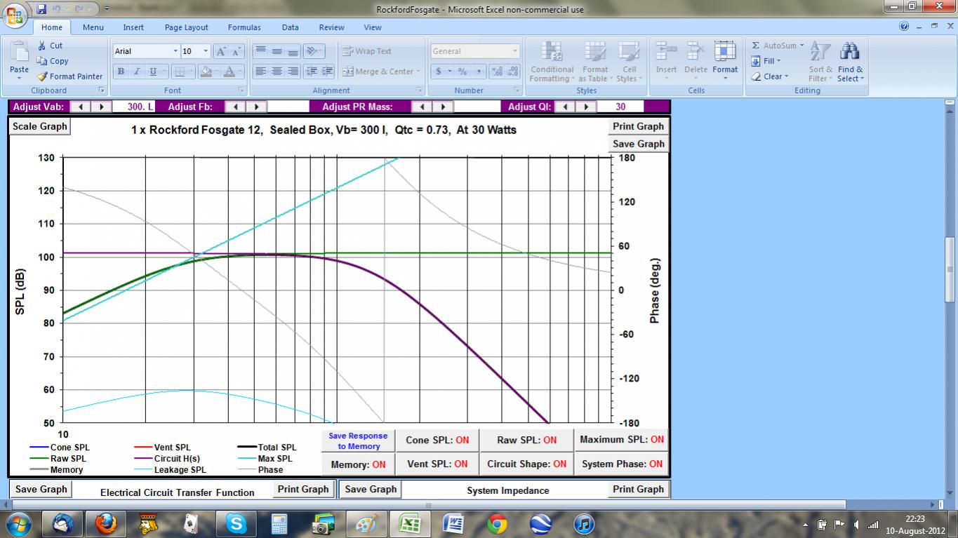

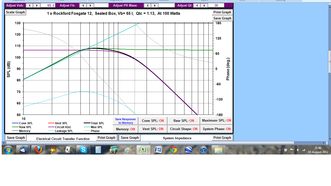

I'll run some numbers for you, but at a guess any small stereo amp will do the job and another guess, 2 separate boxes of about 65 litres each heavily stuffed
65 litres will give you a hump in response and good power handling.
95 litres is better and will go louder with less power, a pair of these will rock the building , 95 litres will give much better SQ providing the drivers can delivers anything other than "DoofDoof" and stuffing with fibreglass will lower Fc and the more important F10 quite a bit.
Now if i had a pair of those I'd be getting some 15 or 18 inch Sonotube and putting a 300 litre tubemonster in each corner
Sub base is possible, I modelled these at 8mm X-Max which is 6.3mm plus 15%.
30 watts will overdrive these at 30 watts but the F10 is lower than 20hz.
So any box size between 65 litres and 200 litres stuffed with fibreglass. 300 has great depth but poor power handling.
2400mm of 14 inch Sonotube has an internal volume of 242 litres
1800mm of 14inch Sonotube has an internal volume of 181 litres ( all these figures are in the Sonotube website BTW
