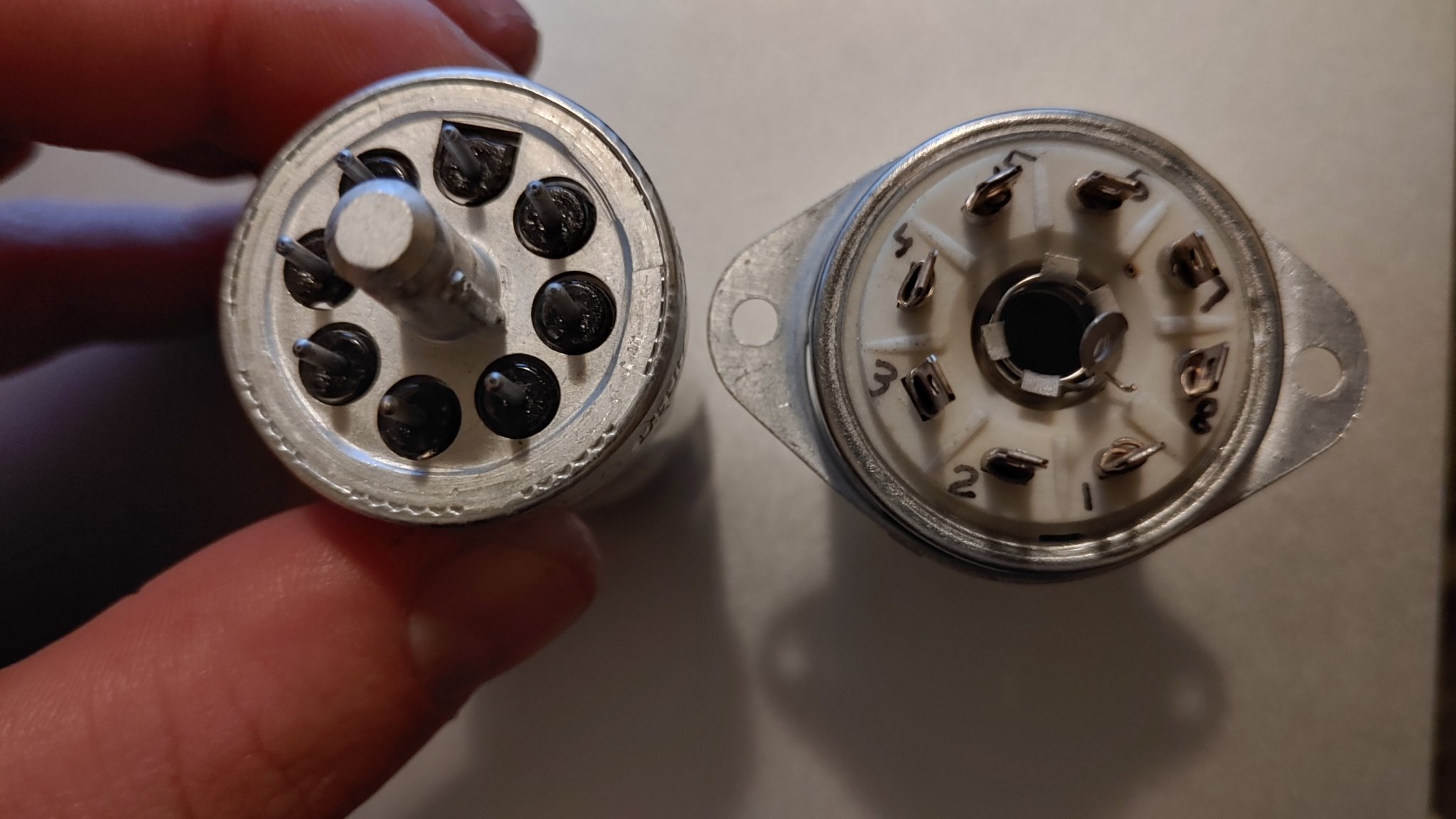

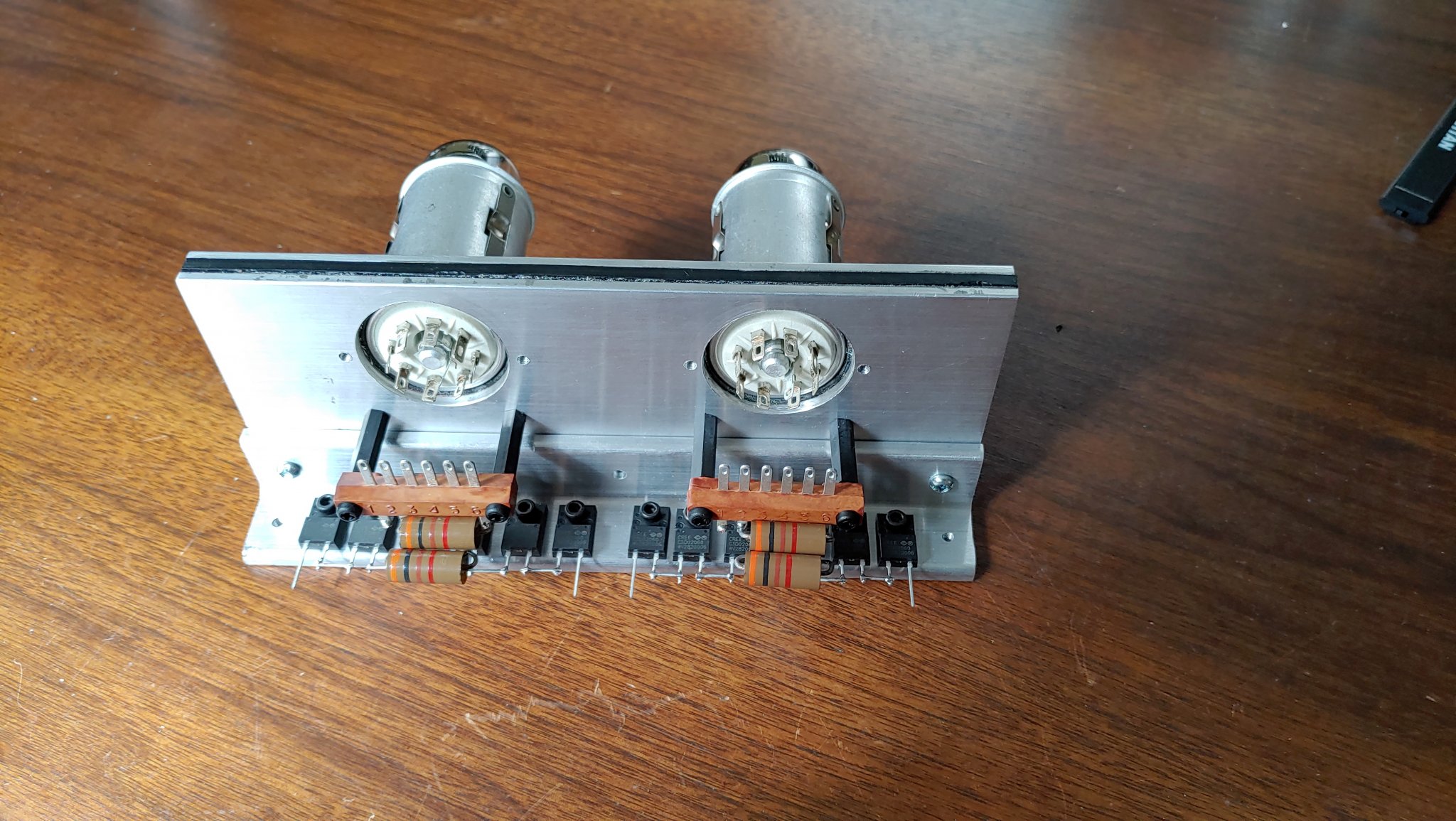

I'm very interested to hear about this. I've already gone through the design and build of this horizontal mounting assembly for my planned 4P1L preamp.
When evaluating the socket and position of the pins from what I can tell 4P1L filament pins 1 and 7 will be relatively vertical in orientation. So heating occurring from the side. My logic was also based on an understanding these were robust military tubes designed for radio and other circuits which would have been portable or at least seen more precarious mounting than would say a bigger DHT power tube like the 300B.
I need to get some design feedback for a B+ supply but hopefully this project will come together more over the next few months then we will know for sure.

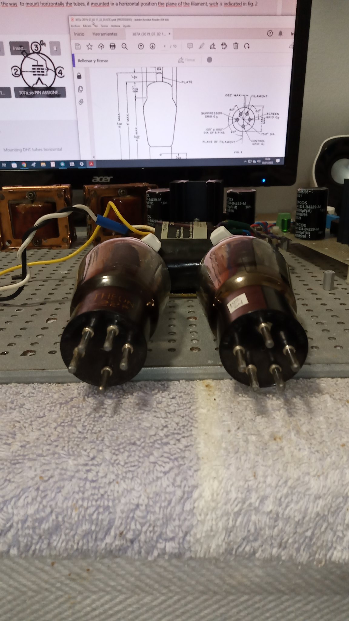

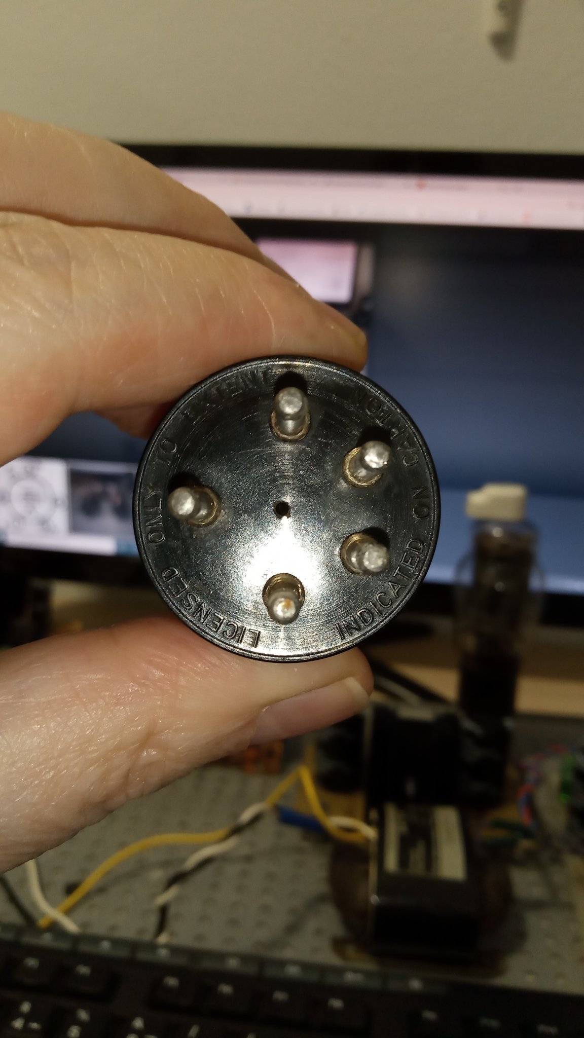

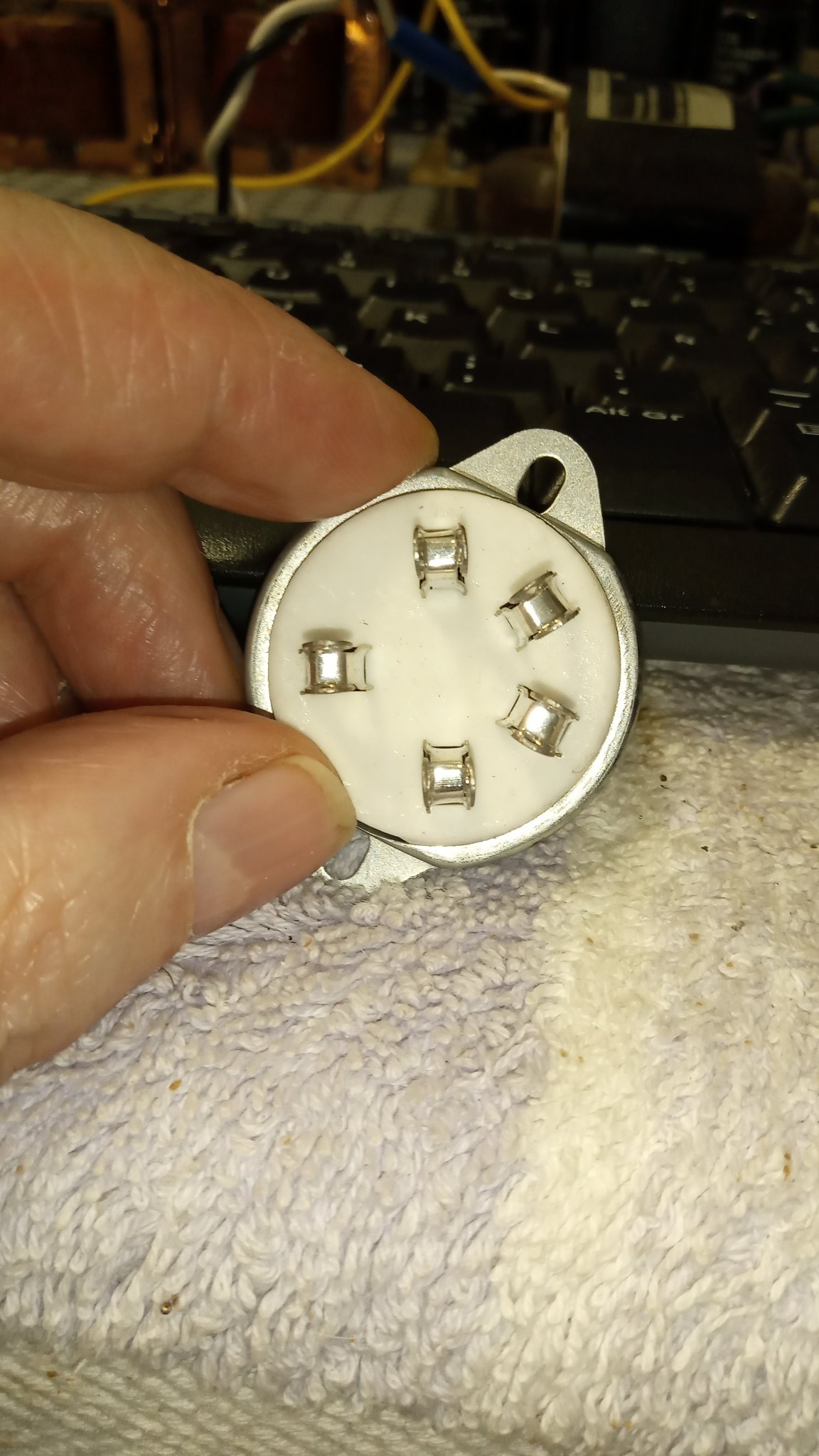

307A datasheet specific the way to mount horizontally the tubes, if mounted in a horizontal position the plane of the filament, wich is indicated in fig. 2 should be vertical, wich one of the photo the left side or the right side?
