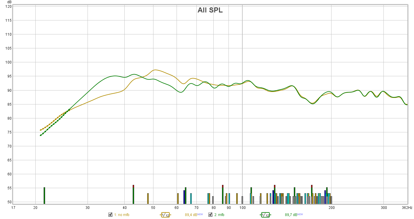

First test on the rubber magnet planar magnetic panel, i did use more damping then normal. i think these kind of panels dont have enough control to remove res completely :( brown without the MFB green with :) well it extends lower and shifts the resonance. then i end up with having trouble with excursion though :) so high excursion (instead of rubber magnet with 1mm excursion) would work better i think. another thing i noticed having more tension on the foil makes it better to :( but will raise resonance in frequency. aah well maybe i refoil them one day :) measure rather close 50 cm +- since where the speakers are standing wont allow low frequencies below 60 Hz all that much.. i had to move them to the other corner if i wanted...
Reactions: 1 user
Well its hard to tell, i am not convinced it removes much distortion , it might from the resonance but maybe purely because it has less output (less excursion). the added frequency response is a bit harder to compare.... since you are forcing it. and there was much less output at 35hz before... so the distortion that was already there will be even more... im still thinking about trying to EQ it so it looks the same then compare them ? just an idea
