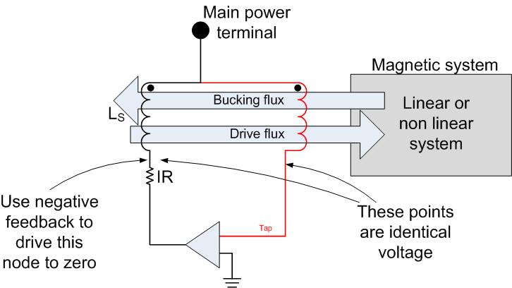

Co-winding, there will only be the IR drop of the primary creating a voltage difference to the pickup.

The bridge in effect would work at null to completely remove the back emf, think of no input and pushing on the cone, a sufficiently powerful amplifier would do whatever it could to prevent the cone from moving.

Has anybody tried this? In theory, it should compensate for the resistive part of the voice coil. Since it does not care what R is, it should compensate compression as well.
ps...granted, the power amp at the bottom should be labelled as to which is neg, which is pos of course.

Does the main PA drive the top? What impedance does it see? I bought a used speaker once with a modern very powerful 12" woofer where the VC had literally been launched out of the front of the woofer.
Yes, the top terminal is the drive. The lower amp output is the return.
The main amp sees everything except the coil resistance.

Oh, btw. We current drive ideal inductors all the time, lots of L and zero resistance. The supplies always require compensation for the specific inductance. I do not know how the circuit I presented will act with normal power amps, as the main amp is truly driving an inductor with zero resistance.
The best part is it doesn't require a very fancy model in order to determine the correct negative resistance, it does it automatically regardless of how hot the voice coil gets.

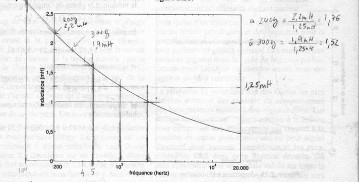

Le has not a constant value, it varies with both the frequency and the position of the voice coil in the gap, so one needs to be conservative when setting compensation for stability in systems using negative impedance amps.

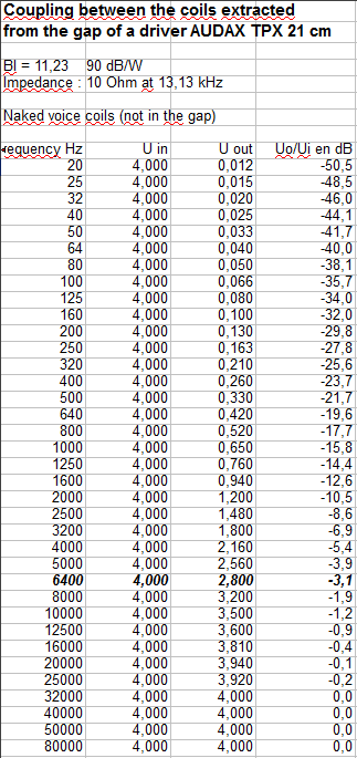

Hi Bentoronto,
Here are some pictures you may be interested in.
The first shows the indutance variation of a driver as measured by Joseph d'Appolito, the diagram figures in his book.
The second is the diagram of the error due to the coupling of the voice-coils in a specialised driver used by Hawksford-Mills in their famous project of a servo current driven loudspeaker.
The third presents a measurement I have done a long time ago.
It shows the coupling effect in a dual voice coil extracted out of the gap of an Audax 8" driver (in fact, it was a two-layers coil which I separated to get two separated coils).

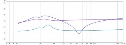

Being a very, very empirical person, first thing I did was test my new DVC driver sitting on its cardboard shipping box. I can't find the REW traces except for the crude illustration below which previously appeared in post #1, all electric signals. The straight line is the amp source, the line with the little bump is the driver impedance, and the weird line is the message from the second voice coil.
On that basis (and on looking at the really, really weird phase trace), I'd say the second voice coil is fairly well de-correlated from the first voice coil.
Also, with woofer MF, you don't want a big feedback factor. Therefore, it is no problem is the feedback signal is somewhat contaminated with the veridical drive signal. So what? Even if the cross-leakage is moderately large and unruly, it may be no problem.
If we trust the second voice coil, with feedback, my driver sitting on the cardboard box will be getting a whole lot more drive current at 62 Hz and rather less south of the resonance (after being corrected for acceleration, of course). Make sense? (Maybe not entirely.)

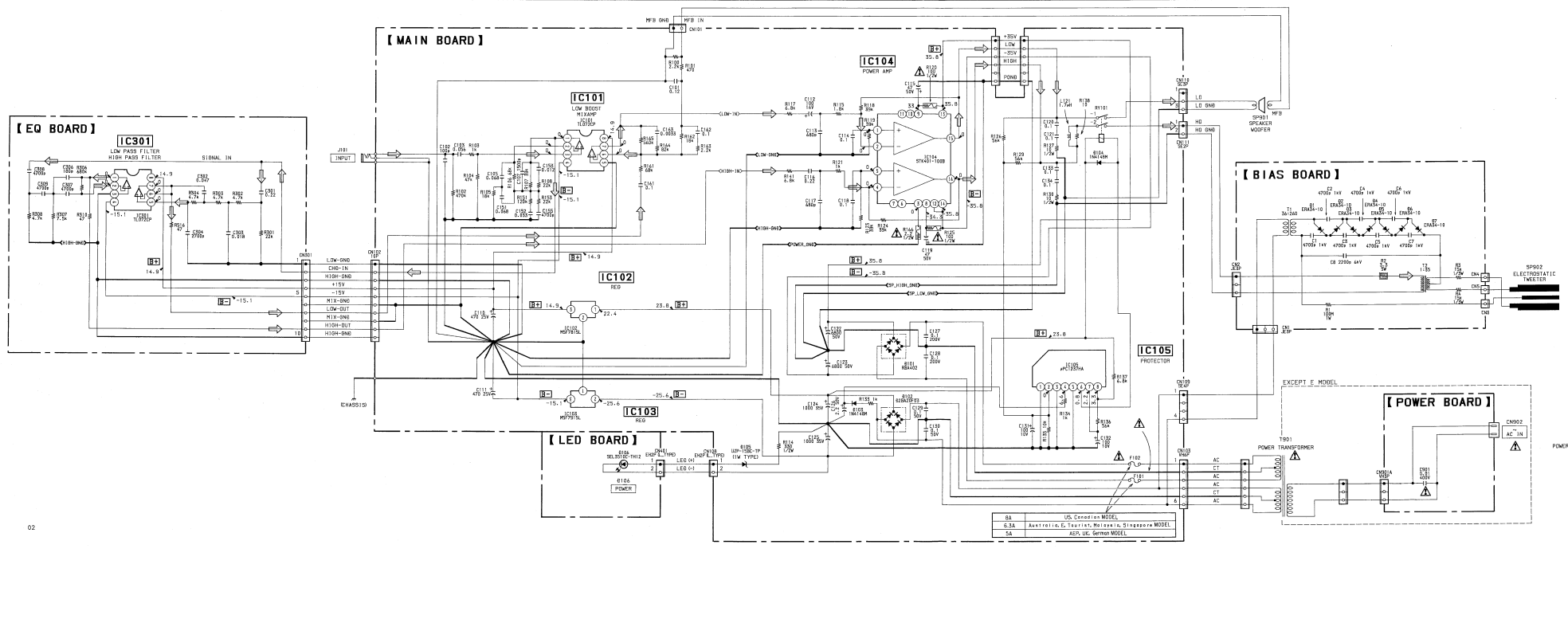

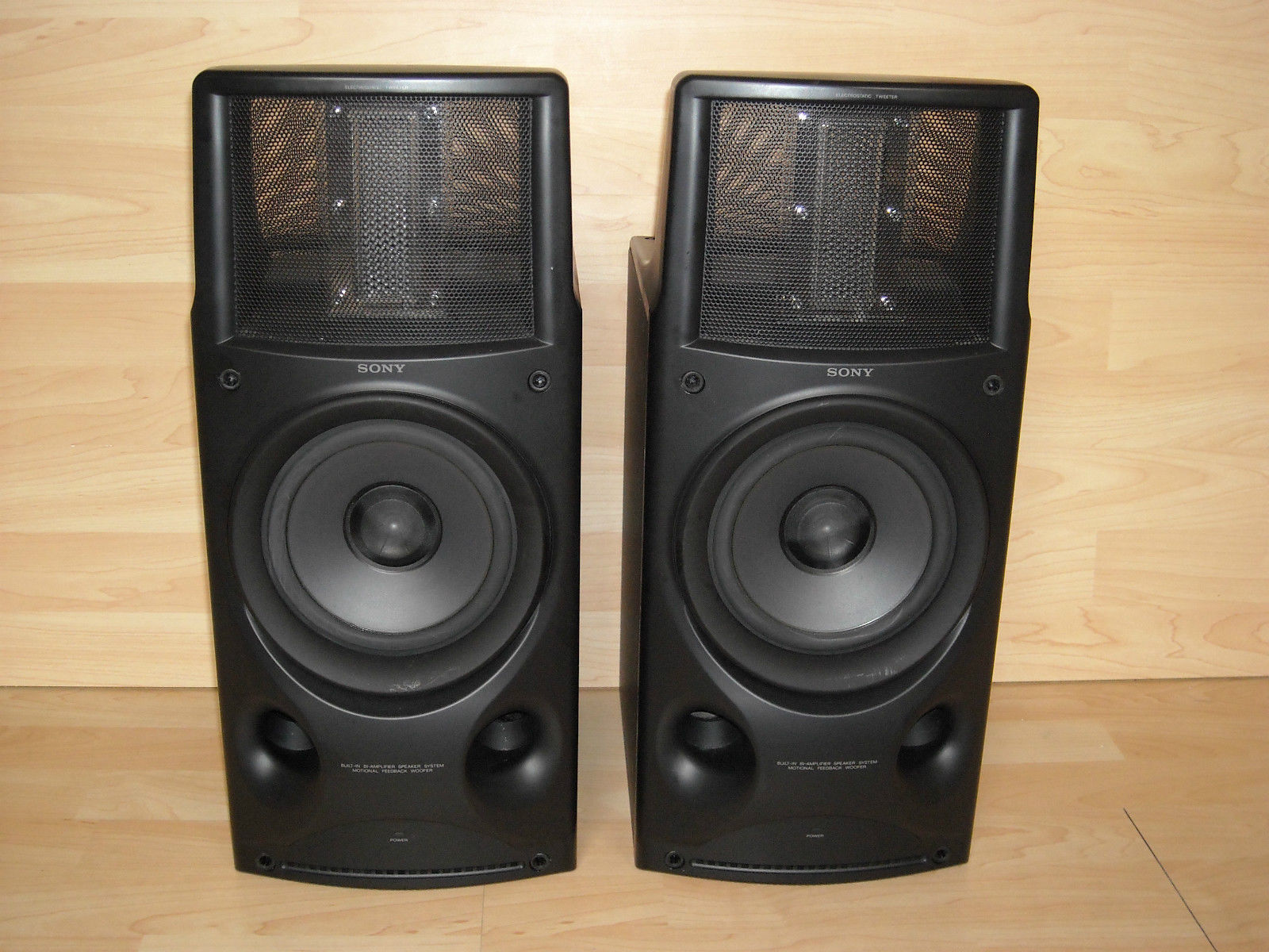

I have a pair of these Sony HA-7900 MFB speakers.
Their bass sound is quite decent, especially the sense of 'control' and damping in the bass.
The schematic might give some ideas.
