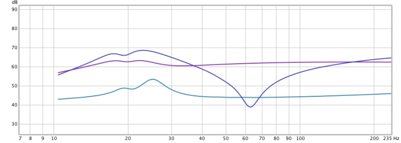

Ever wonder what signal is coming from that second voice coil?
Got to admit this is the first dual voice coil driver I've ever had, Brutus BRZ15D4 (don't tell my audio friends I bought a car subwoofer).
After 50 years of experimenting with motional feedback on and off, thought I'd check out a DVC.
Below is the signal from the second voice coil in blue (with the big dip). The mostly straight curve is the signal in. The curve with the bump (for want of the nerve to call it an obvious anatomically derived term) at 25 Hz is the Fo straight out of the box measured with 100 Ohms in series (while sitting on a cardboard box and you can still smell the glue; rating is 21 Hz). Different absolute values for the curves but relative dB value for each curve alone is true.
Interesting?
Ben
(Just fooling around with available gear and lots of alligator clips while on vacation, but that's what is looks like.)

The blue curve is related to cone velocity. Not something I instinctively knew, rather I had the benefit of Reading Jeff Macaulay's article in Electronics and Wireless World Feb' 1997. I also still have the subwoofer constructed according to the article. jeff macaulay's audio amp designs Have a look at the subwoofer tab.

And, quite right about weird phases. I didn't check phases in my earlier MF work with a bridge sensor, but I did destroy a driver, apropos your final comment.
Which is why I'm feeling good about experimenting with the Brutus car-sound driver rated at 10,000 watts before the frame melts (OK, maybe just 1200 watts before the Nomex spider collapses... OK, I really don't believe those ratings, but pretty stratospheric versus an ordinary 100 watt amp).
The REW phase plot for the second VC ran plus and minus 120 degrees with a strange jump right at resonance (or which may be an artefact of how REW plots phase). Tricky to get enough feedback factor when the phases are so extreme. But I did run MF successfully for many years without a hitch by keeping the feedback factor low; which of course means low benefit.

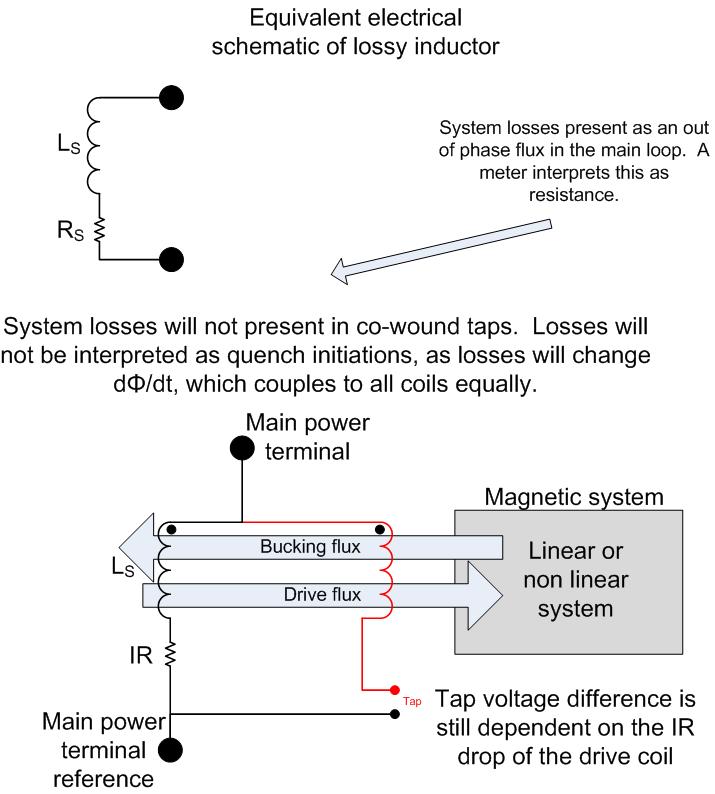

This concept really intrigues me. I do think that there may be some conceptual errors with this stuff, but I'll have to dig deeper..
Are the voice coils co-wound? In other words, are they one on top of the other?
If so, they are coupled all to heck, and the signal of the second cannot be just the velocity component. It has to contain the information on rate of change of flux due to motion (velocity), drive rate of change of current, eddy current losses which readback as IR drop, as well as rate of change of the system inductance ( I dL/dt.)
I did some stuff for others a while back, and one of the things produced was a version of this pic. (SW, you'll recognize it)
Of note, the difference between coil voltages is actually just the IR drop of the driven coil. All system non linearities which attack the magnetic flux are coupled to both coils, and will not present within the difference signal. In addition, any energy which is used to perform work (what we hear), will present as a combo of real (resistive) and imaginary (energy storage) flux coupled to both coils. edit: an inductance meter will simply lump all reactive as part of the inductance reading, and all the in phase as the effective series resistance. I wonder what exactly can be done with the difference signal, which is only the effective drive coil resistance? Hmmm
I guess it would be great to compensate for the copper losses as the drive coil heats up, as well as the proximity loss changes with frequency and gap inductance changes.
I'll have to think a tad more as to whether or not the second coil's voltage is simply the velocity. The apps I derived this for assume the coils don't move, that scenario causes hundreds of millions of dollars worth of damage..frowned upon of course..but interesting for DVC's..
John
In most cases, one coil is wound onto the former first, and the second one is wound over the first one. Naturally, it is more expensive to wind and terminate dual voice coils, and you will typically pay a small premium compared to a similar single voice coil speaker.
