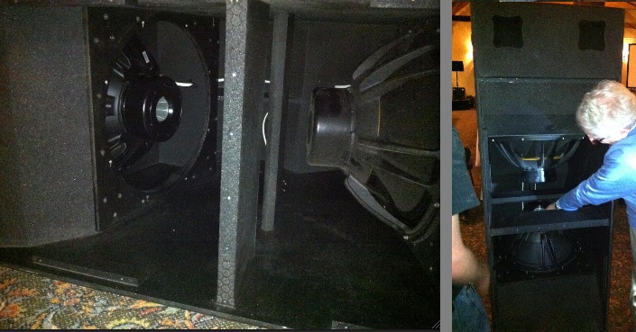

It's not an iso chamber, it's the throat you are looking at. Think PPSL.
The picture on the left shows the mouth with the left outer speaker removed, showing the inner driver which loads directly in to the TH throat.
The throat is not visible, though you can see a "V" wedge in the center of the horn at the back of the cabinet that leads towards the throat.
The magnet of the inner driver is clearly visible, indicating there is no push pull arrangement. The outer speaker is coupled to the inner through the small "isobaric" chamber.
The picture on the right shows the cabinet placed vertically, with all speakers in place, only two are visible in the mouth.
If the speakers were loaded PP, the isobaric chamber could have been made much smaller, and both driver's magnet vents would have been open to outside air, though the inner driver would have vented through a long horn. The choice to load the way they did is an interesting one, probably requred to get the desired throat compression ratio without a too complicated build.
Although Bennett was not particularly impressed with the sound quality, it certainly seems to be a design that can put out lots of output, and the cabinets had been through a lot of test drives, the heat build up in the isobaric chamber does not seem to have affected the B&C drivers.
Art
That's not a cabinet?
No, but in 3.4 cu ft you can have an F3 of 33hz/F10 of 15hz with 2000 watts power handling.😀
Interesting design 🙂 I have to say it looks like an isobaric to me too. Due to seeing the exposed inner driver, inside the hole cutout where the other driver would be mounted, & is on the other side.
Mounting drivers isobaricly equates to only needing half the volume normally required for the same f3 etc, which explains some of it's advantages. Doing that though decreases the SPL by - 3dB, but is made up for, & more, by the particular horn loading method. Plus they are using 2000W drivers, B&C by the looks of them 😉

I was just thinking of a good way to explain what I see when I realized that the fold is the same as Arts Keystone sub but with two drivers in it. Do you guys understand what I am talking about now? The inner driver is another tap in the horn path and that's why you get the boost and then the big cancellation.
NEO Dan,I was just thinking of a good way to explain what I see when I realized that the fold is the same as Arts Keystone sub but with two drivers in it. Do you guys understand what I am talking about now? The inner driver is another tap in the horn path and that's why you get the boost and then the big cancellation.
Your scenario would not be isobaric, and McCaully specifically says the design is isobaric.
My buddy Bennett knows what isobaric is, the manufacturer he reps also use an isobaric arrangement sub, also using B&C drivers.
He observed the M421 was isobaric when checking polarity and condition of the interior speakers.
You did notice how he noticed the M421 was not anywhere near the published specs, right?
Bennett would have also called BS if the cabinet was not isobaric, he pulls no punches.
You can believe what you want about the cabinet design, I'll choose to rely on the manufacture's description and first hand observations.
