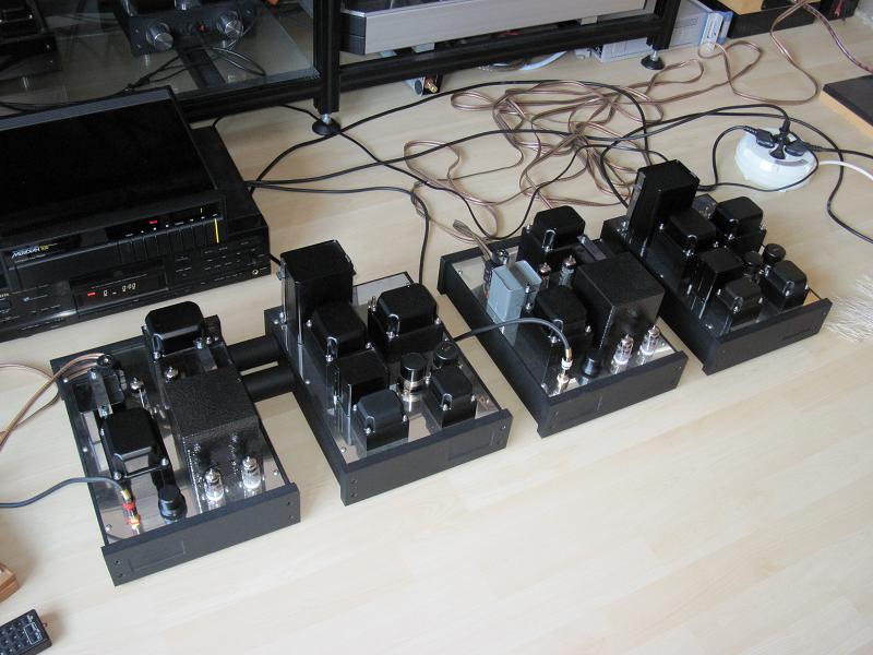

Good evening,
may i suggest an EL82 in triode.
Reason:
- an EL82 does sound nice;
- EL82's don't cost a fortune;
- EL82's are easy to drive and do have a very normal load .....no extreme tranny !

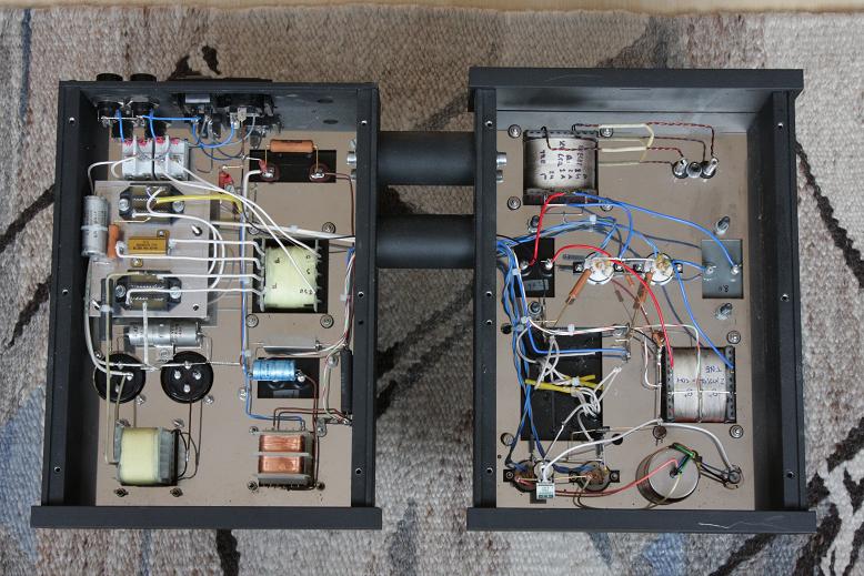

As i was looking for a smaller amplifier ( the main amplifier is more than 300 kgs....) i came up with this set up: input transformer - PP 6C45 - interstage - PP EL82 (in triode) - output transformer. The 6C45 does give enough gain and power combined with a nice low load......the EL82 "triode" PP-pair gives a nice 7 ~ 8 Watt. And very good Watts indeed ! I am more than happy with the amplifiers.
Of course you have to invest in your power supply....but that does apply to all (tube) audio-gear.
I've made 2 monoblocks with fixed (but seperate !) power supplies. The powerlines are inside the connectors that hold the power supply fixed to the adui-part itself.
Enclosed some pictures. And i found a datasheet on internet; maybe of use (copyrigth).
So my suggestion....EL82 in triode.
Reinout

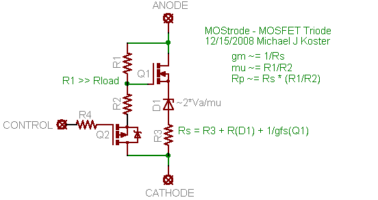

If I understand you right(but I´m not sure exactly how you mean) Michael Koster has quite recently showed a tubey solution at this forum.
