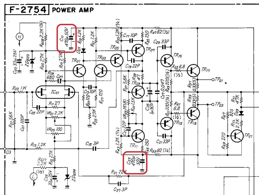

The capacitor role that I am inquiring about is shown in the sample pic below, marked in red. Large electrolytics on the main rail to ground. Those are decoupling caps, yes or no?

Yes the r47 +C11 is a lower voltage regulator for the 2nd stage. R53 + C23 is a lower voltage regulator for the transistor above it. With the low currents those transistors draw, 470 uf from any quality vendor should be totally adequate.

I do not doubt that any good quality cap would be adequate in that role. And I only buy caps from Mouser or Digikey, and usually either Nichicon or Panasonic brands. But there are many different types and series of electrolytics available to me, and they vary in those parameters listed in my original post, with trade-offs in their design.
So just for fun, perhaps as a theoretical exercise, even though benefits may be marginal-if-any, which parameters might be most relevant (or non-relevant) for the capacitor role as shown in the pic above? This is more about learning than it is about choosing a cap for a particular project. The amp show above is merely a sample, and not a current project.
The point has been made that a high ripple current rating would not be important. Good information, thank you.
Leakage and ESR specs do vary among the electrolytic caps available....
Might it be good, theoretically, to use the lowest possible ESR here to maximize the speed with which the cap is able to correct voltage fluctuations?
Might it be good to use a cap designed to minimize leakage to ground as there will be DC voltage (even though not full rail voltage) on those caps?
Ripple current and ESR go together. To handle high ripple current, the ESR has to be low.
For supply bypassing, low ESR is good, but low inductance is better. You want a capacitor (or combination of capacitors) that works at RF.
Leakage current is negligible for supply bypassing.
If you are designing new equipment, the most important consideration is to choose the right type of capacitor. Only the large capacitors in the power supply should be electrolytics. Tantalum, film, and ceramic capacitors are more suitable for smaller values of capacitance.
