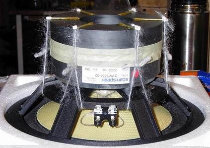

Auplater I admit that the signal level was low. But they can play a lot louder fullrange than a normal open ribbon. I crossover at 200hz 48 db. too this modifid scan speak.
It was made by the now late mr. Steen Duelund.
