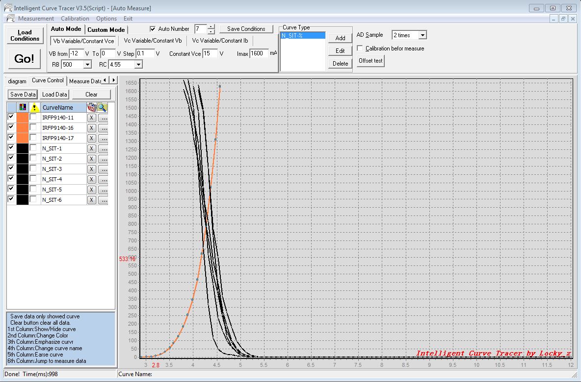

Chul parts I
some report.....
here you see Chul SITs in black
(picture most left)
the most right black curves are the THF-51 and the orange are normal P channel.
You see the crossing point is in the best case 1A and in the worst 0.6A. We would need a compensation circuit.

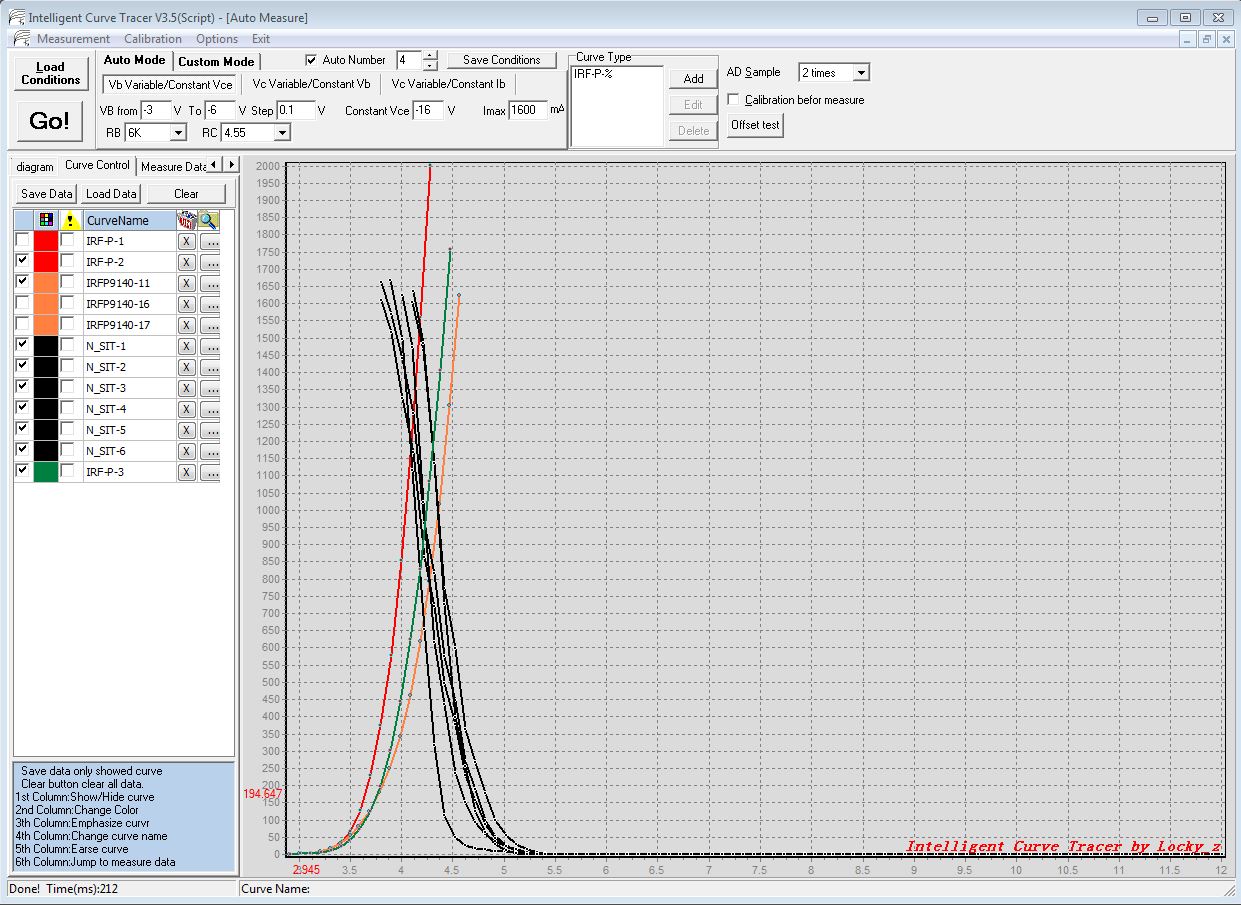

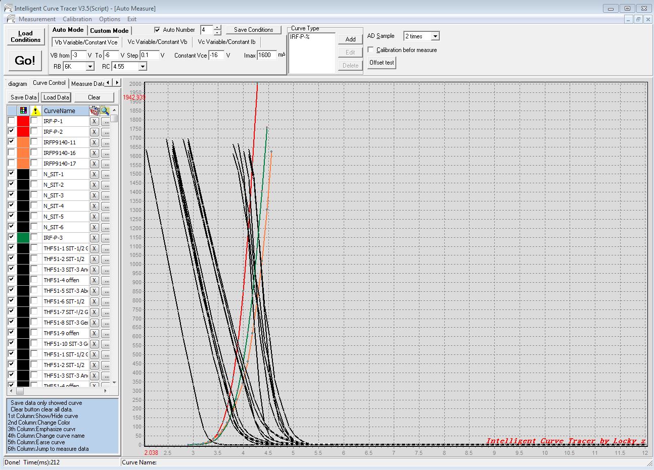

BUT….
I asked about four vendors of P channels for some parts with a low Vgs threshold and one delivered better ones….
In red the P channel parts with lower Vgs threshold and look, happily we have 1.5A at the crossing point with the THF and in the worst case still 1.1A.
Again red the "special" P channel, green a Harris 9140 and orange the normal IRFP240.
(second left picture)
What a progress Chul parts are for me you can imagine here.
All the black one more left are the SITs I have, much more gab between the two parts
(right picture)
Big thanks to you Chul!

I put the fitting pairs in and the current jumped immediately in the predicted region of 1.5A.
Nevertheless I make faults and write sometimes nonsense, so I will observe the temp
behavior to give you a more reliable answer.
