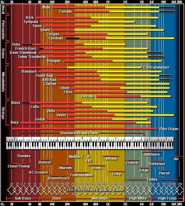

160Hz->320>640>1.25k->2.5kHz.
The middle 4 octaves.

Midrange is classically defined as 500hz to 4khz. For home/ casual listening, a driver no larger than 5” is the prescription.

Yeah, everyone has slightly different definition.160Hz->320>640>1.25k->2.5kHz.

My 3way active is set 300/3k.
