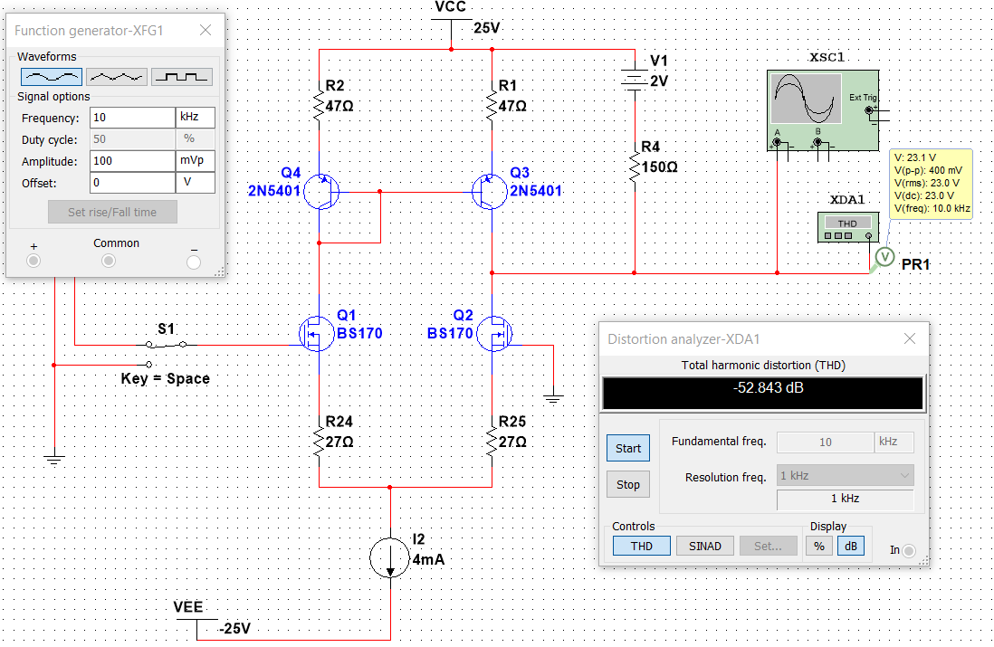

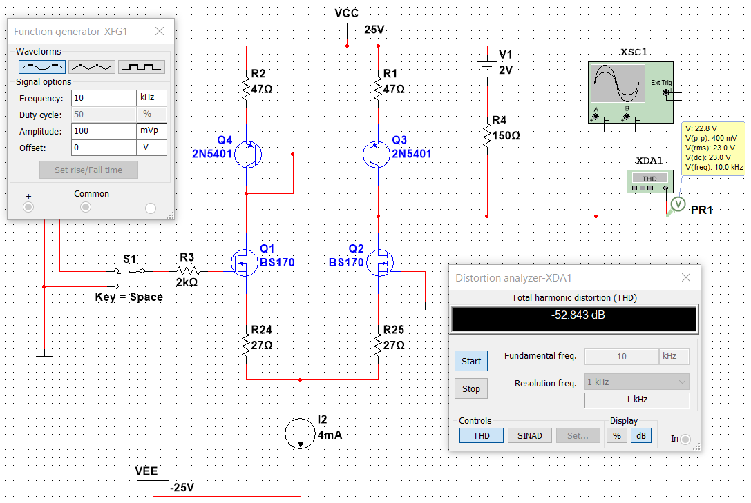

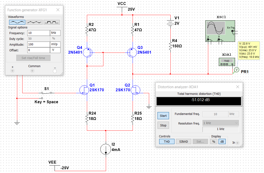

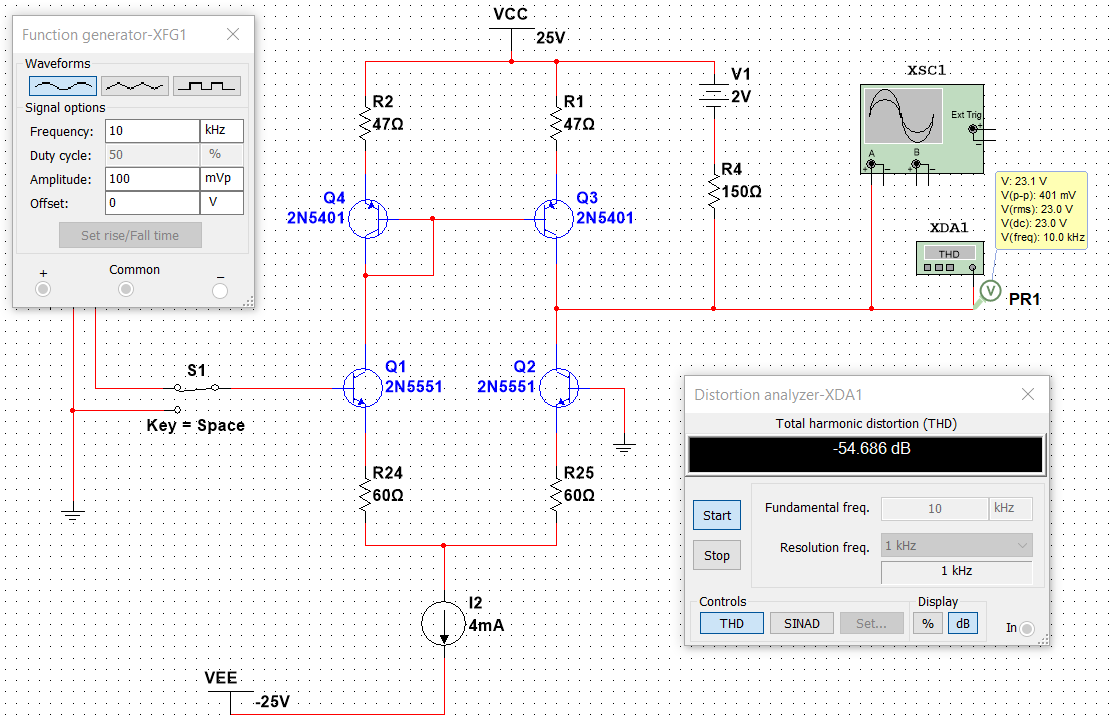

Right, with the same loop gain, the THD of the whole amp would be same. The THD of the output stage dominates and the input stage doesn’t matter.With different transistors in input LTP stage.
I have examinate THD.
BJT, JFET and MOS all show the same THD.
So, my conclusion is that it does not matter what transistors I use in input stage.
There is one caveat. With BJT, the loop gain changes with the signal impedance, because the input impedance at the BJT base cannot be ignored. It forms a voltage divider at the input. If the signal source is a volume pot, the loop gain changes with the position of the volume pot. That will affect the THD.
I prefer mosfet over jfet in the context of line level input of the power amp, because the mosfets have higher voltage rating and the noise figure doesn’t matter much.
