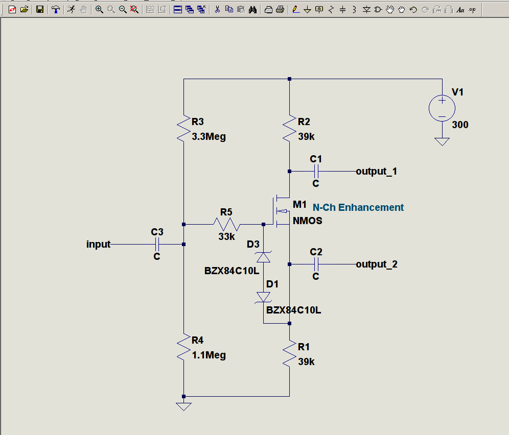

From the datasheet, this one is an N-channel enhancement MOSFET. This means that the source needs to end up at a lower voltage than the gate, so you can't use self-bias with a source resistor the way you do with a triode like a 12AX7.

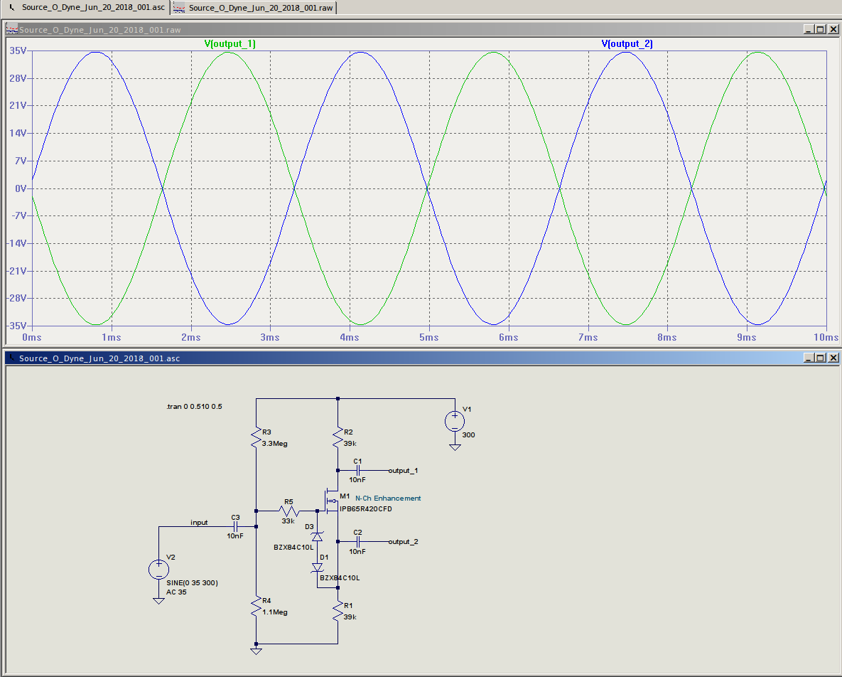

This isn't a problem at all, you just have to bias it a little differently. For a cathodyne substitute, use a pair of resistors to set the gate at one-quarter of B+ voltage. In operation, the source will automatically settle to within a few volts of that; because you're going to be using it with a B+ of several hundred volts, the few volts difference between gate and source is utterly unimportant, so you don't even need to care exactly what Vgs is.
The only thing left is to connect the source to ground with a source resistor chosen to flow a millamp or two through the MOSFET, connect the drain to B+ with a same-value resistor, and add a "gate stopper" resistor to prevent radio-frequency oscillation, and an input coupling capacitor to block any incoming DC voltage from the preceding stage. And don't forget to protect the gate from excessive gate-source voltage with a couple of Zener diodes.
The attached schematic should do the trick. The 1.1 and 3.3 meg resistors set the gate at one-quarter B+, the 33k is the gate stopper, the 39k source and drain resistors give you a wee bit lower impedance than the 56k resistors Leo Fender typically used here (you can lower them further if you like, but the source-o-dyne will draw a bit more current from the B+ rail if you do.) Finally, the two 10-volt zeners keep Vgs within safe values.
You can change all the capacitor values to suit your amp and/or personal taste, of course.
-Gnobuddy
see, that there nugget isnt mentioned anywhere...
for self bias, you want, i can only assume, an N-channel depletion mode mosfet. a device that is normally...um...on. sort of like a triode is.
anyway. theres a circuit to fiddle around with! i see exactly whats going on there. thanks.🙂
Why such a large value for the gate stopper resistor?
Just to play devil's advocate, why not? 🙂
I usually see 100 ohms to 1k.
Merlin Blencowe points out in his preamp design book that grid stoppers in most commercially manufactured guitar amps are usually ten to a hundred times smaller than optimal. Perhaps we are carrying over the same design flaw to MOSFET designs?
Reasons to use a much larger gate stopper include:
1) There is no DC current flow to speak off in the gate stopper
2) Because the MOSFET is in source-follower mode (due to the large unbypassed source resistor), the internal gate-source capacitance is bootstrapped, and so appears at least ten times smaller at the input compared to normal values of Ciss. Because voltage gain to the drain is small (magnitude is unity), the drain-source capacitance isn't amplified by the Miller effect, either. So the input capacitance of a MOSFET used as a source-o-dyne is quite small, meaning here is also negligible AC current flow in the gate stopper at any frequency in the guitar bandwidth.
3) A nice big gate stopper resistor will provide a better guarantee that even a high-transconductance MOSFET won't burst into self-oscillation.
The only negative I can think of to using a bigger gate stopper is a tiny bit more thermal noise - but we're at an amp stage where the signal usually measures in volts, or even tens of volts, while the thermal noise from a 33k resistor is a couple of microvolts. So the thermal noise is 120 - 140 dB below the signal - utterly irrelevant, because it's too small to matter at all. In other words, even the one tiny negative really isn't a negative at all!

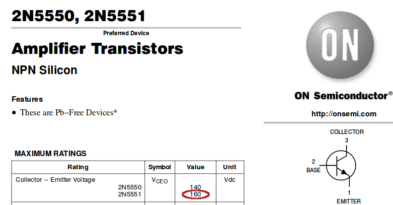

I wasn't familiar with the 2N5551, so I looked up the data sheet. VCEO max is only 160 volts, which isn't enough for most valve circuits.
To get 50 V p-p at each output, you must have been running the transistor at over 100 volts, but presumably well below 160 to have some safety margin.

Good point, I have been using B+ supplies no higher then 145v. At this level the 2n5551 only sees full B+ at clipping point. 10k collector and emitter resistors biased at 30 volts yields 85 volts VCE on 2N5551 average. 125 max 20v min at 50v p-p.
I chose these because I had one on hand and it has low capacitances good for 12AX7. LND150 would be a better choice for higher B+ voltages
