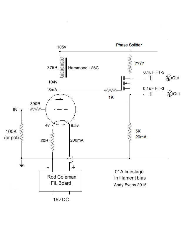

I'm interested in this thread for use as a phase splitter between a 4P1L line/driver stage and PP 4P1L outputs. I would need a schematic since I only have knowledge of tubes - haven't studied solid state at all. Is there a simple LND150 solution such as Tubelab posted?
I'd be grateful for some help here!
In a phase-splitter, treat the MOSFET just like a valve, the gate voltage sets the bias just like a valve with the exception the voltage difference between Source and Gate will be a little higher (couple of volts) depending on MOSFET to the Cathode/Grid of the valve it replaced, trim the load resistors for desired current.

Thanks for the link. Normally with a tube concertina I've seen equal resistor values top and bottom. I guess because typically a resistor was used in the plate of the preceding tube, so the concertina's grid was about half the voltage of the B+.
If this SS concertina were used with a preceding stage using a plate choke the situation would be different. Just wondering how to proceed with a setup where the gate of the device would be virtually at the same voltage as the HT?

Thanks for the link. Normally with a tube concertina I've seen equal resistor values top and bottom. I guess because typically a If the two outputs should give the same voltage ( which is a requisite for an amp) then the source and drain resistors must be equal.
The suggested schematic don't work that way,

Yes - that's the problem. It would work with Ale's Gyrator, where the HT could be chosen to allow equal resistors, i.e. somewhere around 200v.
That would probably work great. The one above with the choke can't work.
Edit: Of course, if you want to maximize headroom in your concertina, you need to bias the gate at 1/4 HT, but you may meet the requirements of the downstream stage as-is.
Edit2: Nevermind, spoke too soon. It won't work. You have equal drops over both resistors and so the fet is saturated and can't amplify. You need to lower the plate idle voltage of the previous stage for this to work, or give the concertina an even greater HT to work with.

I don't see the anode voltage of the previous stage dropping below 105v. So what do I need as a workable HT then? And if the lower resistor is 5K because at 100v that gives 20mA, then what would the upper resistor be?

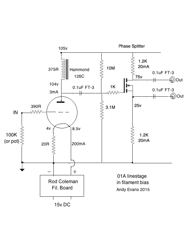

Both resistors should be equal for a phase splitter, unless you want two unbalanced signals (like if you wanted to adjust for mismatched output tubes, I have seen trimmer resistors added here to allow for AC balance adjustments to minimize overall distortion in an amp).
A tube or a mosfet has the same problem in your circuit. You have ~100V across the bottom resistor, if the top resistor is equal, it will also have 100V across it. That leaves the mosfet fully turned on with no way to turn on any further and amplify. This will make a splitter that outputs only half of the AC waveform.
The solution is to either bias the gate at 1/4 HT and couple to the previous stage with a cap or to increase the HT on the concertina stage. For maximum headroom, you would want HT at 400V or so.
Something like this? Not keen on two coupling caps...
Yes, or you can eliminate the coupling caps and keep it more like it was by simply increasing the HT to 400V for the concertina stage.
