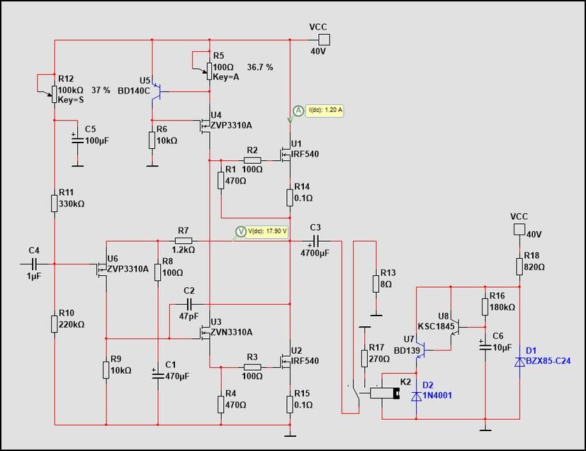

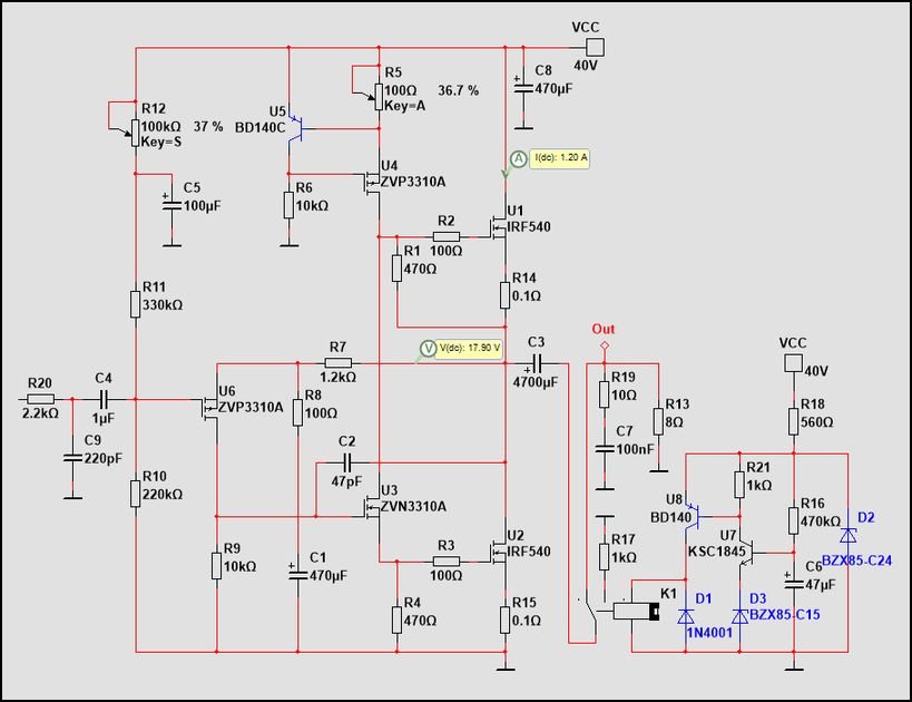

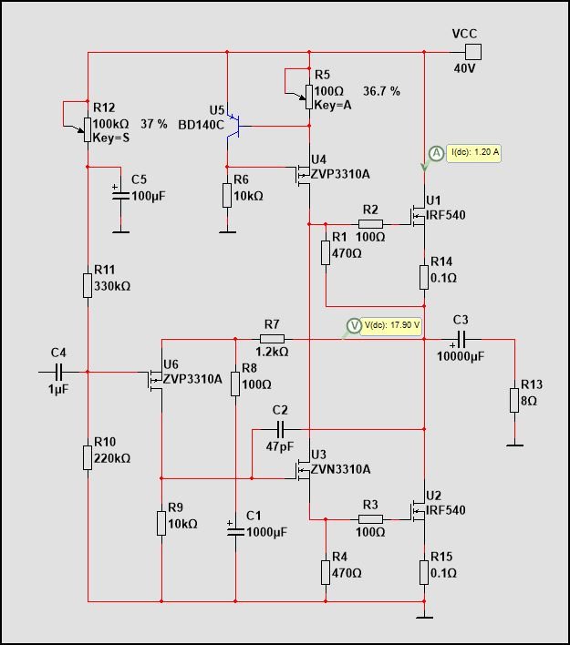

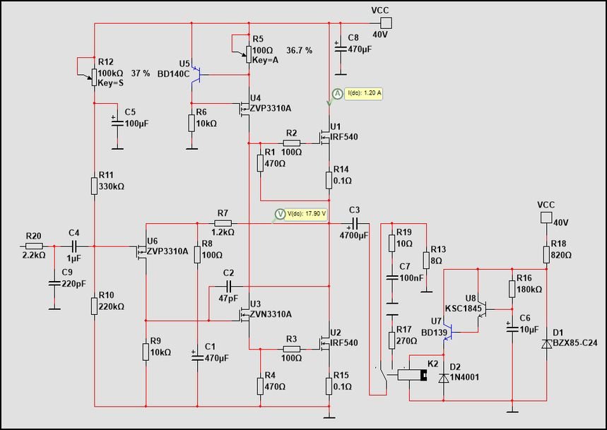

MOSFET Input, MOSFET VAS, MOSFET Output = 18 Watt
ALL MOSFET Amplifier.

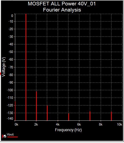

THD at 1 Watt is 0.0008%
Harmonics shows most H2 and a bit H3.
Output should be at 17.9V and the bias is 1.20A.
Max output is like 18 Watt.
Tranformer should be 2x15VAC or 30VAC for like 40VDC supply.
Enjoy!

I notice you don't use source resistor such as 0.22 Ohm usually. U5 could be BD140 so that you can do thermal coupling to the output transistors.
I prefer tying C2 from the output stage instead of VAS. You want R1 and R4 see the same amount current changed. The C2 on VAS will make the current imbalanced.
