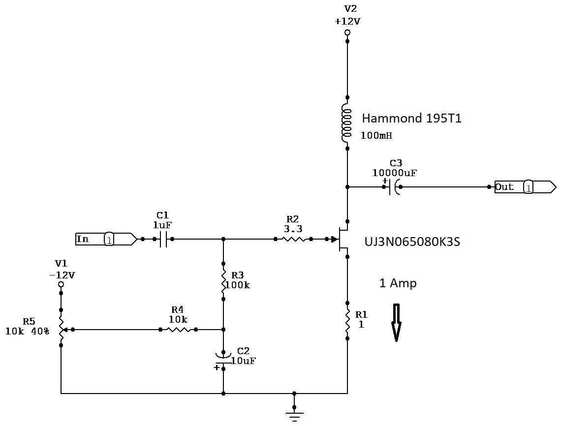

MOSFet Class A SE with inductive loading.

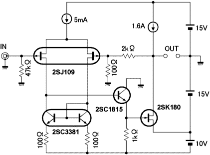

Here's a SE design:
http://www.amplimos.itimages2SK180_0.gif
Of course it involves current sources but perhaps someone could suggest appropriate values for inductor that could replace them ? classAchap perhaps ?
I haven't got the slightest clue about the performance of this circuit but there's quite a collection at the originating site and most are by reputable designers.
