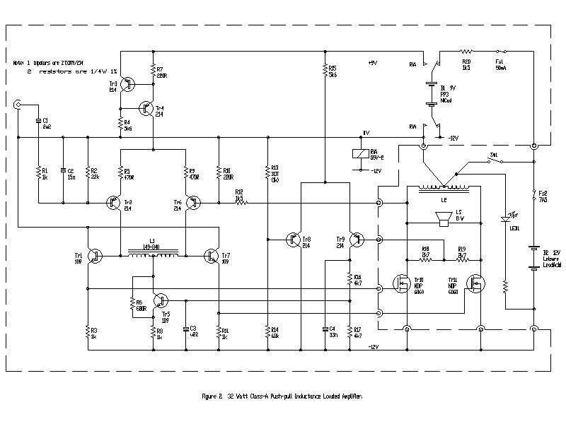

There was a very nice article in the middle of the nineties in Wireless World about exactly such a thing. It used a center tapped inductor in the output stage where the center tap was fed by a battery (I think) and two mosfets in balanced configuration were connected at either ends of the inductor. I think the author suggested usind an appropriately rated toroid transformer as inductor. I remember the iddle current was 6A (or was 3A per mosfet?).
In addition the driver circuit used a intestage transformer to drive the mosfets.
The whole schematic, in my mind now, reminds me of a inductor coupled zen amp but I'm quite sure there were other differences that I've now forgotten.
I got most parts but stumbled on the interstage audio transformer (I never found a sufficiently high specced part to use) so I never finished building it. I guess I didn't know where to look back then.
It's well worth digging that article up if yoiu're after that sort of thing.
Unfortunately, I haven't got the article with me right now but if you email me I'll try to find it and scan it when I go back home during easter.

Maybe I've posted too soon as the circuit I'm referring too really resembles the ZV7 mentioned above - if you can imagine the final stage being driven by an emitter follower bjt and that in itself connected to the gain stage through an intestage transformer/inductor. Funnily enough, the idle current seems to be the same in both designs !

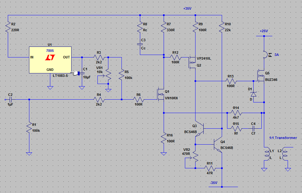

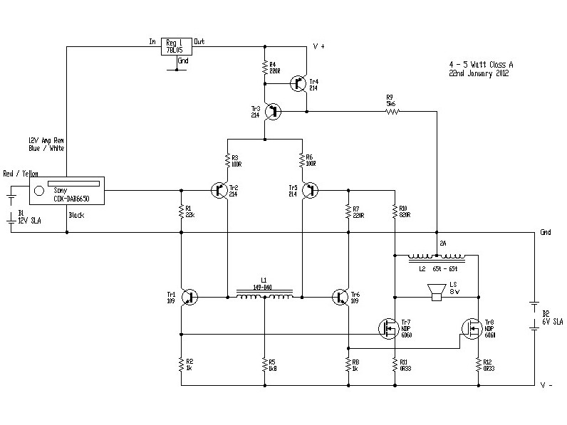

I think this is the circuit you mean, Stelios (pic 1)
The latest issue is much cleaner and now looks like this (pic 2).
The offset control feedback (Tr8/9) has been replaced by source degeneration, trading efficiency for simplicity.
Battery B1 has gone along with the on/off switch, replaced with a small regulator, Reg1, the reg input now serves as on/off control (I'm using a quality car radio as signal source)
As shown it's biased for about 5W output, since that's all I need, and is powered by 2 little 6V 12A SLAs. Biasing for more power is just a matter of increasing supply voltage (B2) and adjusting R5 for required quiescent current – oh, and increasing the heat sinks. For a couple of years I ran it at 32W driving Monitor Audio R652 (or something), now I use horns I only need 5W.
Sorry about L1, you can find it here: common.leocom.jp/pdfcat/catalogpage/1_1840.pdf
If I have another go I'll probably remove it.

Found it, the Andy Grove design was in HiFi World February 1996 with an alternative by Chris Found, with better linearity. Both were specified at 15W with a BUZ346 output device. There was a follow up in June 1996 in the letters page clarifying a few typos, which I have a copy of.
On second thought, I think I'd prefer the original: 6W dissipation seems a bit too much for a low power amp to me (even for a 50W version) - my environmental sensitivities kicked in here.
Not much change there in terms of the number of batteries then. But having the same kind of batteries throughout might make practical sense and I've read that SLAs are better sonically ? would you agree with that last statement?
The point about deleting battery B2 is that it also removes the 10A switch, switching the amp OFF when the source goes OFF - and it gets rid of the relay. Its a much tidier solution.
oh! I'd still feel much safer with a switch at the output stage power supply even if this is a much more elegant solution.
