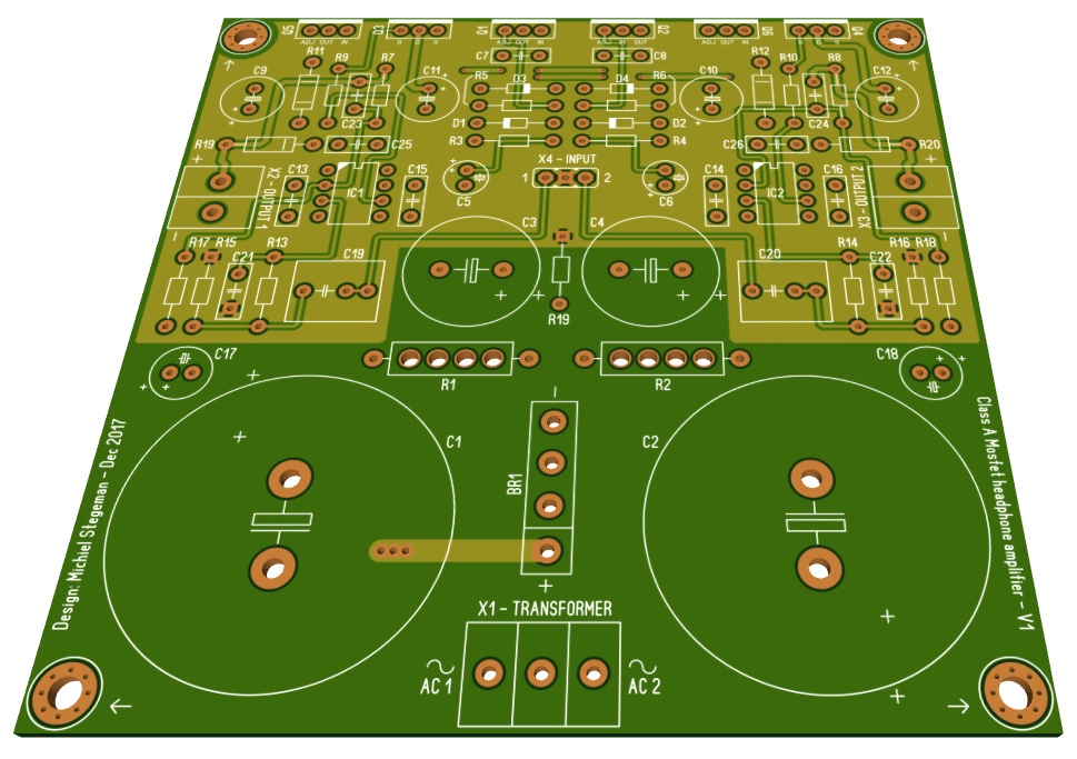

C3 and R5 is at the inverting input of the OP LT1056.
Ah you are referring to the schematic in the pervious post.
R5 sets the gain in combination with R4.
C3 is used to prevent the opamp from amplifying any possible DC offset at the input.
