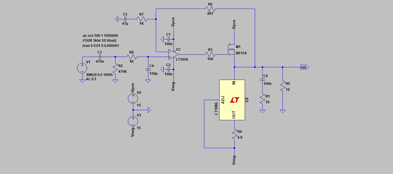

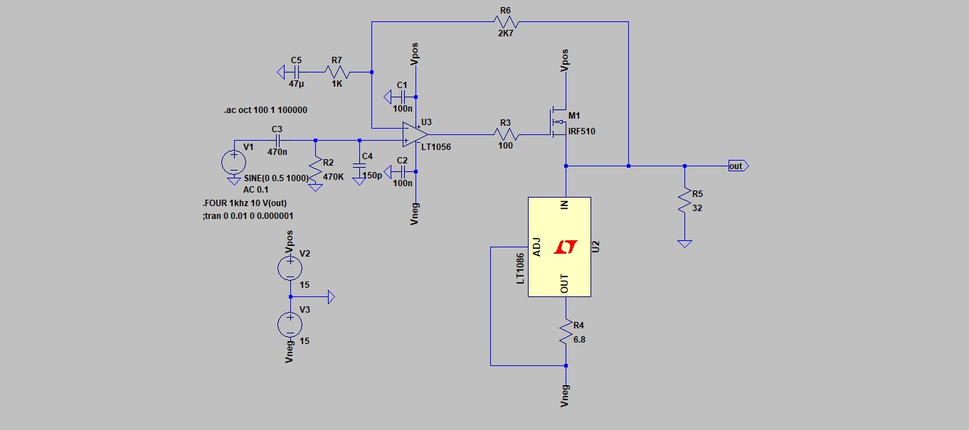

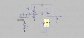

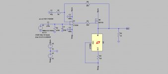

Mosfet class A headphone amplifier
update
