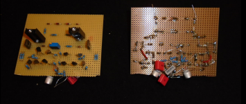

Here are some pictures of what i have build sofar.
The Vanderkoy is complete but i can not make it work without noise.
The Nostagia is complete but is without PSU. The picture also shows the CapMultiplier PCB.
The Elektor AXL frontend is the picture with the veroboards.

It's time for you to start to use proper designed PCB instead of those rat nests.
Specify "noise", please. Is it oscillating (my guess, looking on the build)?The Vanderkoy is complete but i can not make it work without noise.
