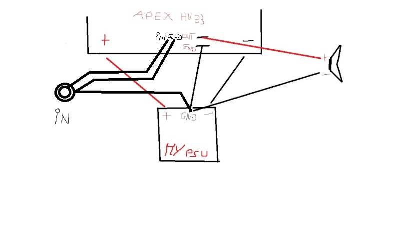

Finished .... one module. I connected power supply (Vcc 60-0-60 of my amp) and comes out a strong background noise together with the music. Noise is also present in the absence of music. It 'a problem of GND, I made some mistakes?

Input gnd also must be connect to psu gnd with separate wire.

There is no connection from psu gnd to input gnd only to power gnd.
ok ... I did not understand much, you may be more detailed. thanksThere is no connection from psu gnd to input gnd only to power gnd.
ok .. clear, provider and now .. thanks![]()
noise problem, solved ...
