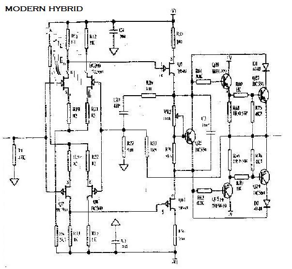

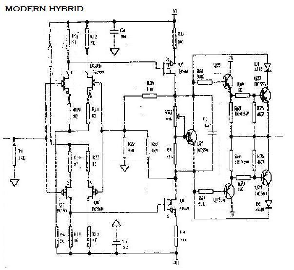

Mosfet amp or Transistor amp?
better way toghether
ciao
my idea is swap the standard hybrid
with transistor in input/VAS + mosfet as final
using
2SK170 AND 2SJ74 for input/VAS
MJE15030 AND MJE15031 (8A-50W) AS FINAL STAGE

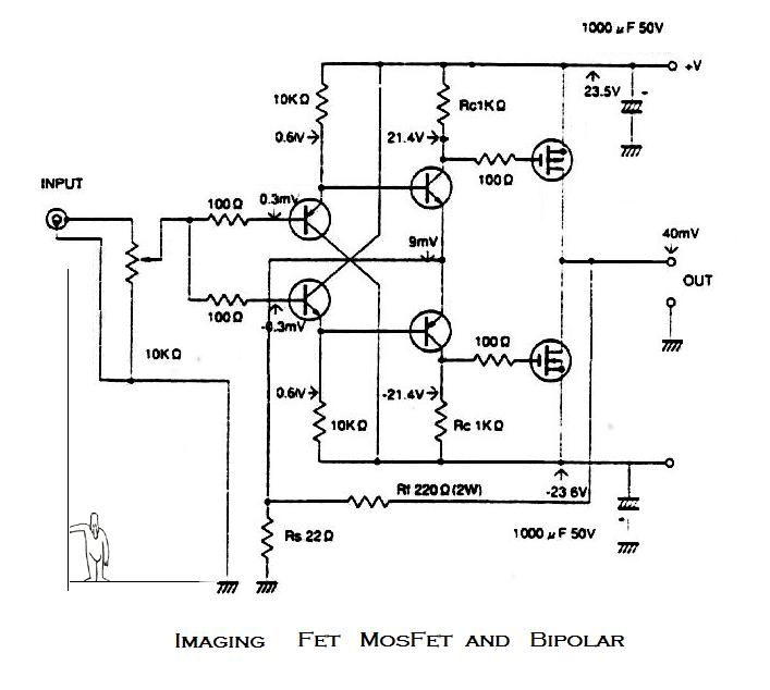

Re: Re: Mosfet amp or Transistor amp?
nigelwright7557 said:
Both are good for amplifiers.
I have built my own using both and had very good results.
Personally I would stick to a tried and tested design.
Yes, both BJTs and FETs can give very good results in a good design, but both are capable of very poor results in a bad design.

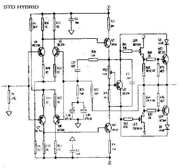

fet mosfet and bipolar
start with fet on input 2SK170/2SJ74 are very good
then for voltage gain stage better use 2 big mosfet like 2SK1058/2SJ56
For final stage are better bipolar 2SC5200/2SA1943
Complementary configuration is essential for ideal results
the architecture is traditional but without second current stage
sorry don't have good picture
