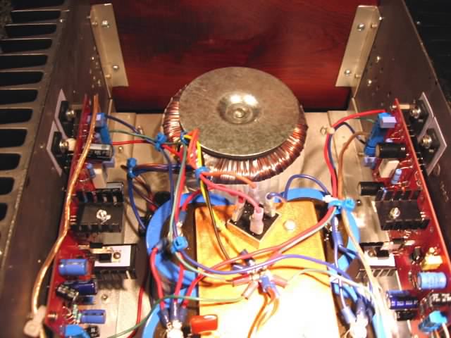

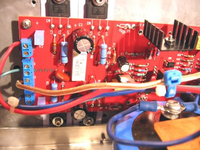

Some pictures of the prototype.

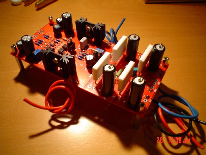

I'll be posting pictures of my MA-40s shortly.
(waiting for binding posts from jrsun and aluminium oxide insulators from Mark G to arrive in the mail)
Just wanted to say thank you to both of you: Jam for designing and Mike for sending me the boards.
For some reason these were the nicest boards to solder that i've ever done.
I've been using WBT silver solder for a long time, soldering the boards was a treat.
Thanks.

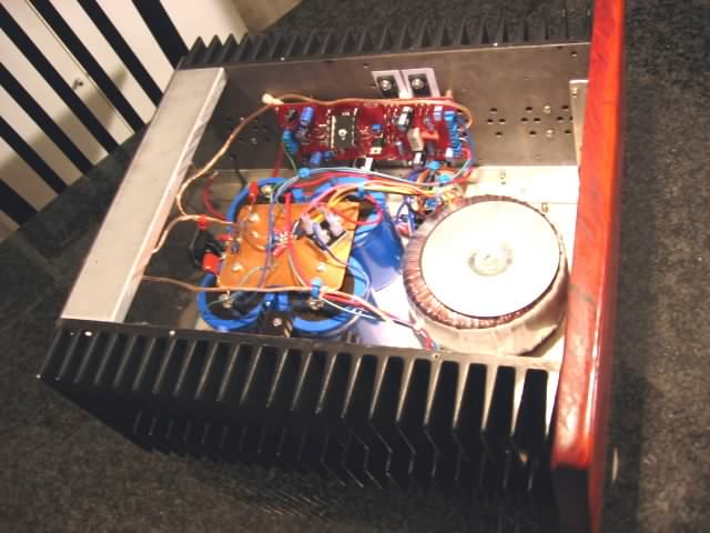

How its going on the sinks, the capacitor board comes underneith.
The 30VA and 300VA toroid transformers and the voltage board go in an enclosed and shielded bottom section made from 0.4" aluminium covered with copper foil.
Yep, SK53, about the only Fischer heatsink profile that does what its heat transfer curve says.
The SK53 is both in volume and cost a very economical heatsink, compared to its thermal resistance ratio.
And i bought so much of it 15 years ago that i still have 10 feet of it left.
The holes in the square connecting rods on the picture are threaded, the heatsinks will be thermally coupled with the 4" high aluminium box they rest on. The entire rig can handle 110 watts at 50C.
That was the estimate i got from a finite elements model i made of the chassis with a program to calculate heat distribution in ship constructions.
(and if it doesn't i'll staple the thing shut with Papst vents :clown: )
Thermal calculation is without the 5 lbs marble fronts i am having made by a cemetery stonery.
