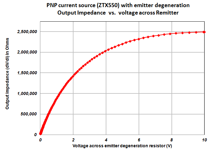

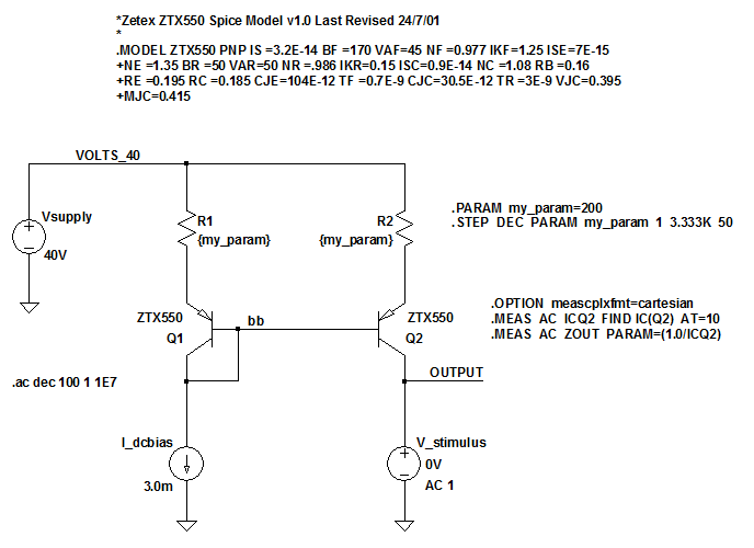

I simulated a 3 milliamp current source using a PNP with emitter resistor Re, and measured the output impedance of the current source as a function of (the voltage dropped across the emitter resistor).
Current was a constant 3.0 mA in each case.
I exported the results to Excel and made a plot, attached below. More voltage dropped across the emitter resistor, gives greater output impedance - with diminishing returns. In the Morgan Jones voltage regulator, the gain of the error amplifier is approx (gm_q3 x Zload). Installing this PNP current source in place of R6 would raise Zload from 12K to about 2Meg, increasing gain pretty substantially. Assuming of course that Zin(U2) is not a significant factor.

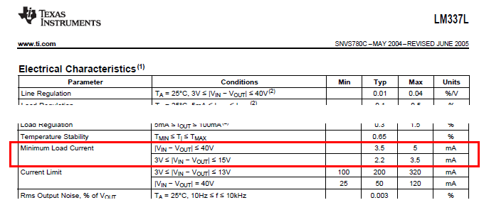

I'd be a little concerned about running an LM337 at just 1 mA since the datasheet commands you to run more.

Actual current from the LM337/317 in this mode is about 1.5mA. I'm not worried about running it at less than the recommended amount -- as it appears to be pretty stable.

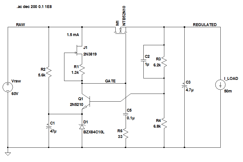

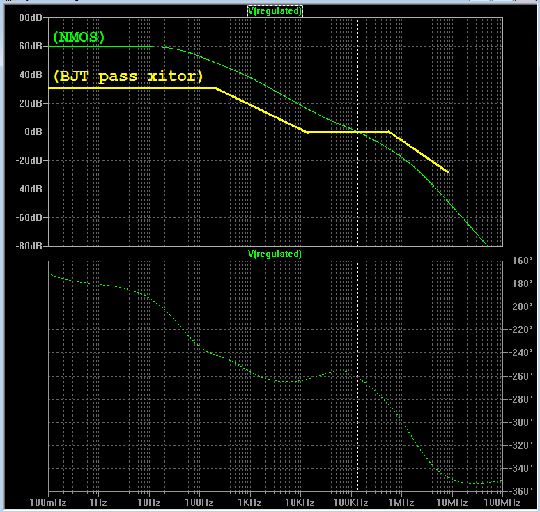

Here's what happens when the series pass element becomes MOS; now the error amplifier's dc gain achieves its maximum possible value, (gm x ro), which is about 1000X or 60 dB.
I was in a hurry so I just installed a simplistic lag-lead compensation; phase margin at unity gain crossover is about 95 degrees. You could play with this some more if you wished.
New circuit's Bode plot in green; my hamfisted attempt to draw a copy of the previous circuit's Bode plot, in yellow.

Looks like the Darlington-ness of the TIP142 is giving you a Zin sufficiently high that it doesn't degrade the low frequency gain of the error amplifier. But I would have thought that a MOSFET has an even higher Zin, thus an even higher gain at dc. Oh well, faulty intuition. Again. The TIP is probably cheaper and probably needs fewer protective components; easy decision.
Edit- apologies for an error in the Bode plot I posted. The yellow line is your first circuit with no current source. I copied from the wrong post! sorry, MJ
