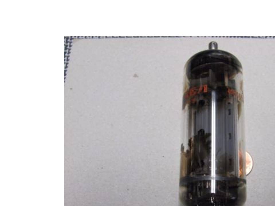

electrons hitting the glass, typically where there are holes or gaps in the anode, gradually turns the glass brown
Electrons (or rater ions) hitting the glass look lake mirror halos opposite cathode opening or anode holes. The dirt I am talking about is completely different kind - large irregular brown splotches. I haven't seen anything like this in other tube types.
Wugh, ugly splotches!

Looks like some kind of "creepage" damage along the glass surface where it has become conductive in the brown areas. Must be a high E field at the edge of the brown that is attracting damaging ions. Maybe the damage to the glass creates more ions too.

Funny though, I tested them and all test good. I am thinking it is some sort of re-depositioning of getter material.

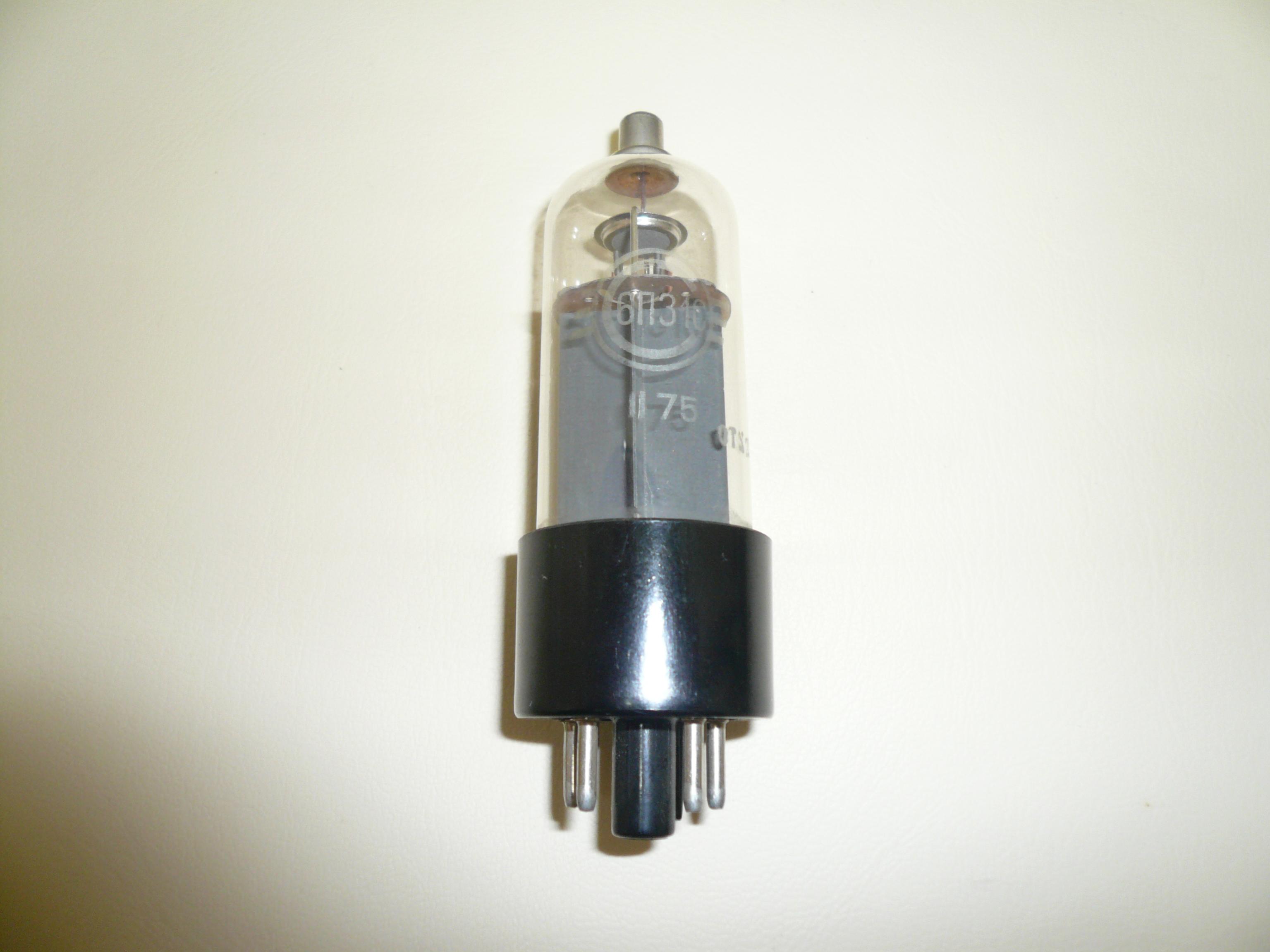

And also Russian 6P13S.
Russian tube 6P13S is somewhat different from EL36 (or Russian 6P31S) because it is well tolerated voltage at G2 up to ~ 400-450V!

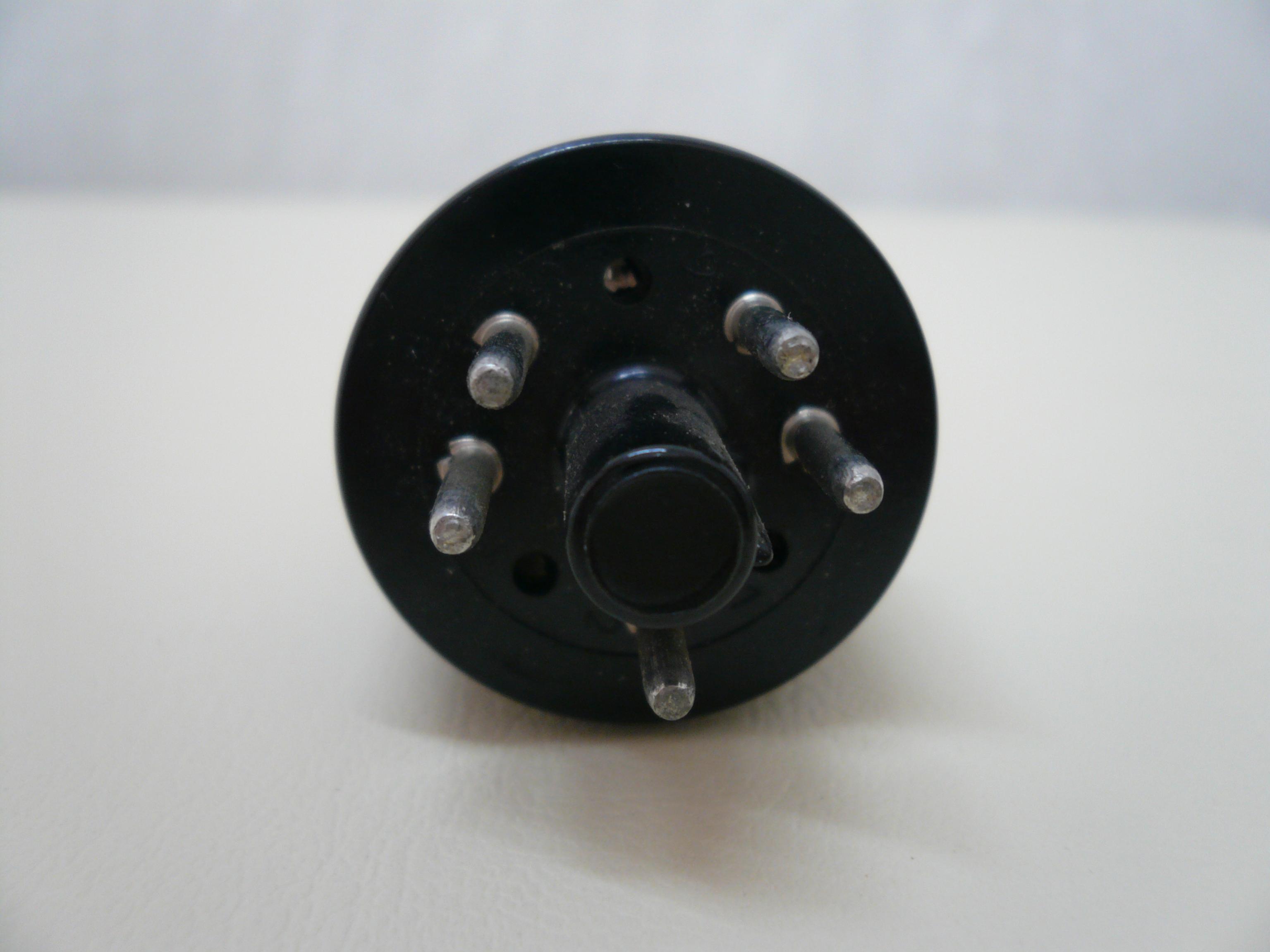

I stand corrected, 6P31S is closer to EL36 than 6P13S. Also, 6P13S has different pinout compared to EL36/6P31S.
sser2, I'm amazed the tube still tests ok as obviously that didn't happen overnight. Lots of (always tv type) tubes on ebay advertised as NOS have blotches like this. So you think that getter material is re-condensing on slightly cooler parts of the glass?

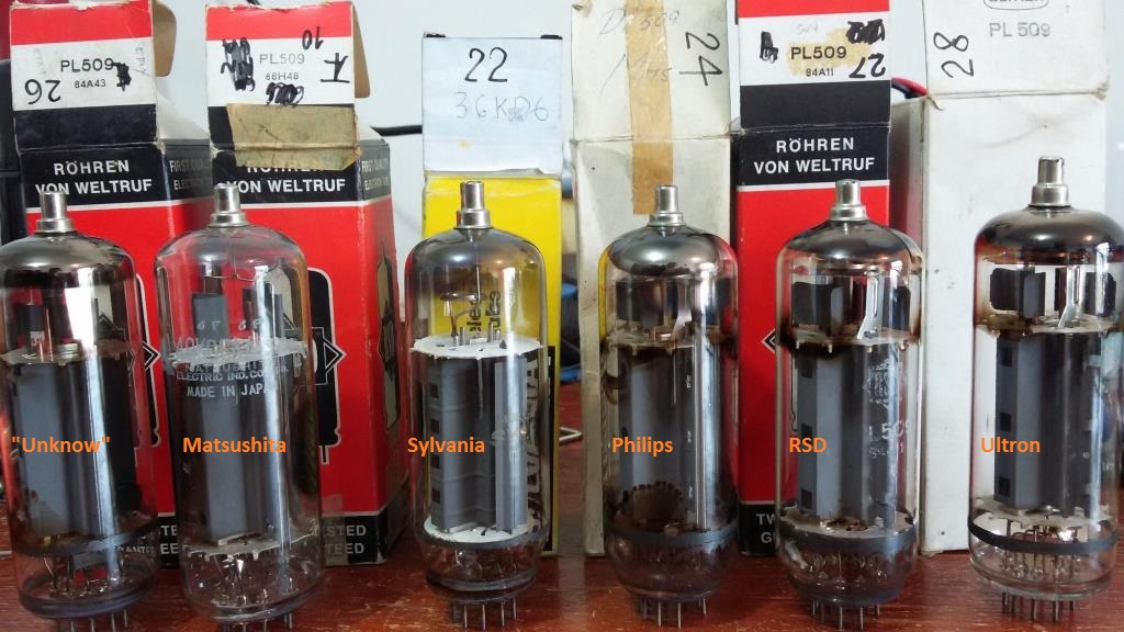

The Philips sample here have more splash, and from my PL509 collection, Philips tubes are notorious for this. RSD/Ultron have only the mica-aligned dirt or less spectacular dirt. Matsushitas and Sylvanias are less prone to dirt. Exceptions to rule sometimes occur.
Even Philips completely full of splotches measure perfectly and with very low g1 current (in nA magnitude for negative bias). Like sser2 said, these tubes are ok.

I don't know what the brown stuff is but I have seen several tubes that have it and they do seem to work fine. Coincidentally? they are all TV sweep tubes.
I have also seen some with the brown growth that didn't work so well, so the presence of the brown growth is no indicator of tube condition.
Tubes don't come from the factory that way, and I can't imagine something like that happening overnight, so I would tend to believe that you example has seen a good bit of use.
Examining an EL500 with similar (although less severe) blotches, it is interesting to observe the very fine structure which can also be seen in the photos above.
The Hangout
The best explanation I've heard about these brown spots seems to be the following: It is electrolysis, caused by stray electrons, that separates lead from the glass and deposits it to it's inner surface. Yes, TV tubes (sweeps, dampers) may be more prone to this, due to their higher working voltages, but I've also seen the same spots in older AF power tubes, such as EL 41's, that operate on 250Vdc.
