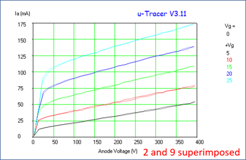

The gain of the two output tubes needs to be equal in class aB to get low H distortion without N Fdbk. Either selected/matched tubes or a gain matching pot in the driver section.

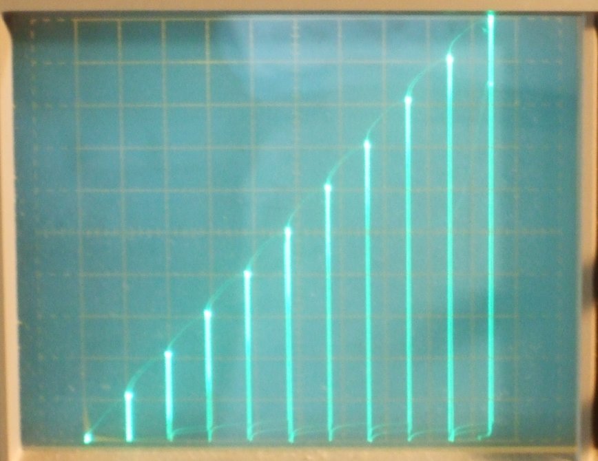

Thanks. Would matched Rg2g1/Rg1, 1.89k/10k Ia vs Va plots do it?

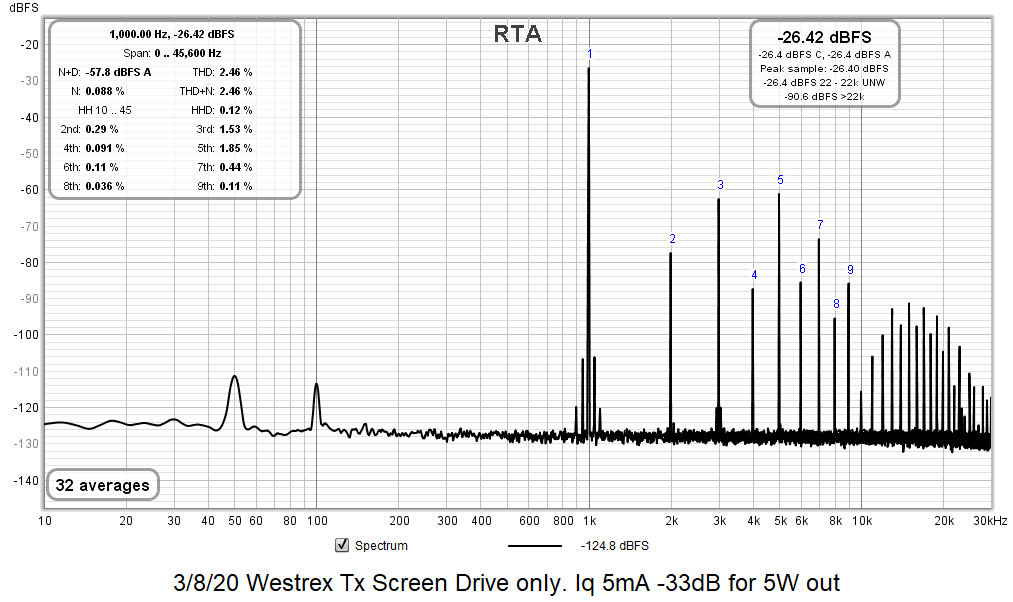

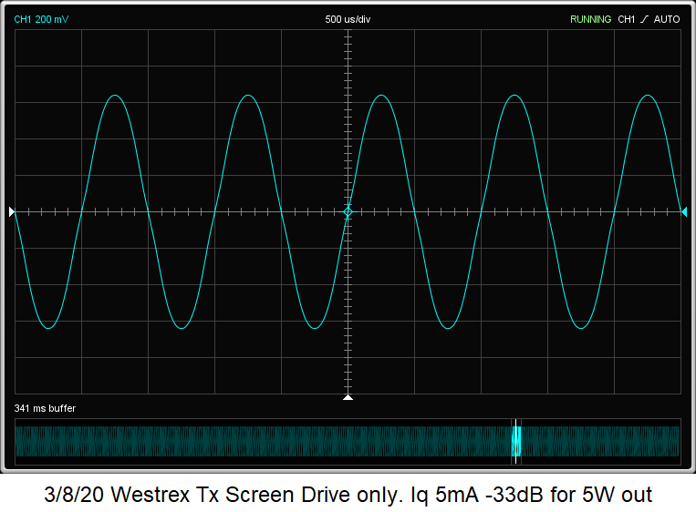

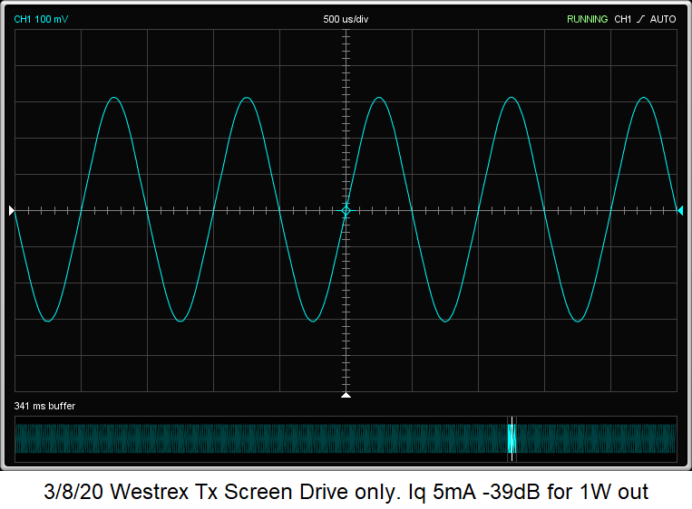

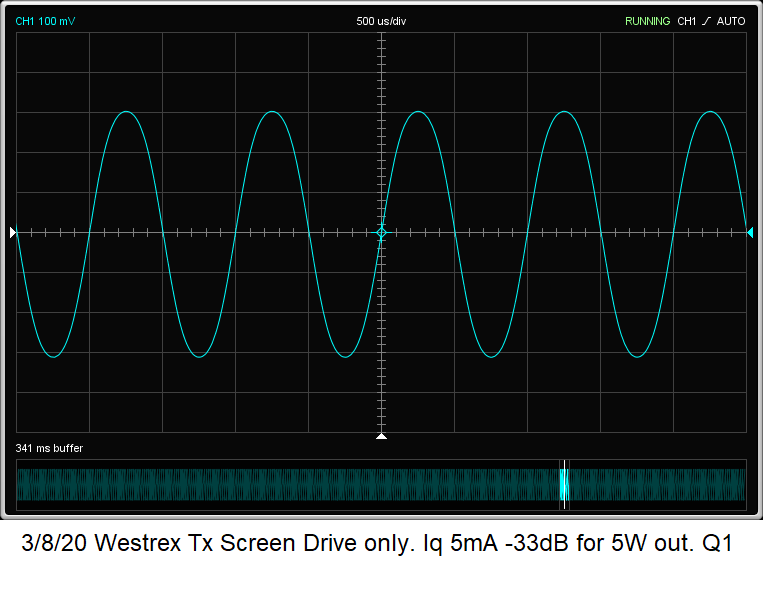

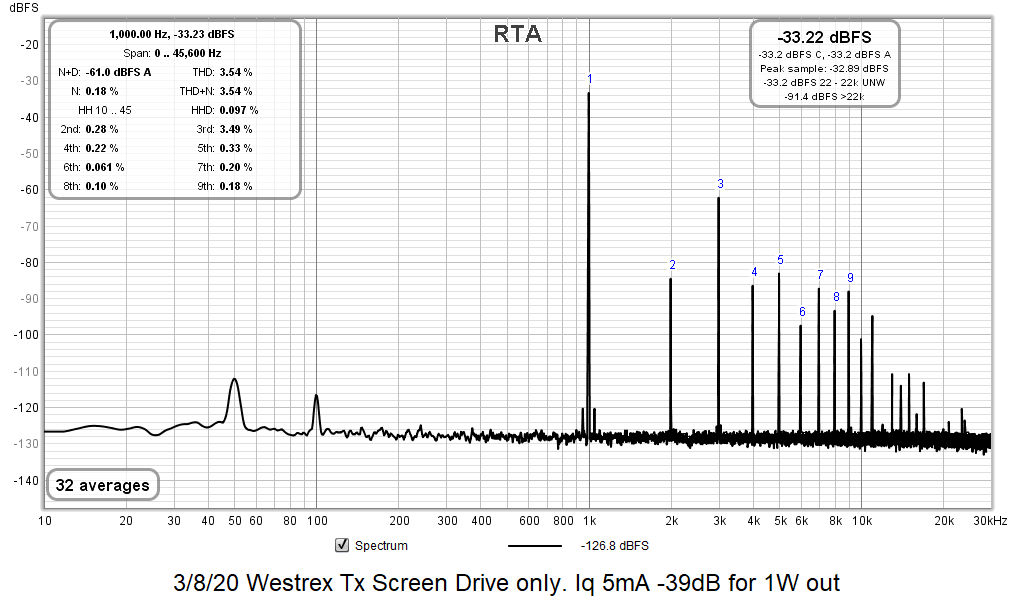

I removed the Rg2g1 resistors. Plots below are:
  • 1W scope
  • 1W RTA
  • 5W scope
  • 5W RTA
  • 5W Q1 Source RTA
  • 5W Q1 Source RTA
Certainly better than the crazy drive but still not great.
Less gain of course. At 5W the MOSFET sources are swinging 32V RMS according to the metre on the soundcard interface.

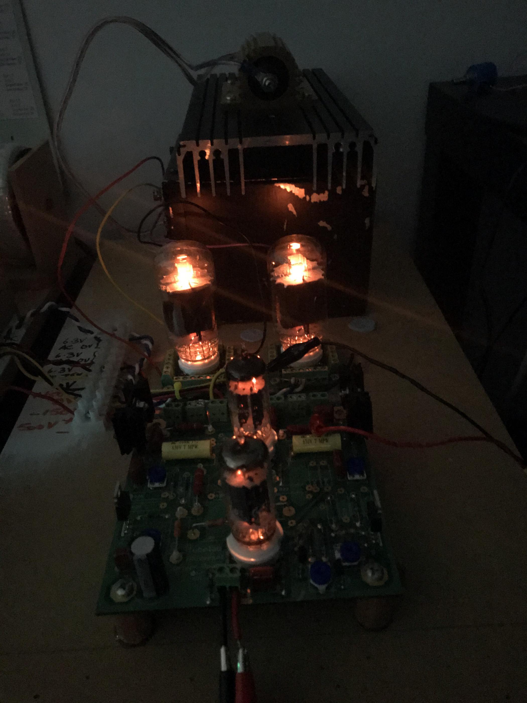

Finally, there's a picture of the test setup.

The 5W scope trace in post 219 looks a lot like gm doubling, I've seen similar looking sinewaves in simulations. Have a read of this tubecad post:

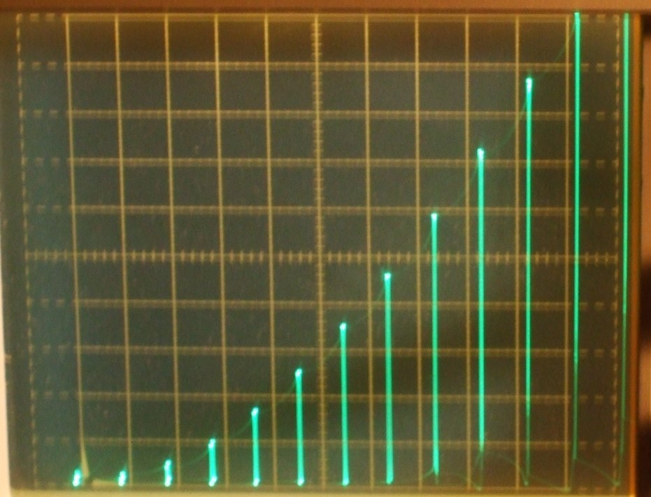

Matched resistors alone would not guarantee matched gains (depends on gm), but the tube plots you show look like they are well matched.
Trying to get low distortion without any N Fdbk also places heavy requirements on the OT used. The two P-P sides need to have equal winding resistance (and of course equal turns ratios). Adding a series resistance into one P-P winding side can be done to equalize the winding resistances.
Then there is distributed capacitance in the two winding sides. Generally that requires the use of split bobbin windings, with identical builds on each side. But one could maybe put a variable cap across one winding side and try to equalize the even Harmonic response. Or, maybe try to get equal winding resonance frequencies in isolation.
Another problem could be from the Rg2g1 resistors being non-linear at high voltages if they are thin film types. Can either use composition resistors and/or series equivalent resistors to reduce the voltage across each resistor.
The scope curves shown earlier look like plain old 2nd or 3rd H distortion is rampant. This may be some problem with the drive signals or splitting. Crossover distortion would show up as higher harmonics, especially with low signal levels.
Crazy drive reverts to just g1 drive at very low drive signal levels, since g1 is no longer current constrained (through Rg2g1). This means that optimum idle current should be much lower than normal g1 drive. It could be very touchy to set right though, and to maintain.
Below are some Vin to Iout curves done for 26LX6 (similar to 6HJ5) for high current range and low current range. You can see the reversion to a g1 drive shape at low signal levels. The crossover conduction overlap would only need to occur in the low current curved region.

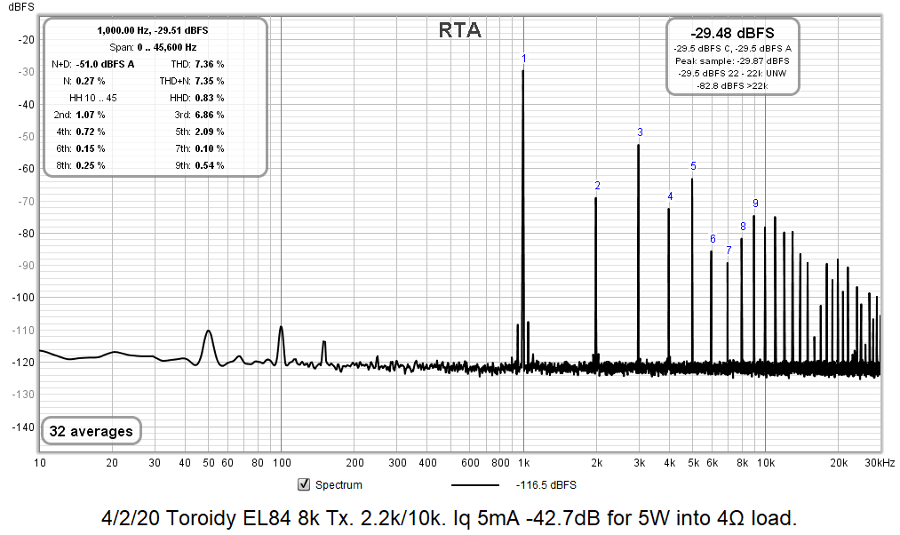

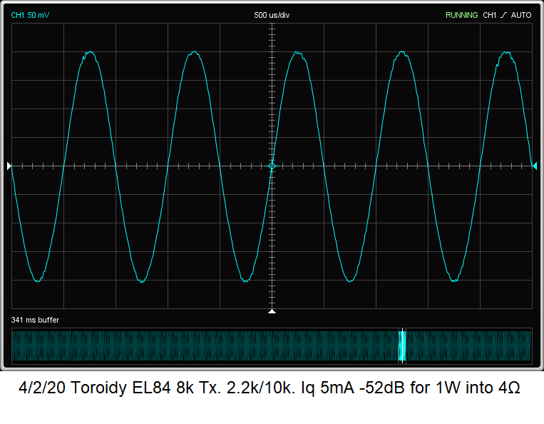

Toroidal OPT measurements

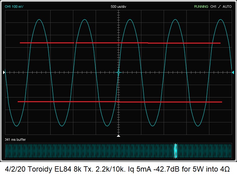

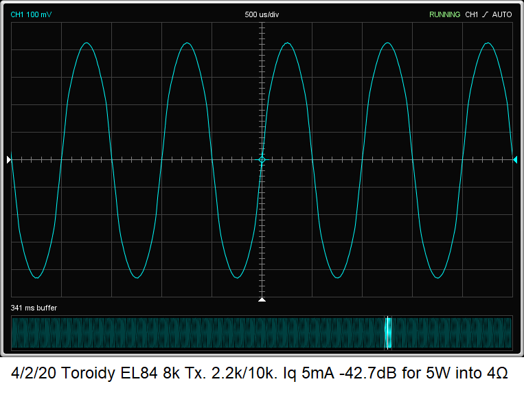

I tried an 8K EL84 OPT and attached a 4Ω load.
5W performance is worse than with the old Westrex OPT.
Based on an earlier observation I think there's evidence of gm doubling in the 5W scope shot.
Time to put finding the perfect output stage for my Universal Driver Boards on the back burner. Ultimate aim is around 100W to replace my existing 135W into 8Ω solid-state bass amp in my tri-amped system. Low output impedance/decent damping factor is important so crazy-drive probably wouldn't be appropriate anyway.
Other projects await....

I've noticed on your scope shots the slight bend in the sine wave as it passes thru a certain level. That is caused by the load change on the driver circuit as it is required to go from one grid to driving both, not your OPT.
Need to isolate the output stage into something simpler. With any NFB unhooked look at the output stage grid drive. Think you will find that is the origin of part of the problem.🙂
Used to be easy to see, this kind of circuit was transformer driven. A sampling resister could be put at the low end of the IT, a scope could indicate the grid current bump.
