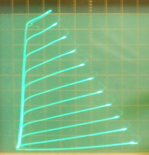

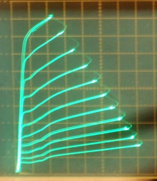

Somewhere, in some thread here, someone did a uTracer curve plot of a pentode for varying %UL. It was an eye opener. With higher %UL, the pentode knees drop lower and lower, with the plate curves curving up progressively more like triode curves. It is a smooth continuous transformation, with no sign of some "optimum" %UL. Really just showing the continuous variation of effective Mu between the screen grid triode case and the pentode case (being a very high Mu triode with a truncated/left-shifted origin, due to screen current absorption).
All % UL cases are actually using non-linear triode N Fdbk (even up to the pentode case theoretically). However, pentodes typically are operated with a low Z primary OT for max power at low B+, and do not make effective use of their high Rp plate N Fdbk.
I think the "optimum" %UL found historically may just be for a specific primary Z and specific tube. If one goes to higher %UL using those curves, then the optimum primary Z would increase and higher B+ would be needed to get the same power (as usual for triodes). Specific tubes of course have max B+ limits, so this can not be carried out indefinitely in practice.
The LV amplifier linked appears to use plate to driver cathode "local" N Fdbk.
This puts a lot more gain in the "local" loop, so will certainly reduce distortion effectively. And it allows the output tube(s) to keep functioning at max capability (grid 2 voltage held constant). Stability with all that loop gain may be an issue.
The most unique non-linear compensation by far occurs in Crazy or Twin drive for pentodes. And it is not even N Fdbk, but feed forward instead. It works well beyond all reasonable expectation. Example below: (1st pic normal grid1 drive, 2nd pic Twin/Crazy drive, same 26DQ5 for both pics)
So, I was wrong when stated that the best UL ratio is zero. It appeared from your tests, there is an optimum, and it is in even negative UL ratio. ;-)
I suppose one -could- look at it that way!
Except there is a resistor with I to V conversion for grid1 involved as well. Maybe one could even make a case for the grid1 current causing a voltage feedback at grid1 (rather than a feed-forward scenario). Looks more like negative Fdbk then however. Well, Crazy it is.
Anatoly, your suggestion would seem to call for an experiment. Use the positive going UL tap with a resistor to grid 1. Grid2 still being driven. (assumes the output is linear with the input, to generate the same conditions as Crazy/Twin drive would.)

re: post 31 experiment:
That would make it load sensitive however. More loading would mean less grid1 drive. So that will have a higher output Z than the Crazy/Twin case.
What is needed is something to lower the output Z for Crazy/Twin drive. (Well, conventional "Schade" output plate to driver plate N Fdbk would still do that.)
What's the point in driving G1 from secondary, when anyway power needed to drive G2 is higher? And are you sure that V/I conversion is needed? Did you try to drive both grids from different followers, with different signal levels?
Yes, driving grid2 from the positive Fdbk UL tap would make better sense. (since output is assumed linear with input for Crazy/Twin drive) Then only low level signal would be needed for grid 1. Driving grid1 thru a resistor would seem somewhat flimsy for control though, probably extremely high Z output that way. It might even latch up, with grid1 unable to turn it off! Maybe no choice but to use V drive for grid1 that way. I suppose one could try putting the resistor over in the grid2 to (opposite) UL link.
The idea of driving grid1 and grid2 with different scaled V drives (something like the g2/g1 mu ratio) has been discussed before. And George (Tubelab) has done some experiments, maybe others too. No doubt works, but how linear?
I think the resistor network for grid 1 (in the positive region in Crazy/Twin ) is necessary though for the near miraculous linearization seen in Crazy/Twin drive. (likely related to the SQRT function involved in grid current interception and the 3/2 and 2.0 power laws for grid 2 versus grid 1. )
