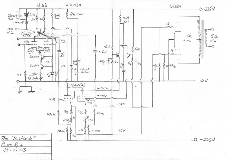

The Corrected Version
Another check revealed another important error😱
So this time, I have corrected the 1N4148 error and also included the 100k 5W resistor without which the Zener and 1N4148 would have quickly become toast!
Sorry for the chaos
7N7

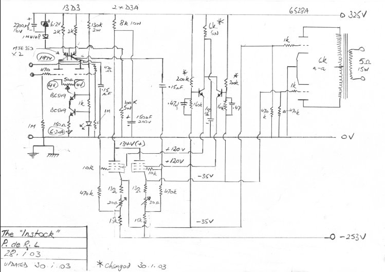

Another update
A couple of changes to mention:
First, the 4.7k 5W suppling the D3A G2 board is now 6k @ 5W
The potential dividers feeding the two MPSA42 transistors have been changed; the top resistor in each one is now 200k
Vg2 on the D3As is now 120V. The load resistors have been changed also: the 100k parallel resistors have been removed leaving just the 15ks
This bloody computer is having one of its go-slows this evening (5 minutes just to post this) so I'll re-send the diagram when it starts behaving again😡
7N7
Updated Diagram
Here as promised, is the updated circuit diagram for the Instock amplifier.
I have marked most of the changed components with an asterisk.
The principal effect of this is that Vg2 on the D3As is now 120V - note also that the cathode loads are now 15k instead of 13k as previously (forgot to mark these!😱 )
7N7
