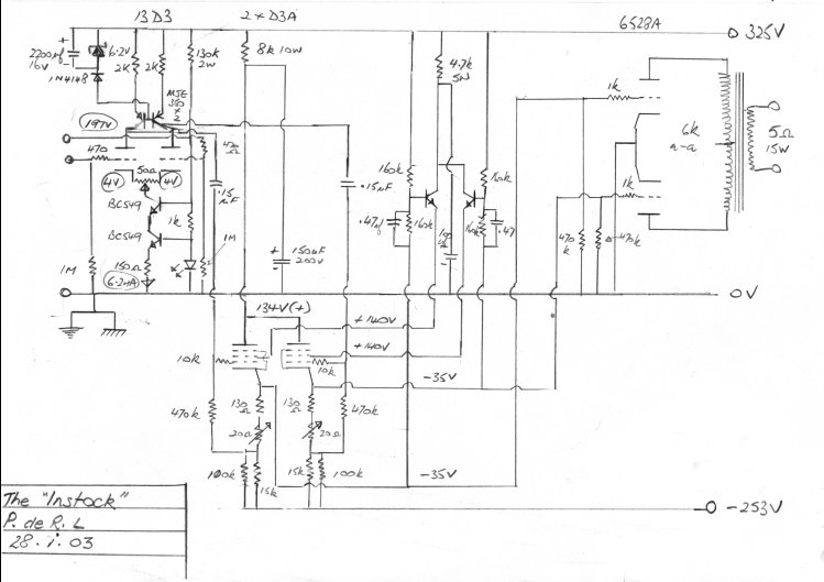

The "Instock" Amplifier
I have settled for 6k a-a; this seems to give the best compromise between higher order distortion and THD - 8k was worse for higher orders.
Here's the diagram; sorry about the quality - life's too short to learn drawing packages.
Briefly, the 50 ohm pot at the bottom of the 13D3 allows me to balance the valve sections at DC. As can be seen, the (red) LED is biased from the HT supply via the 130k resistor. The bias voltage (4V) is high enough to ensure that there are no problems when driven hard.
Turning to the D3A pentode cathode followers, g2s are supplied via the emitter followers (they are MPSA42s). The base voltage is supplied by the potential dividers; the lower halves of these are bypassed with the 0.47uF caps; these fit the little board and anyway give a -3dB point of about 3.5Hz. The 20 ohm pots provide bias adjustment for the output stage.
The amplifier will deliver over 15W, with an input of +7dB (1.7v rms) but distortion is quite high at these levels; personally, I blame the output transformer which is very old and probably wasn't very good when it was new. I am delighted at the very low levels of high order (4th and above) harmonics. And it does sound really very good.
I have not drawn the power supply - easier to describe it.
A Tektronix transformer provides via two bridges, +325V and -253V. On the +ve side there are a 4uF input cap, a 20H choke and a 220uF cap. On the -ve side, a 68uF cap a 270 ohm resistor and a 220uF cap. As this is supposed to be experimental, I have not employed the usual refinements: bypassed diodes, RF chokes on the mains etc. However it is very quiet.
7N7

Splendid. Perhaps this will satisfy the circuit-hungry wolves who have been snapping at your heels.
What value of resistor goes from the bases of the 13D3 transistors to ground?
Thanks 7N7
Took me a little while to figure out what the wigly bits
on the anodes of the 13D3 was , until I rememberd you have both current source and - sink, I'm not so bright sometimes
Paul,
Looks very interesting. Not something for "valve only" people for sure!
The only "silly"I can spot presently is the 1n4148, which appears to be reversed.🙂
I really like the cathode followers DC coupled to the output valves.
Two months ago, when I suggested such a thing was a good idea, I was howled upon, and even pressed by 1 venerable member and 2 moderators (1 now defunct) to withdraw my comments.
Apparently "all" cathode followers are "rubbish".
But I don't think so.
