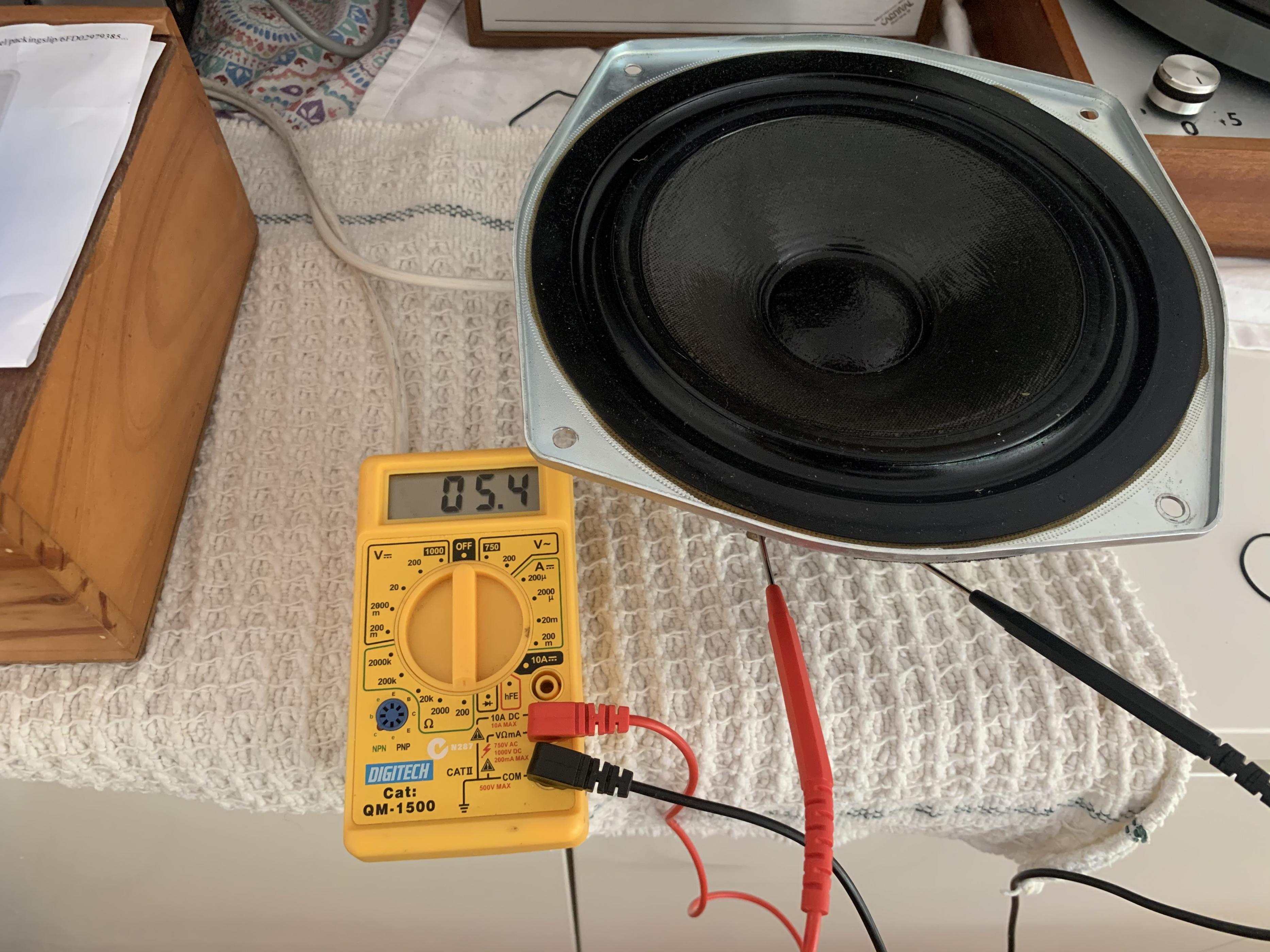

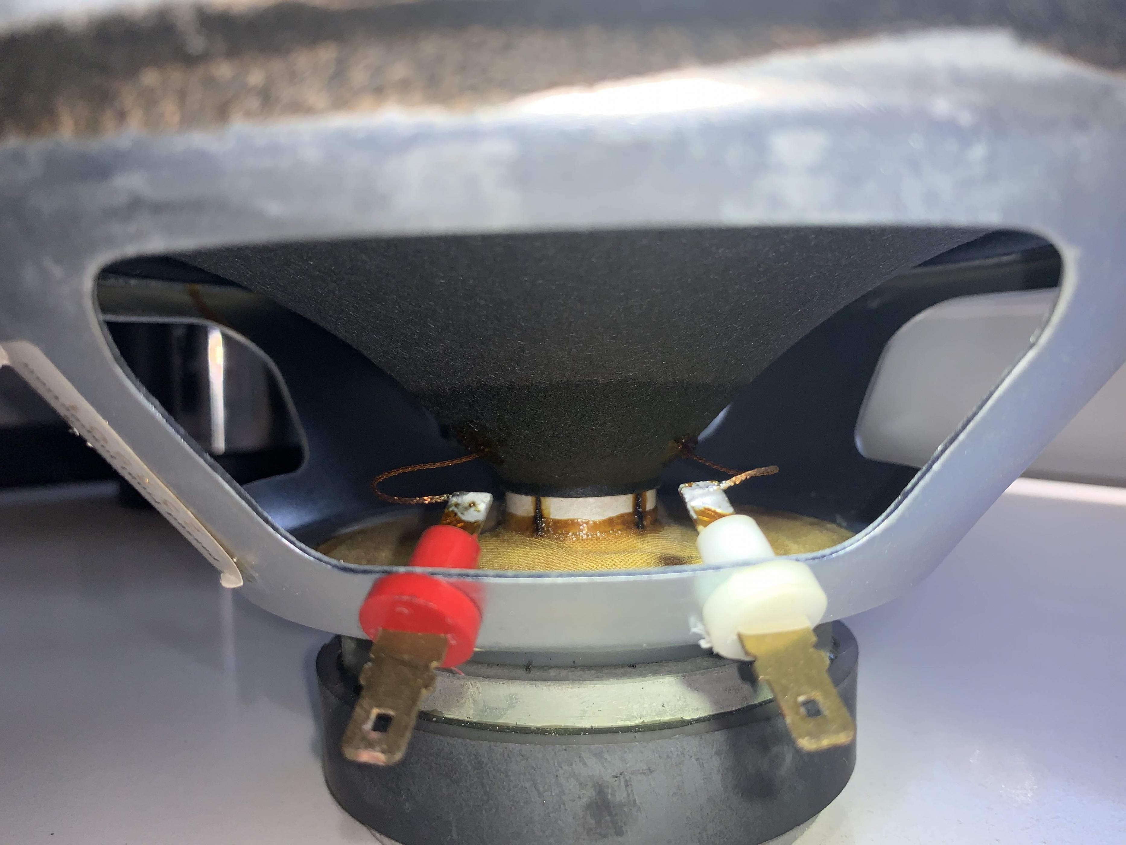

So I was enjoying these and getting ready to buy the new tweeters, when I noticed that the bass driver has stopped working on one of them.
The crossover I updated "looks" ok and was working for a week or so - but maybe I have introduced a short that has knackered the bass driver?
Testing with a DMM gives a decent reading (see attached). Disconnected from the crossover, and connected directly to a small amp, the driver reproduces the music I put into it, perfectly audibly but only very quietly and only high frequencies. There is no visible or physical cone movement.
There is plenty of advice on the web, but it all seems to say "if your DC impedance is good, the driver is good".
One thing I have not tried is this same test on the other working speaker, simply because the drivers are hard solders to the crossover wires and it's a real pain to work on. I have updated the broken one to new internal wire and removable lugs deliberartely as part of this investigation. But I have done the obvious (to me) things like try different amps and both L&R outputs of each amp etc.
