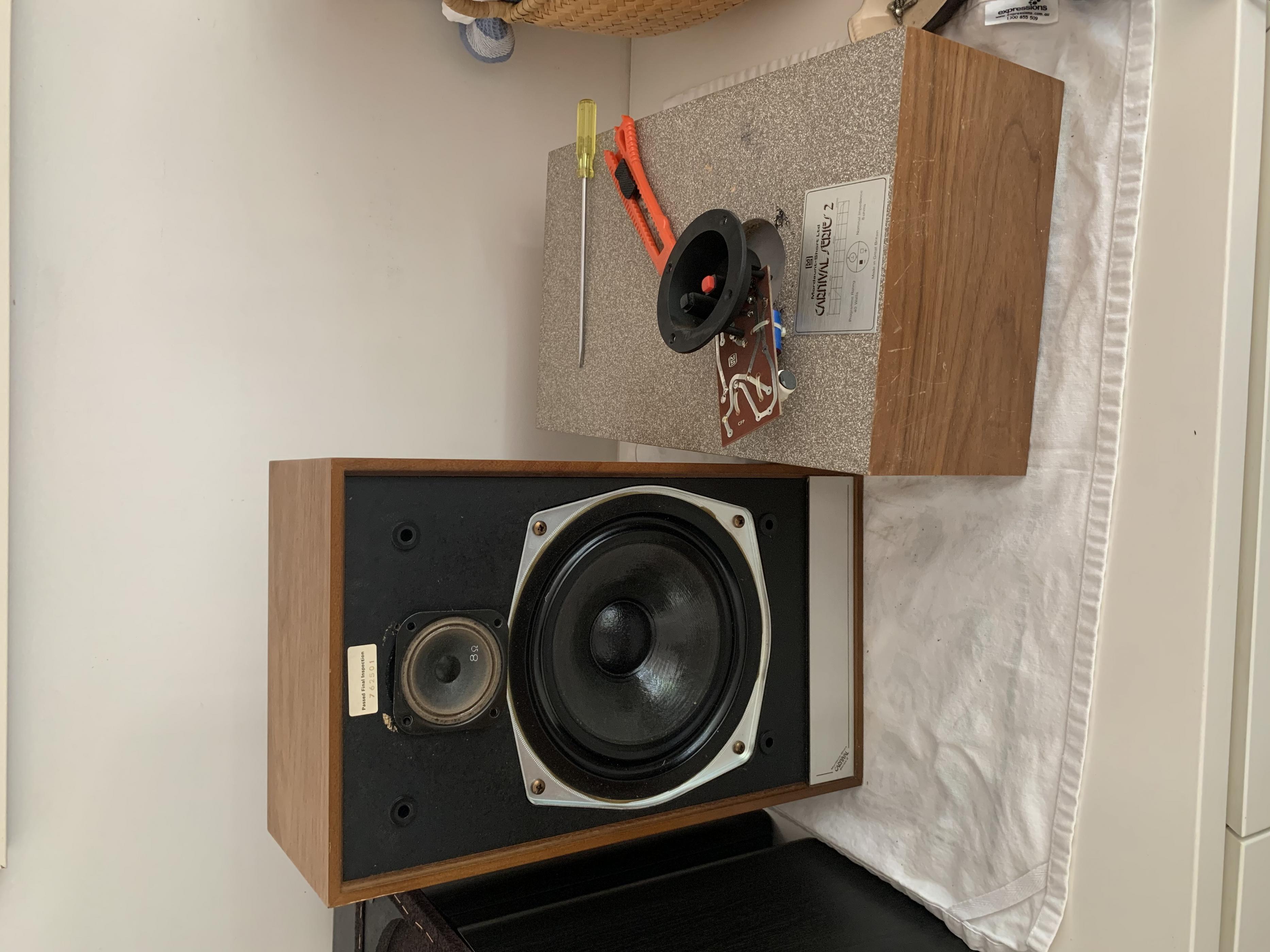

Hi all,
I am looking for some help and advice on these speakers. They are "working" and I'm confident the main drivers are in good shape but the sound is quite dull, especially from older music / vinyl that doesn't have that crisp electonically-enhanced high end. They also seem to need a lot of power to drive them - possibly to push the tweeters to produce sound and thus overcooking the rest. So I feel the crossovers and tweeters may need some attention - see attached images...
Crossover:
Considering this is a 43-year old circuit, I presume it's worth going ahead and replacing the 2 caps and 1 resistor? There is no visible damage to the caps... But what should I replace with (let's say total budget under $40 AUD)?
Yellow / Violet / GreenCap
4.7 uF ±2% (min:4.61, max:4.79 uF) 500V
Replace with? ECWF2W475JA | Panasonic | Polypropylene Film Capacitors | RS
Black Cap
10uF 50V
Replace with? Soundlabs Group 10uF 50V Mundorf Bipolar Audio Cap
Resistor - Appears to be 6R8 - Replace with ???
Tweeter:
Not sure if this is the original unit. It looks pretty well made, and is mounted on a solid basket. but has no markings other than "8 Ohm" stamped on the outside cone. I can't find any pics online of any examples of this marking (or the crossovers) online!?!?!
The units are pretty dusty / crusty and when I tap them, they give off a bit of a crackly sound, like they are dried out. Should these be replaced or can they potentially be cleaned / restored / moisturised? I am not familiar with tweeter restoration at all!
Thanks in advance,
lhalha

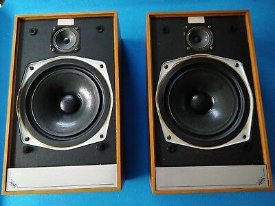

The tweeters look original (see attachment).
The only crossover component in urgent need of replacement is the 10uF ELCAP NP electrolytic - these do not age well! Replace with a good quality electrolytic.

lhalha, the tweeters need electrical checking with an ohm meter (DMM), and mechanical checking by gently pushing on the cone (two fingers) and listening/feeling for any scraping which means tweeter replacement is required.
Jaycar have suitable 10uF 100V Electrolytic Crossover Capacitor to replace the original ELCAP electros.
The Polycarbonate cap could be replaced with a modern polypropylene perhaps...Jaycar have these too.
These speakers were never bright or lively but with capacitors type and value selection you may be able to brighten them somewhat.
Dan.
Edit: 50V rating is plenty for these speakers.

The original tweeters are Peerless units - read about them here:
McIntosh Drivers--Tweeters
Tweeter: The units are pretty dusty / crusty and when I tap them, they give off a bit of a crackly sound.
According to the link I supplied, the Peerless tweeter has a very lightweight cone/voice coil assembly and doesn't even have a spider to centre the voice coil.
So, after all these years, it is not surprising that the voice coil should be scraping in the magnetic gap, accounting for the 'crackling' sound you have heard!
