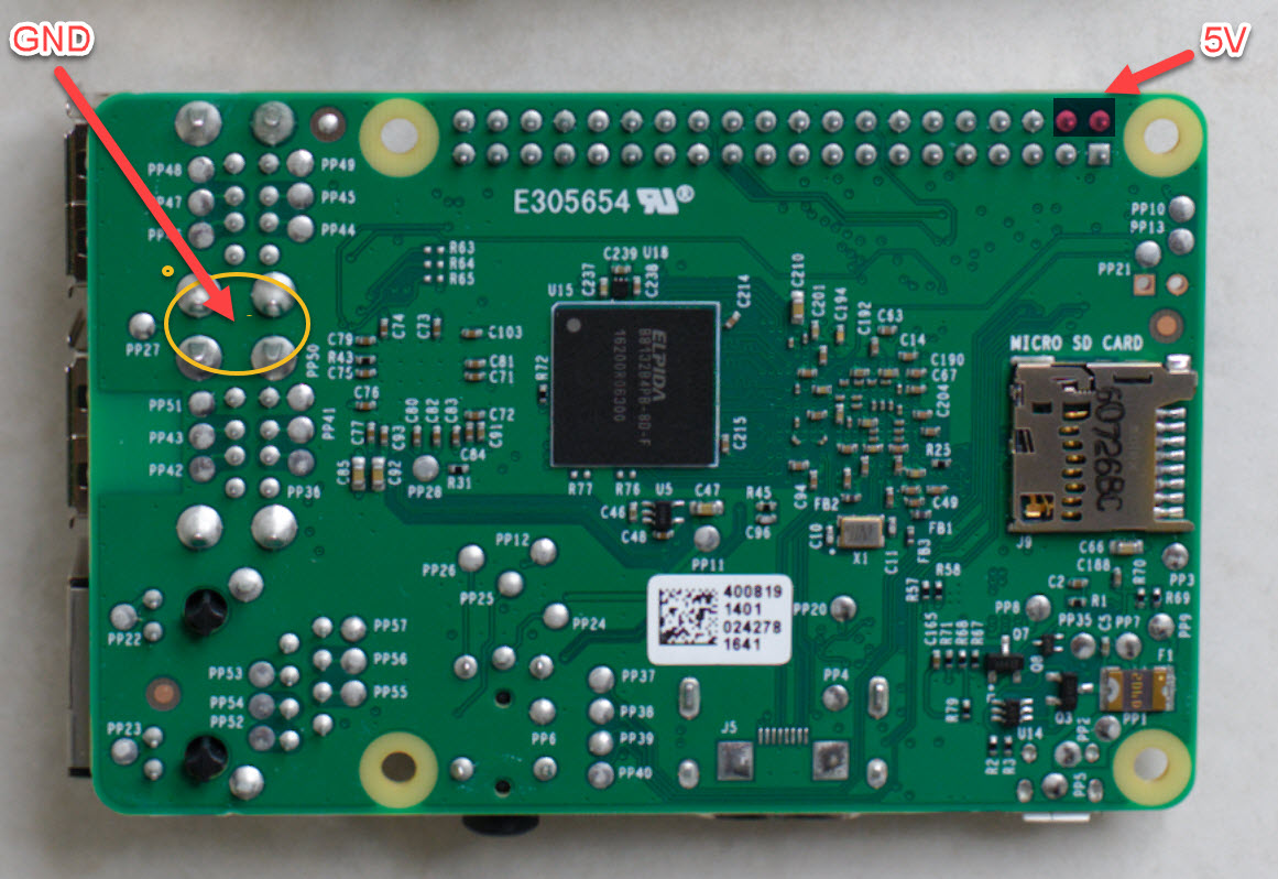

2) Direct power soldering on Raspberry Pi
I hate this micro-USB power connector of the Pi, so I soldered my Sbooster direct on the back of the Pi. Wow … sounds better and so far I never had a flashing red power LED again on the Pi. Try it, it’s only “a 35 Euro risk”
Regards Tom

You don’t need to solder + can just plug onto the GND/5V posts. I rarely have a USB feed into a box, preferring to use switch or other transformers, hard wired and just crimp/solder a connector on to some 18AWG cable.

Nice looking case! Q's... do you power your SSD directly from the Pi USB port? Any problems running under the USB 2.0 rather than 3.0?
